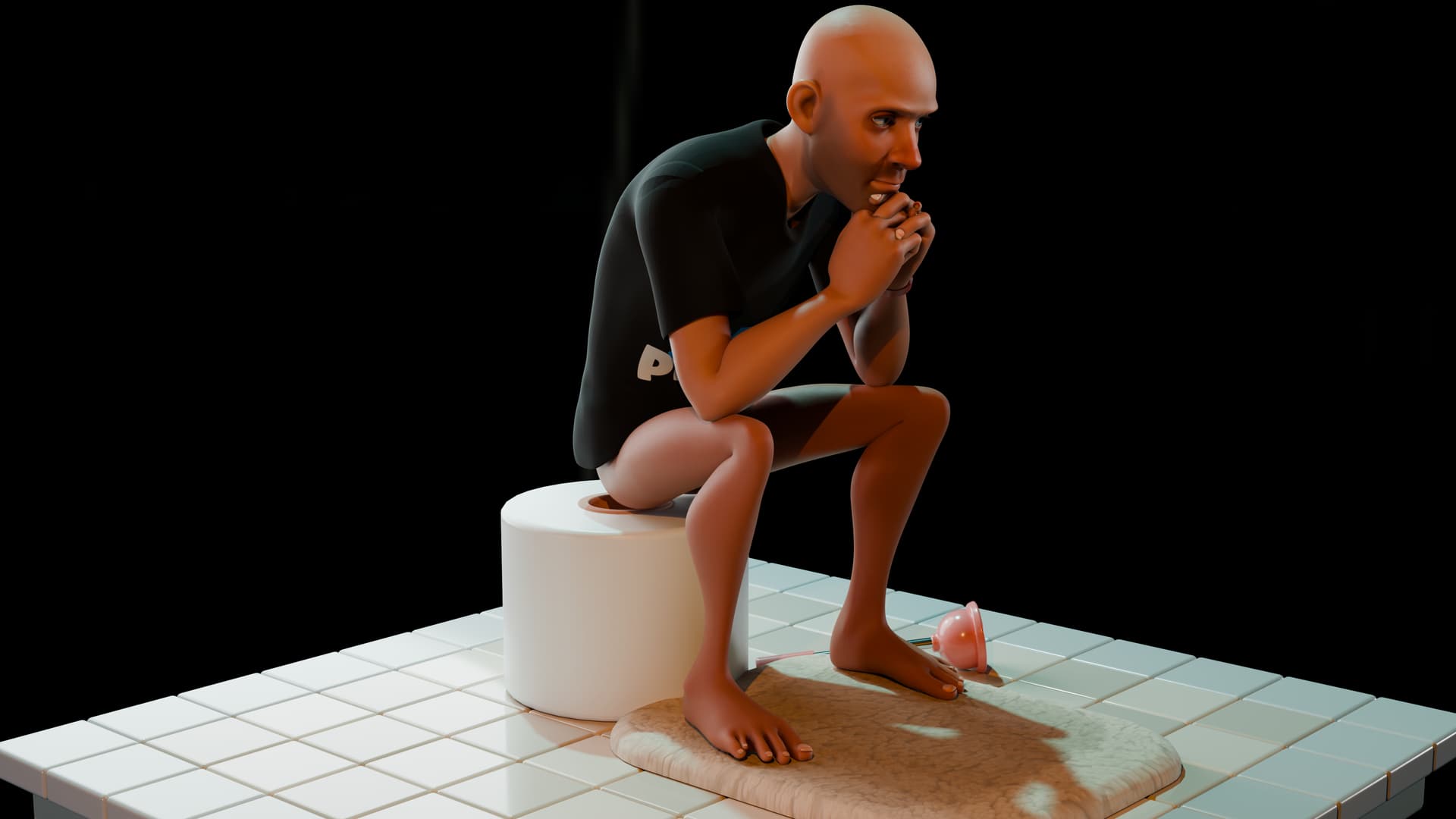

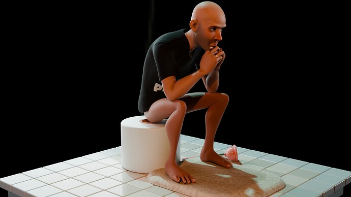

4th toe and ring fingers bugged
You can see by my example the toe issues, same thing is happening with the ring fingers. This image depicts my frustration at cc5 to date! Also the reflection shader is bugged in iClone and CC5.

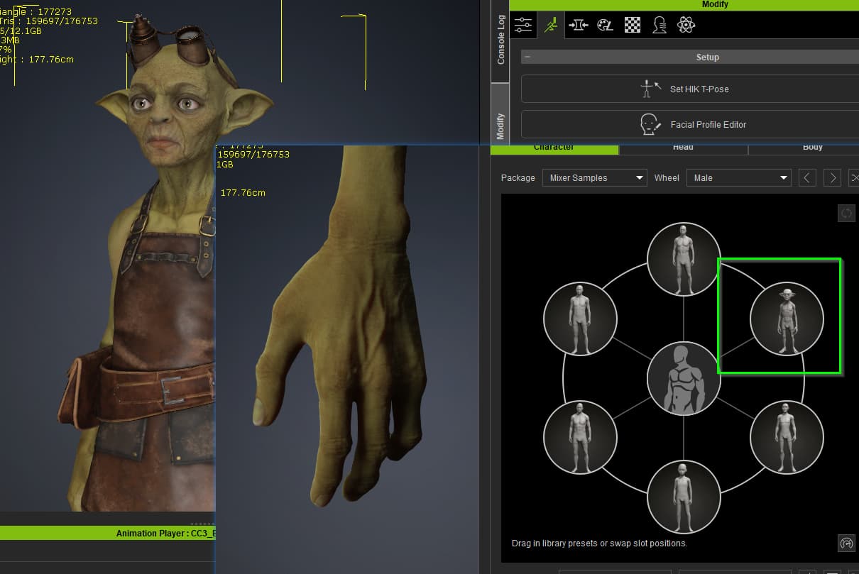

Hi,
May I ask if this character was created using ActorMIXER?
According to the current asset design, this character only has four fingers, and we used bones to scale them. Sorry for the confusion.
Also, could you describe the reflection shader bug in more detail?
OK I can see why the fingers are messed up thanks. I did add that avatar to the Actor Mixer!

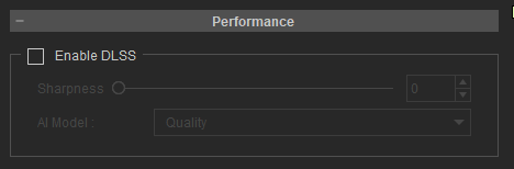

For now, please use the workaround as a temporary solution to avoid this issue:
Turn off Preference > DLSS first, the viewport will not go black and not crash.
I hope this info can help you.
