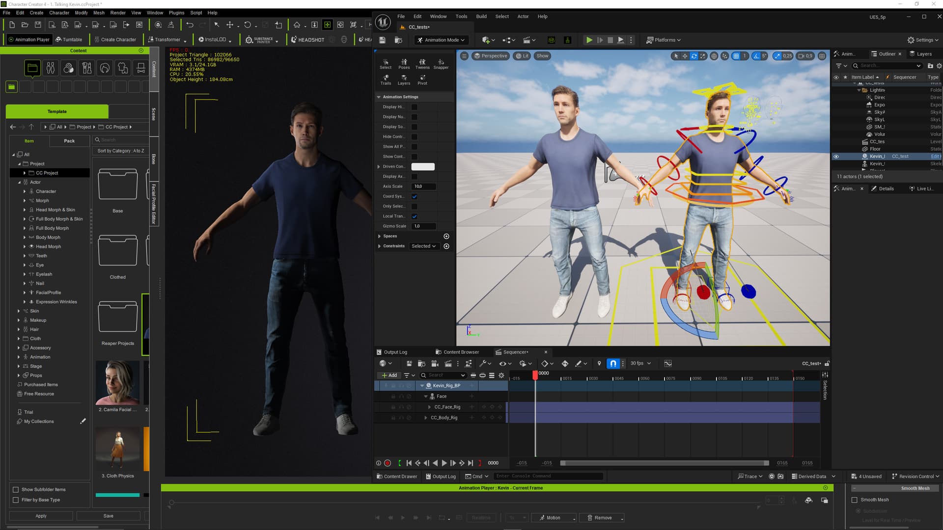

Here’s my tutorial on a step by step guide on working with the transfer option for the Unreal Live Link.

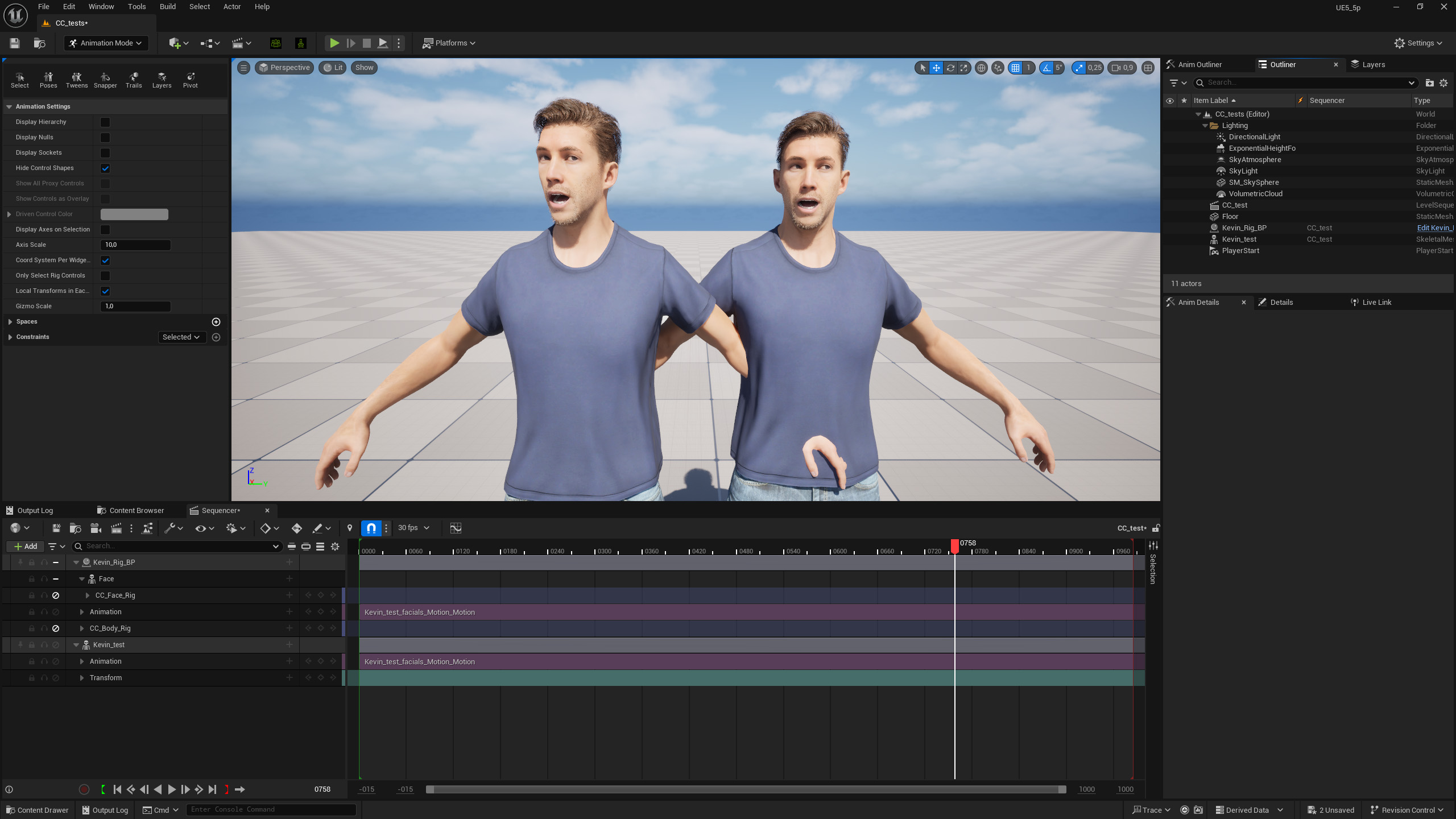

Anyone having issues with texture not loading properly when reopening a project and then manually click on every textures to make it work ? This is happening after I switch to 5.5, here is a screenshot below and the character is from CC4 with auto setup applied.

Is 5.5 broken on facial expression ? I am having this weird jaw bug in UE after importing the model inside UE

It’s all messed up, it seems. I’ve also tried to follow the ‘updated workflow’ (which says to first import the character without animation, then import animation later):
But its same result. The character’s skin is sort of bright pink in the skeletal meshwindow. Then it looks ok in the scene, but if you add facial animation, there are weird white splotches across the face.
I’ve replicated this, so it’s definitely a bug. Weird. Seems to only happen once you add a morph (using the morph editor) in character creator, then you export that character as an FBX, then import into unreal 5.5.1
No problem here with the latest update, do you have a screenshot to see what is happening ?
UE5.5.1 :

I think I must be doing something wrong. It’s specifically happening only when i:
  • use neutral base
  • Add new full body morph
  • Add a “emote” motion so the face is animated
  • Export FBX
  • Import into unreal (with 5.5 auto setup)
  • create a sequence and add the animation
I make a video of what I’m seeing when I can

This is a new video I created with CC 4, iClone 8, and Unreal Engine 5.5.
