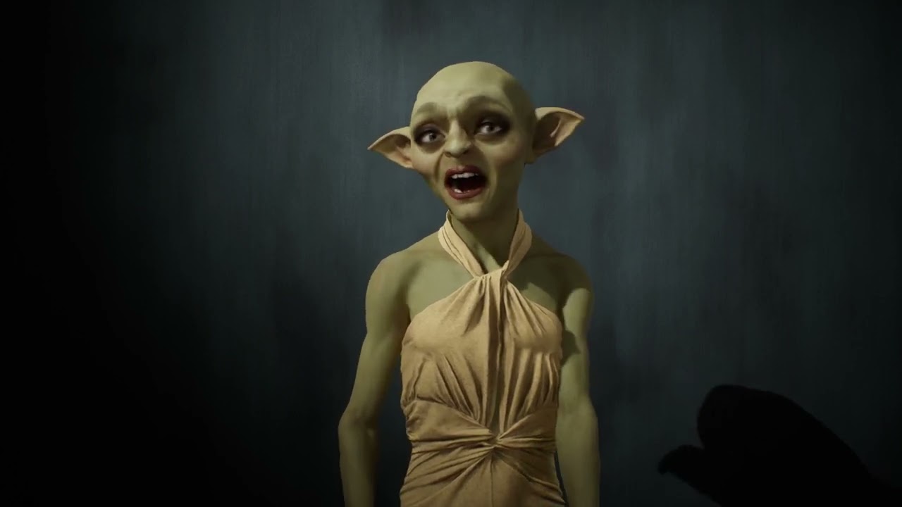

the dude at the end looked hideous omg
hahahah thx

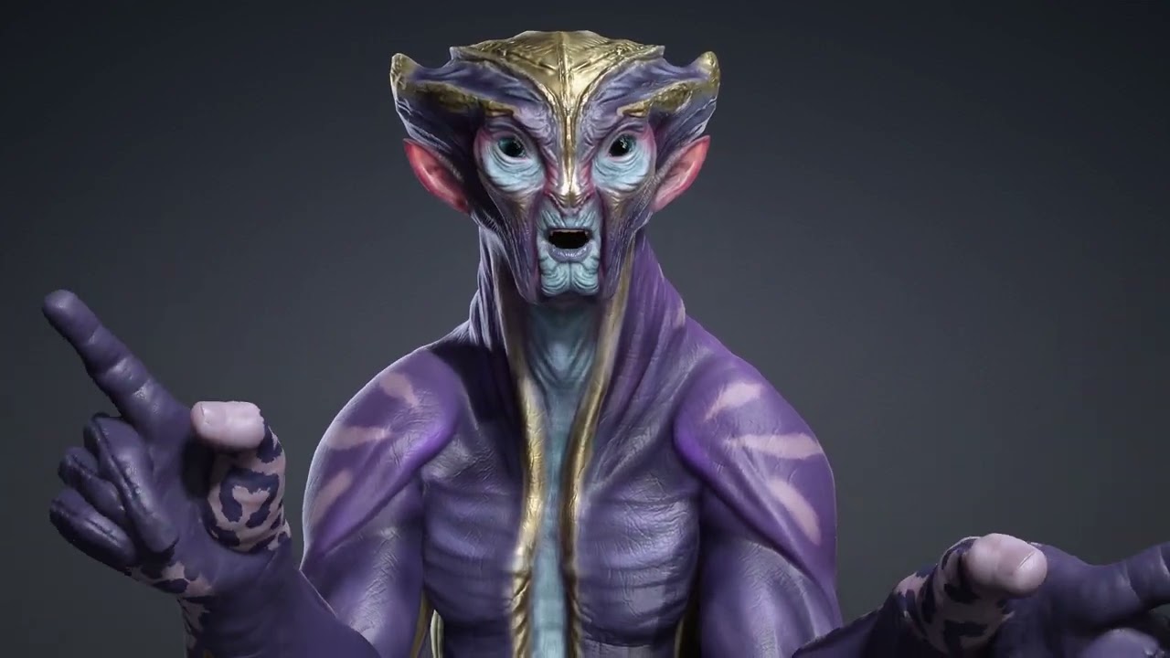

I often use “audio only” , especially for creatures.

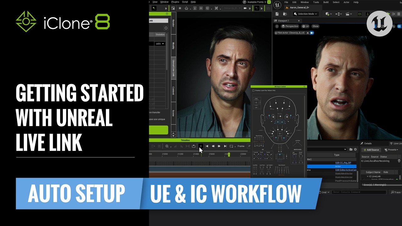

Hello guys, the new auto setup (all-in-one) for UE 5.7 has been released, please take a look here, have a good day! :grinning:
