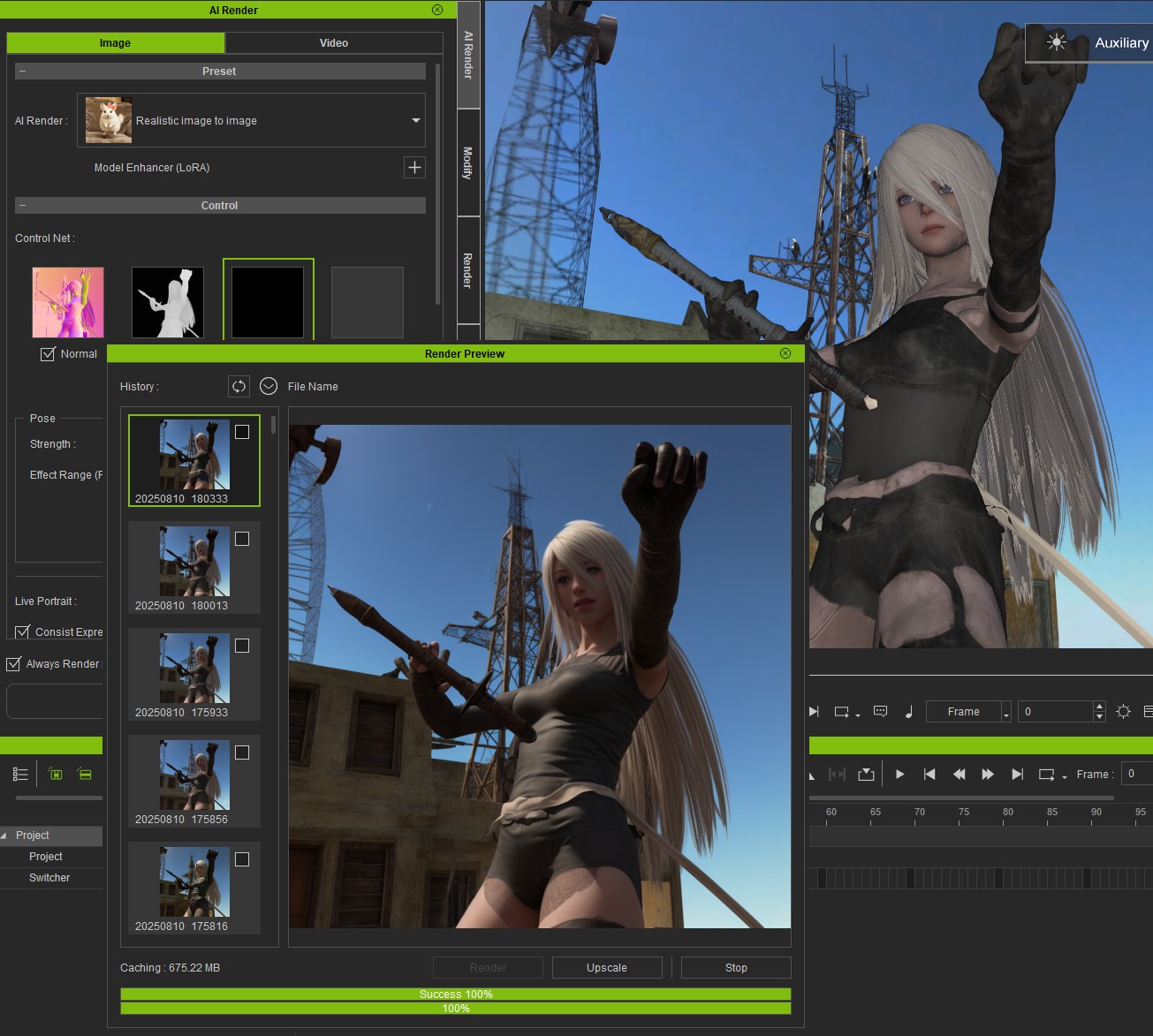

iClone render result:
iClone AI render result:
In AI render result, the actor motion did not follow the actor original motion and looks like the iclone camera moving action also did not followed in AI render result.

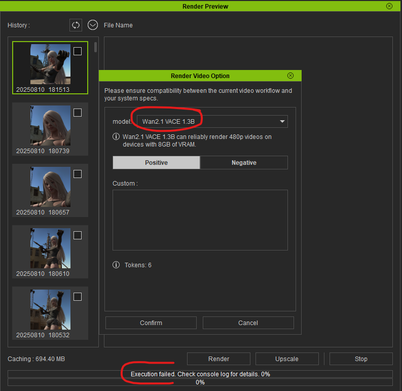

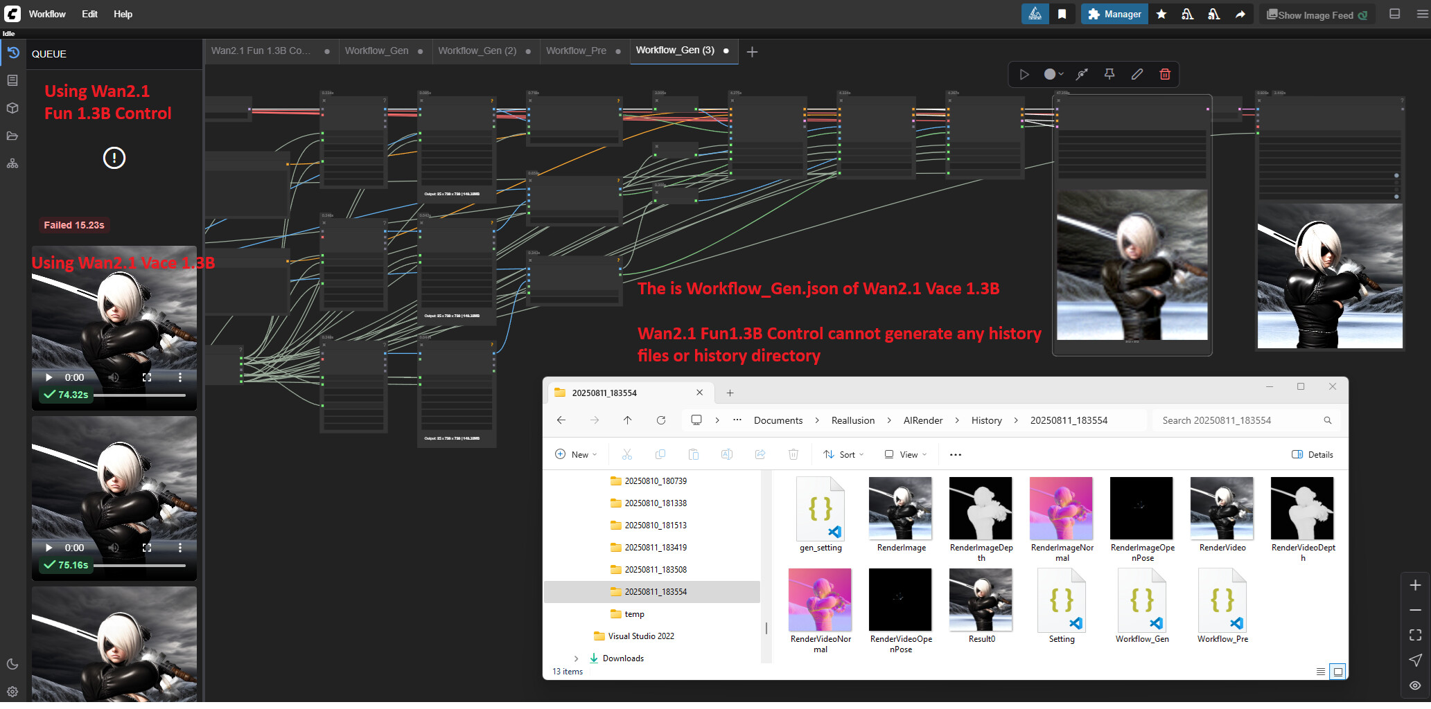

When using AI rendering video, the “Wan2.1 Fun 1.3B Control” always render with error. The “Wan2.1 Vace 1.3B” can render video but with error messge “Executio failed”, but you can see in the ComfyUI, it is still rendering the video.
Below is imported Reallusion provided “img2img_Realistic_Photorealism_Image_Style.json” workflow into AI image rendering. It is working and the result is OK.

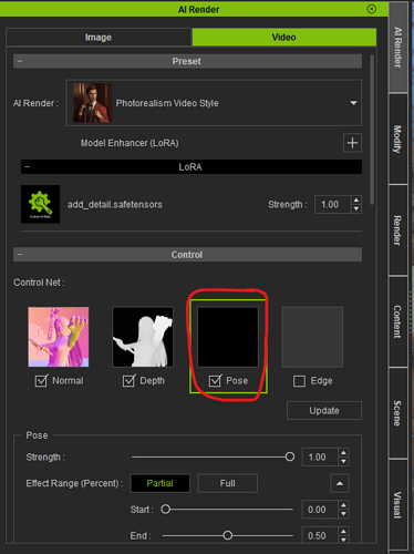

One more thing, the controlnet “Pose” sometime can work, but most of time cannot work. Do not know why. Maybe it is related to the image or characters.

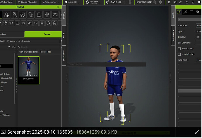

I just installed the AI Render on my laptop. As soon as I move my mouse over the UI it disappears. So I can’t connect to ComfyUI. Any idea why this may be?

Hi mecolef,
The reason OpenPose may not be functioning is that your character is of the Humanoid (non-standard) type. Support for Humanoid is currently under development.
Pose tracking currently supports CC Standard and ActorCore characters (only CC3+ characters include facial data).

For the Wan2.1 Fun 1.3B Control case, please go to your history folder, run the Workflow_Gen.json file in ComfyUI, and check whether it works. If it doesn’t, please share a screenshot of ComfyUI showing the issue.
For the Wan2.1 Vace 1.3B case, it appears the process failed on the iClone / Character Creator side but continued running in ComfyUI. We will investigate this case as soon as possible.

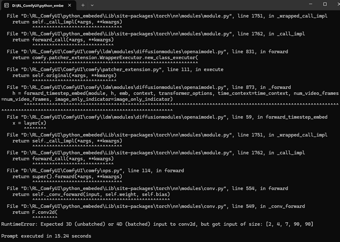

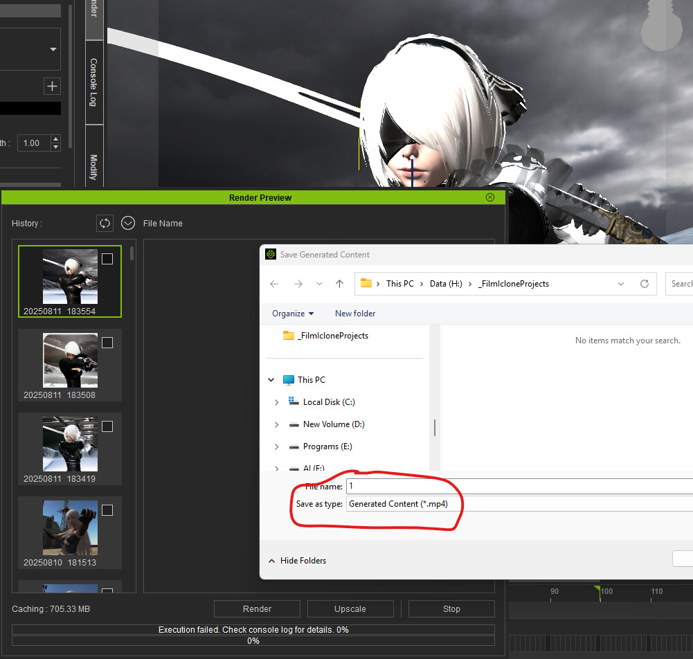

Another bug, when rendering a video, it always shows a file saving dialog for saving the video, but it cannot save the video even you type in correct path.

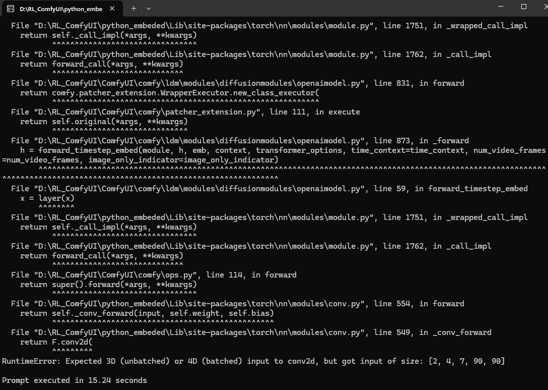

When using “wan2.1 Fun 1.3B Control”, the ComfyUI terminal will below error message:
and cannot generate the history. See below.

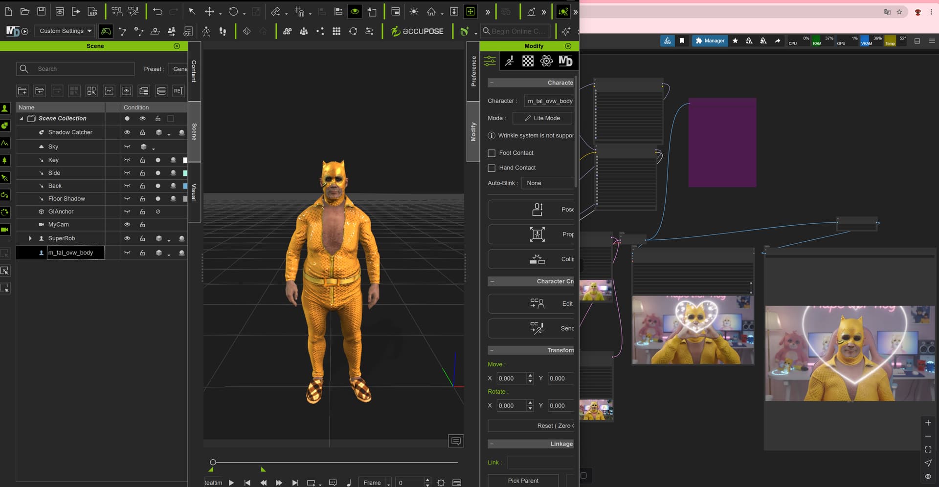

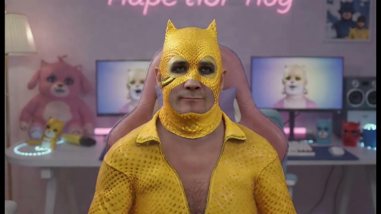

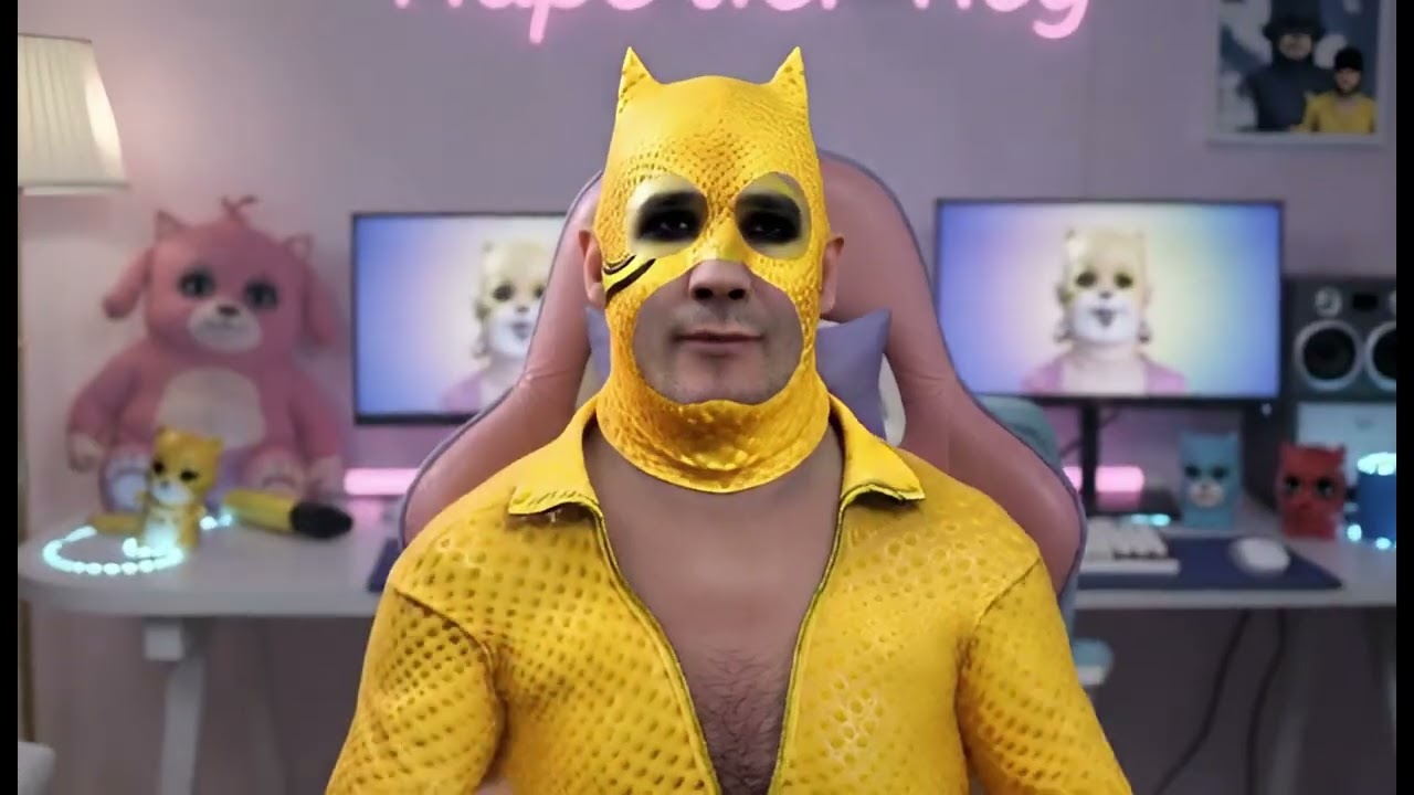

Testing Wan2.2 Fun Model, trained on iClone “SuperRob”.
SuperRob in his cosy Influencer-room. :joy:
Aug-11-2025 21-07-54
iClone Camera Tests in Comfy :

Hello, mecolef,
Thanks for reporting this issue.
I saw the error message you provided, and it appears to be related to the Python Torch library. Here are a few points I’d like to confirm:
  1. ComfyUI version – Are you using RL_ComfyUI or your own ComfyUI setup?
    If you are using RL_ComfyUI, please make sure the Torch and TorchVision versions are:
    • torch-2.7.1+cu128
    • torchvision-0.22.1+cu128
      These should be located in: RL_ComfyUI\python_embeded\Lib\site-packages
  2. Image resolution – What resolution are you using? Some workflows require specific sizes.
    We have tested 512×512 and 1280×720, and both worked well.
  3. Custom AI Render Tool – Did you create your own AI Render Tool that uses your custom workflow as image workflow and our template as video workflow?
    If so, the output image might be in an invalid format for our template’s video workflow.
  4. About save video – Do you mean the video is generated successfully in the history folder but not saved to the location you selected through the file dialog? Based on the issues above, it seems that the video generation workflow is currently not working properly on your case. If the video is not generated successfully through our workflow, it will not be found in either the history folder or the specified location.
If it’s convenient for you, please send me your history folder and project via a private message on the forum (click my profile photo, then use the Message button at the top-right).
