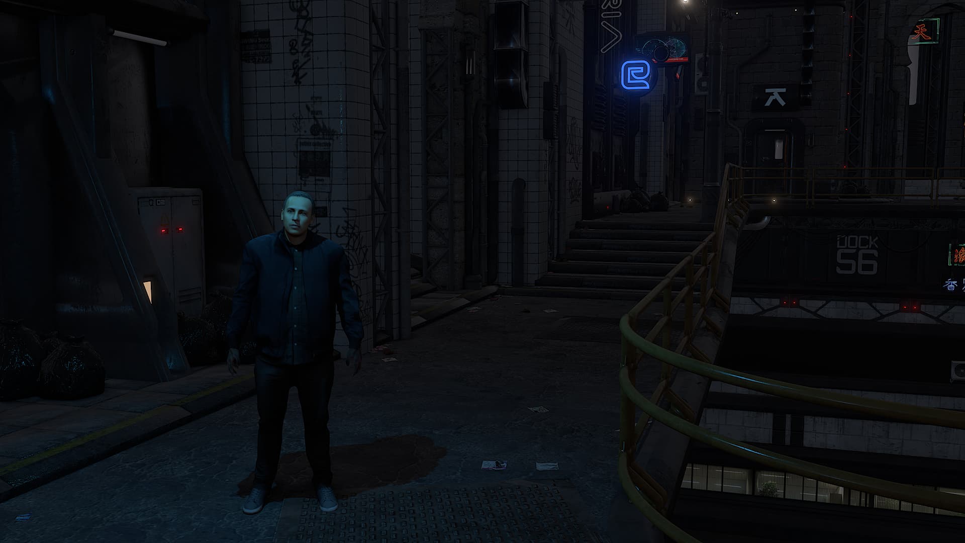

This took 9 days to render due to the city background.

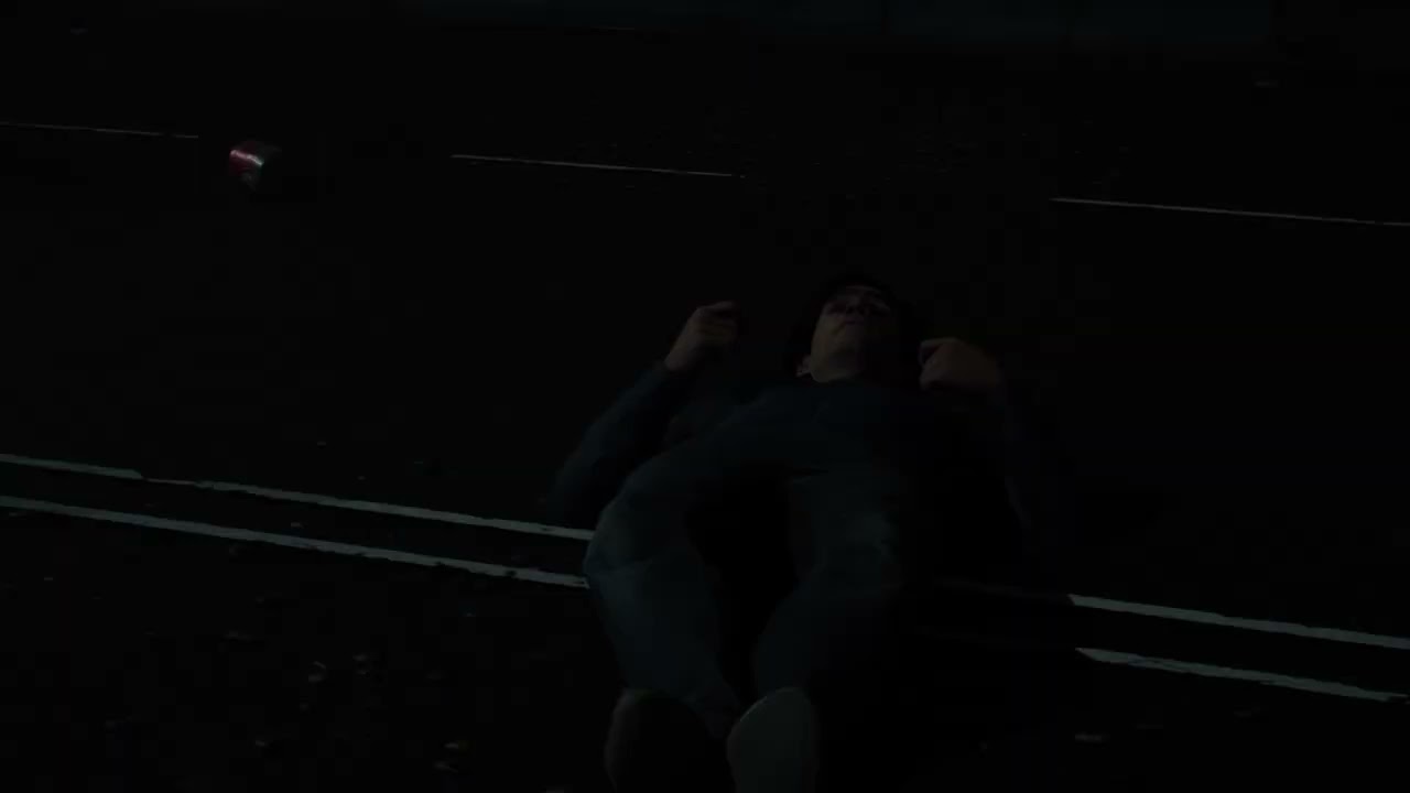

I realize this is a “night scene” but you really need some more fill lighting so we can actually see the characters
the whole thing is way too dark.
The dialog was pretty cool and interesting, as was the idea/story itself. I also liked the understated animation of the characters.
As @AutoDidact already mentioned, the render needs more light and there is too little contrast. Since most scenes don’t show a lot of details and are sometimes fairly grainy (plus there are some blocking artifacts which are probably due to YouTube compression), I’m not sure why it took 9 days to render this (presumably in Blender)—even if it was 4K: I figure, on average, 2 to 2.5 minutes per frame, which seems a little long for what ends up on the screen.
I sometimes have render times that are longer than that, but then there is usually a ton of details, or transparencies, reflection, refraction, etc. (or they are indoor scenes with lots of light sources). But maybe I should run a few tests with night scenes in a city. Perhaps the render time is reasonable after all…
Yeah. It has to be the icity 1.5 i used in blender to create the city; when i delete the city and its just the guys and fog it renders at 4000 samples in about 20 seconds per frame.
When the city is in the shot, it was rendering between 3 and 4 minutes per frame at 600 to 1200 samples. 60 frames a second.
Im on a 4080 super gpu 16gb vram, and icity 1.5 filled that up. I used the fog to cur down on the distance because i removed some blocks because it was just too intensive.
Its a sad trade off though… icity 1.5 is such a good add on to create the city… im just gonna need more vram or hope blender 4.5 vulkan speeds it up.

As animated filmmakers we should all be aware that when a Hollywood production films an “on location” shot in some back alley up here in New york city they definitely do not use the available lighting from the city street lamps etc.
They setup all kinds of ambient reflectors and fill lights so those highly paid actors can have their faces seen on screen.
Now unless there is some stories/plot narrative that requires partially obscuring characters in darkness, we should be doing the same,even if in the “real world” it would naturally be too dark to see peoples faces.

for that Dark car chase scene you could ha literally used perhaps two static city blocks from Daz and fliped/turned them for each camera cut and gotten enough “urban variety” in those shot.
Also I have no idea why you are rendering 4000 sample yet still getting horrible artifacts with the vehicle headlights glare.
Oh no no; 4000 is just what i tried without the icity and just the cars, fog and characters… the render city i dropped to 600 for the car driving parts and 1200 for the two guys. Otherwise it wouldve taken a lot longer to render.

I agree with simplifying the physical setup and improving the lighting. That’s a whole lot of processing for grainy, blocky results.

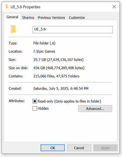

Having recently installed UE 5.6 simply to export motion data for use in iClone, I agree. The installation also took several hours and consumed more than 400 GB of storage space on my drive (probably due to the way the drive is set up and the fact that there seem to be numerous small files)

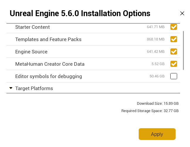

Hm, not sure where those numbers come from, but 400 GB sounds ridiculous.
The needed space for UE 5.6 is 33 GB, even if you add debugging and all platforms (Android/IOS/Linux/TVOS) it would be about 140 GB,
but these are not needed at all if you want to run UE for cinematics on PC.
I currently have 6 versions installed, UE4 versions about 25 GB, UE5 versions about 35 to 40 GB each…
Sure this takes some time to install, esp. when you don’t have fast internet speed.

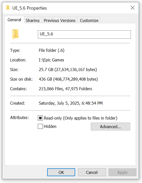

Sure, the “size” is 25.7 GB, but it takes up 436 GB on the drive (and that is what I was referring to). But perhaps Windows is just pulling my leg…
And, no, the time required was not due to low download speeds on my end.
