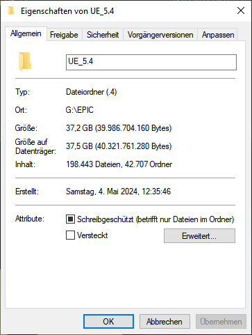

I have not installed 5.6 yet, currently still working with 5.4 as this pipeline works perfect for me,
but even “Size on disk/Größe auf Datenträger” makes nearly no difference on my side:
Ue 5.4
This applies to all versions, Size on disk a tiny bit bigger…

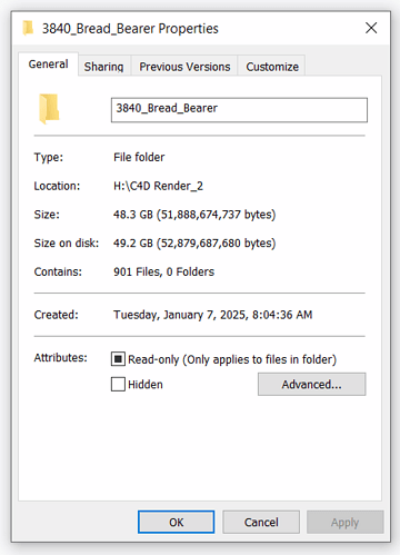

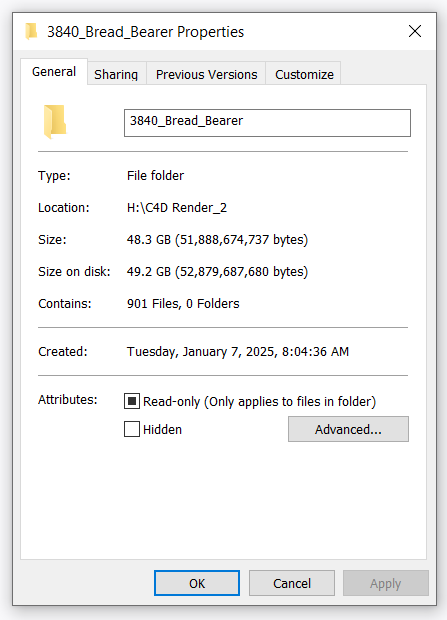

Yes, that depends on the size of the minimum addressable storage space on the disk. Let’s assume that has a size of 32 KB and Windows puts a 5 KB file in there, then the entire 32 KB will be taken up (for “Size on disk”). The smaller the minimum storage area, the smaller the “overhead” wasted. Now, this particular drive is an 8 TB (gross capacity) Sata SSD in an external USB enclosure. Normally, the files I deal with are not all that small (e.g. individual, rendered frames are between 40 and 75 MB each), so in most cases the “waste” is negligible (a few percent only).
Here is an example of a folder that contains 900 frames for a 30-second animation. The difference between size and size on disk is much smaller than in the UE 5.6 example (these are the same kind of SSDs).
But in the case of UE 5.6 with its 215K+ files, the average size of these files is probably quite small, but they each take up at least one of the minium storage areas (in other words, approx. 94% of the “Size on disk” is being “wasted”).
