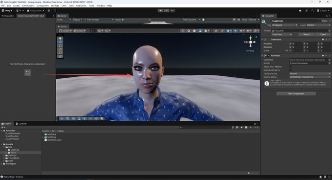

I tried to import CC5 Characters into Unity with the current version, but it doesnt seem to work. The facial animations look wrong. The eyeballs and eyelashes wont stay in the correct position. This didnt happen with CC4 characters
What are your export settings?
Certain settings, such as Convert Skinned Expressions to Morphs, cause major problems with animations, usually eyes drifting and popping out. Particularly with external animations from another character.

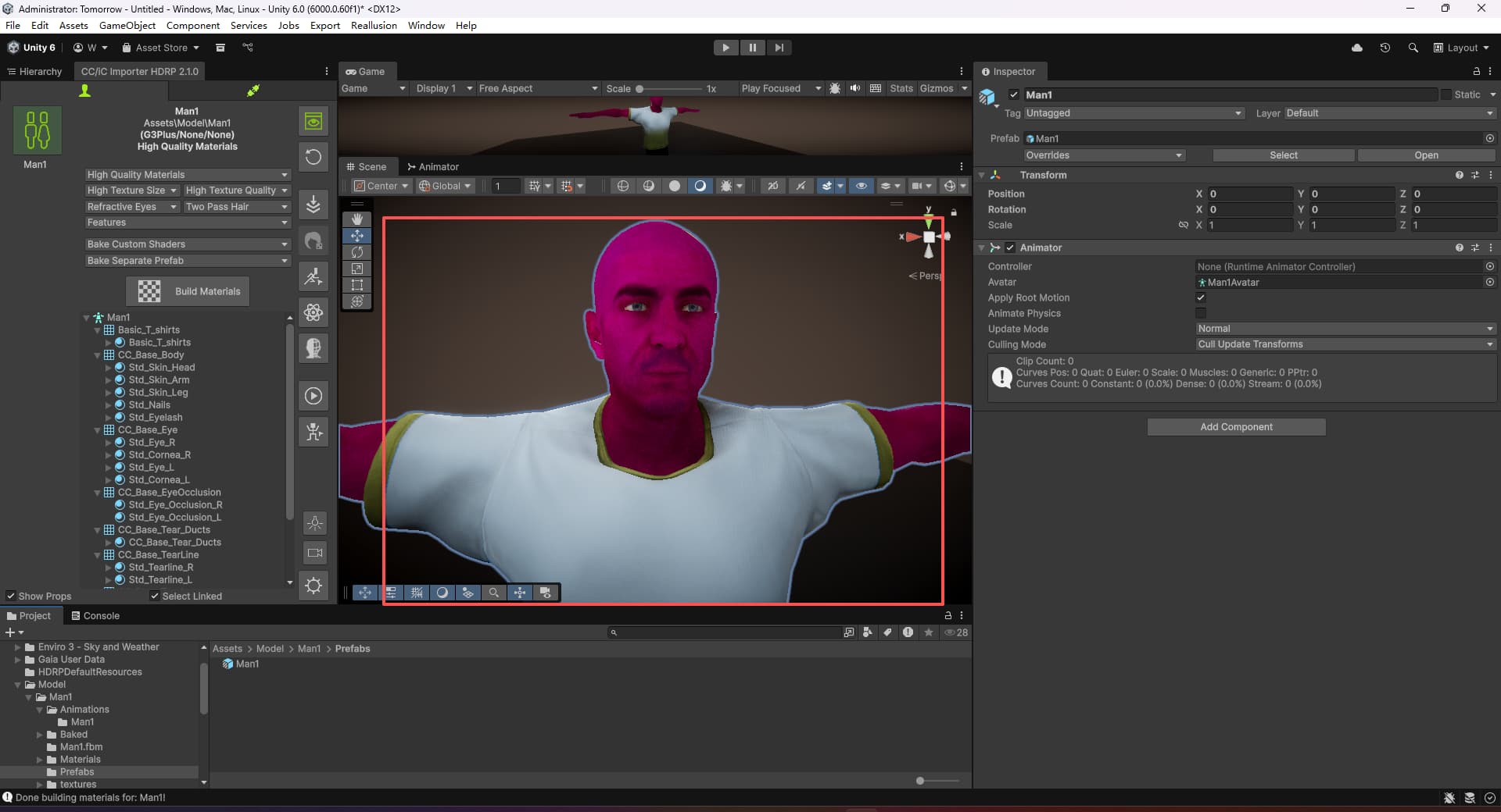

I have created a new Unity6 project and downloaded the new Unity-setup plugin.
Why is the imported character pink? How can I fix it
Fix the diffusion profiles in the global volume.
Menu: Reallusion > Misc Tools > Add HDRP Diffusion Profiles
usually does it.
Or click the fix diffusion profile button in the material inspectors of the purple materials.
