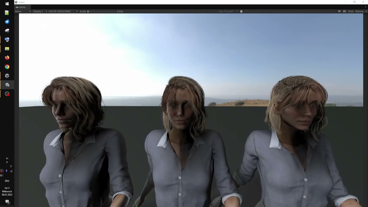

The Unity importer is really great. I just have an issue when using it in the Meta Quest in XR mode: the hair shows the real scenery behind the character; it seems there is an issue with the depth buffer.
As seen in the screenshot, I can see through the hair of the character and even through the grey box behind the character and the bright white monitor screen in my room shows through where the hair is.
Here is the full video. In the video, I first show the issue when looking through the character. Then I move left to show a quad onto which the hair texture has been applied with a normal URP transparent shader: no see-through. Then I move to the right of the character to look at a quad that has the same texture, but with the original Reallusion material for the 1st pass (baked) applied: you can see that the seethrough happens at the edges of the hair strands, where the alpha value is neither 0 nor 1 but in between. So it seems at these points the depth buffer get messed up and the real environment is shown although the virtual objects should be visible there.
Anyone knows how to solve this?
