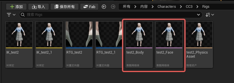

Can’t move iclone_origin after add to UE 5.7 Map
After auto setup, I got two skeleton meshes with whole body meshes. But one body and one face are expected.
