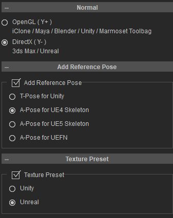

I’m having the exact same issue and can’t package a project because of this. Has anyone here solved this or the issue was shelved?
I tried to compile CR_FaceExpRig.Rig and dived in the nodes but it didn’t solve the problem.
UATHelper: Packaging (Windows): LogInit: Display: LogProperty: Error: FStructProperty::Serialize Saving: Property ‘StructProperty /Game/CC_Shaders/Utilities/CR_FaceExpRig.RigVMMemory_Work:RigVMModel___DISPATCH_RigVMDispatch_ArrayIterator_Element’. FallbackStruct structure.
After several testing, i try to use A-Pose for UEFN, and go back to A-Pose for UE4 Skeleton cause project use GASP but that didnt work i see there two errors
this is the errors in CR_faceExpRig, is the problem
UATHelper: Packaging (Windows): LogProperty: Error: FStructProperty::Serialize Saving: Property ‘StructProperty /Game/CC_Shaders/Utilities/CR_FaceExpRig.RigVMMemory_Work:RigVMModel___DISPATCH_RigVMDispatch_ArrayIterator_Element’. FallbackStruct structure.
PackagingResults: Error: FStructProperty::Serialize Saving: Property ‘StructProperty /Game/CC_Shaders/Utilities/CR_FaceExpRig.RigVMMemory_Work:RigVMModel___DISPATCH_RigVMDispatch_ArrayIterator_Element’. FallbackStruct structure.
Here is te log
