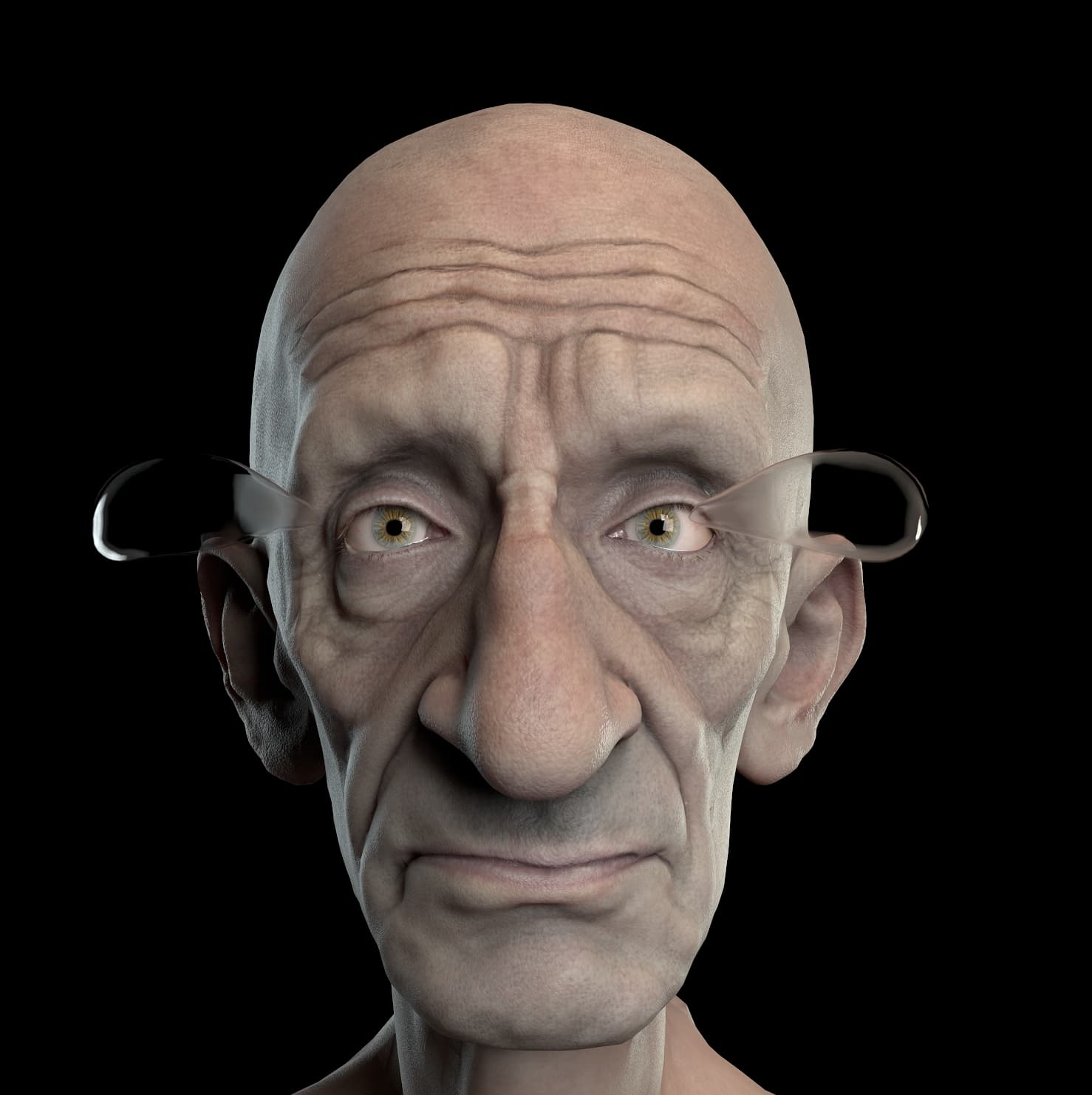

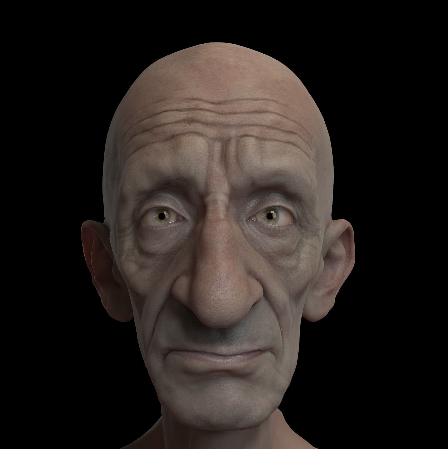

Not sure why, but when I use the RTX render, the eye occulsion is outside, but it is find in the DX11 render
