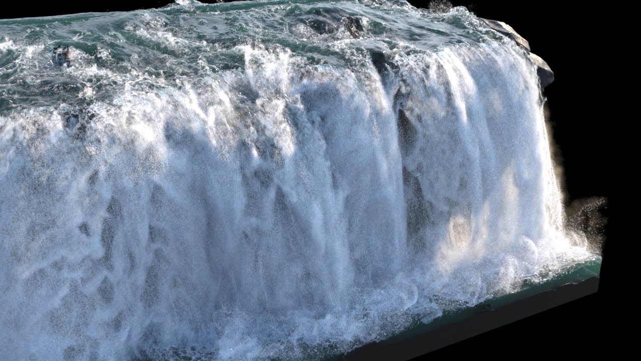

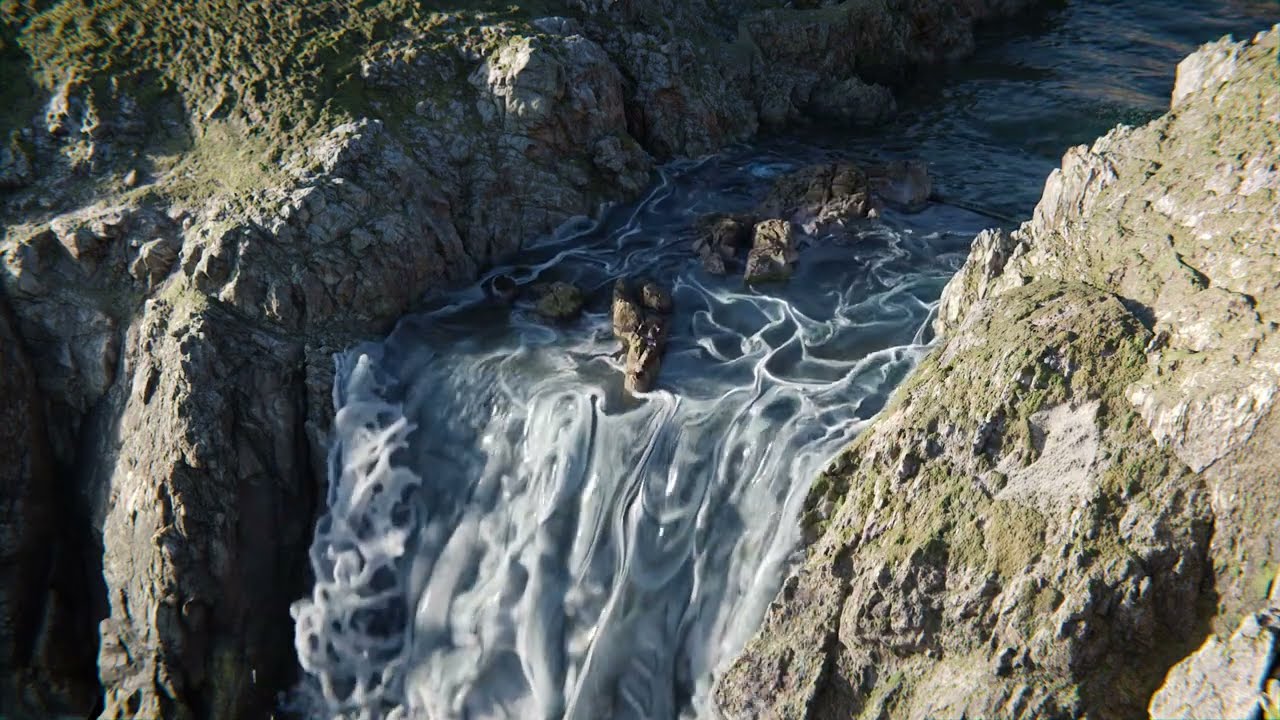

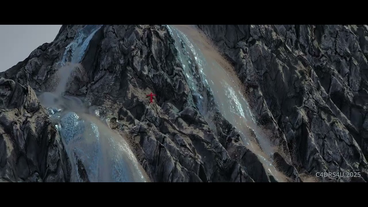

To return to the original subject of this thread, here is a little water simulation I finally rendered (the simulation itself was done several months ago). The red, human-sized stick-figure is for scale.
XP is a decent fluid simulation system but here
The scale of the water seems off
making it look like a tiny movie set miniature.
This is a common problem with large scale waterfall simulations that use only mesh based geometry
The droplets seem too big and typically when water falls that distance you see alot more “mistification” by the time it reaches the bottom due to air friction.
large scale waterfall simulation need to have a secondary layer of fine particles to represent that mistification.

Actually, there are “water” particles (from three different sources) and separate “foam and spray” particles. For the render, the water particles are meshed and rendered with a “water material”, while the foam & spray particles are rendered as tiny dots (for the “mistification”). Did you watch the 4K version on YT at 4K?

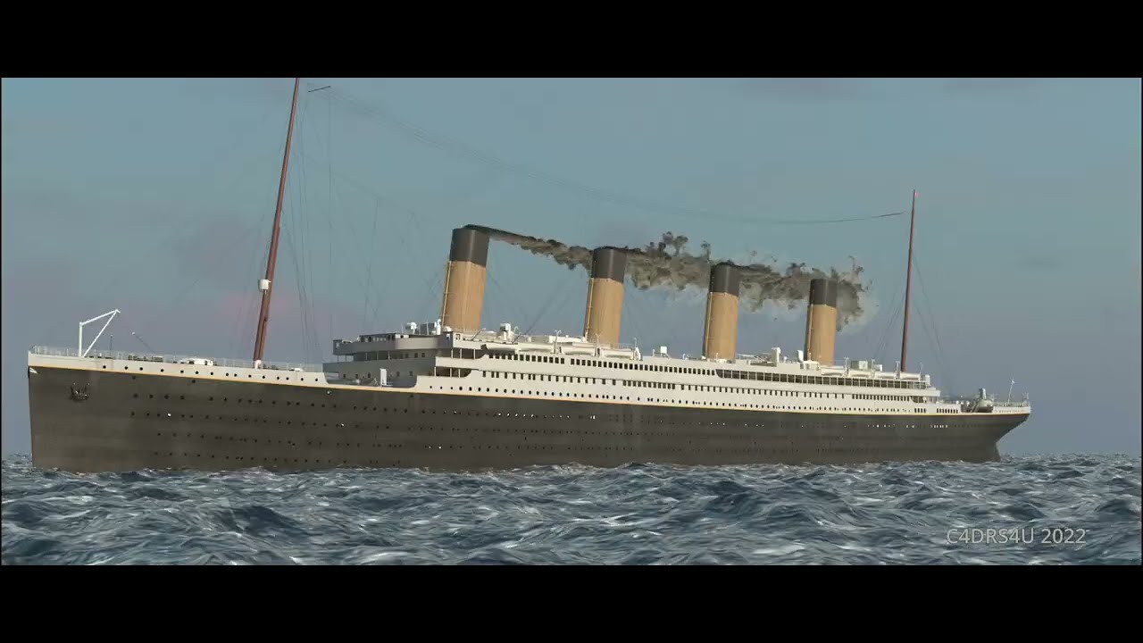

I get that. It’s enough work just figuring out C4D without going to another program. As happens, I’m right now struggling trying to fake a fluid sim of sorts: I have a ship on an “ocean” created on a plane with a combo of Displacer and Displacement, with a Collision deformer “in” the boat to displace water and leave a bit of a wake, but I’m struggling with faking a bow wave–just some bubbling foam being kicked up by the prow. I tried a Particle Emitter with Volume Builder (not seen here–this is without any sim) and that seemed okay, but I can’t seem to get the particles to shrink toward the end of the simulation like you were able to do with the old system–there must be a way, but there are too many settings, and some of them seem to work backwards. It doesn’t have to be too realistic, since it’s from a distance, and I’m okay with a somewhat stylized look. Any advice welcome!
yes I see the attempt you made for foam and spray but from that height there would be no “solid” water visible after falling a certain Distance until it collected at the bottom.
Assuming your little red guy is six feet tall so by my estimation that entire cliff face is at least 100 meters tall
(if not more)
Most of that water would be reduces to mist
by the time it reaches bottom made worse so
by the many impacts along the way further reducing its droplet sizes

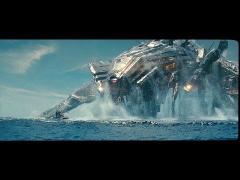

But to be fair realistic water you see in Hollywood films is always done with some proprietary in house system.
This Movie failed at the Box office but
I enjoyed it and LOVED the water effects by ILM

I don’t know how tall the cliff is, but the water is not in “free fall” for the entire height, it’s more a series of smaller waterfalls than a single one from a great height (the water is in contact with the rock for much of the way down).
As far as I know, the “foam and spray” system in XP does not support mistification based on height out of the box, but I suppose, it might be possible to introduce conditions under which the water changes from being water to become spray and back to water again when it pools at the bottom. But, as I said, I hadn’t given this any thought previously.
There is one more thing: the size of the individual water/spray particle. For the simulation to work, both need to be the same size during the simulation (but not necessarily when rendered). Currently, this simulation uses a particle radius of 3 cm (i.e. 6 cm across) and during some frames there are 6.7 million particles in the sim. So having a smaller (i.e., more realistic) “droplet” size of say 0.5 cm in diameter would probably exceed VRAM capacity and make the simulation not feasible on “home” equipment. Also, the meshing of the water already takes about 2.5 minutes per frame (the meshing is CPU-based); I don’t want to know how long it would take with, say, 10 billion particles if that could be done at all on a PC.

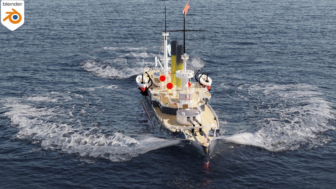

I was tempted to try this with my flip fluids addon but this guys simulation took 12 hours. :weary: :weary: :persevere:
I may just try this addon which is likely faking it with geonodes but sure looks faster
