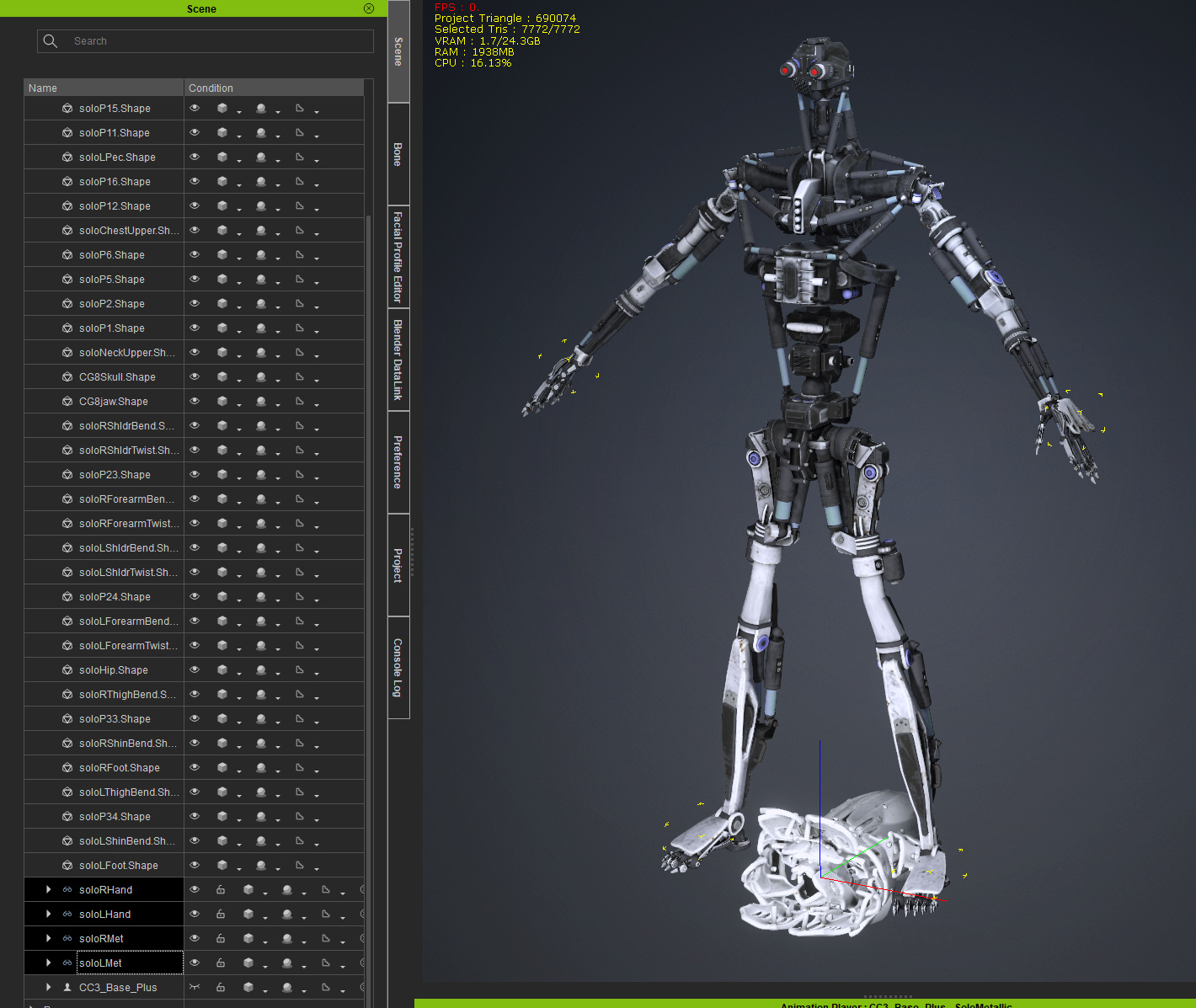

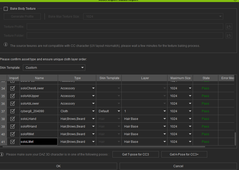

I used to use a different method importing DAZ accessories. I have not tested it much lately with G9, but in nutshell I import accessory as Type: Hair,Brows,Beard and Layer: Hair Base.
This method is better than importing as an Accessory, because it does not dump all accessories to the root, but instead places them to the correct location “almost” perfectly. And it does not deform the mesh either.
I just test re-imported DAZ Cyborg parented to G8 Male.
Here I only selected 4 parts as Hair and the rest as Accessories
After importing, I have applied a DAZ A-pose (converted from the fame FBX) and my imported Hair items fell in place just fine (unlike the rest which are currently Shapes due to a bug and on top of that dumped to root).
Finally I selected all 4 Hair items, converted to accessories and attached to the respective bones.
