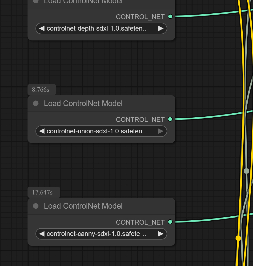

I am guessing it is because the controlnet is using the “union” model. You can try and change the model to a dedicated open pose variation if you know your way around Comfy. If not, you will have to wait until RL does it in an update.
This is similar to the issue I solved for the SDXL workflow I added here…and it looks like RL is doing the same in the new SDXL they released.
You are looking for nodes similar to what is in the image. You will need to find and download the OpenPose models for those checkpoints

That is not the correct node…That is the custom RL Core node that passes the controlnet image from iClone/CC to the “Apply Controlnet Node”. You are looking for the nodes that say “Load Controlnet Model” just like the ones I have in my image. It should only be 1, and it will have a “controlnet_union” model.

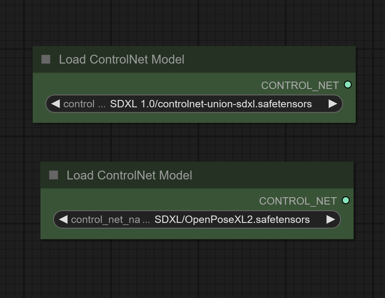

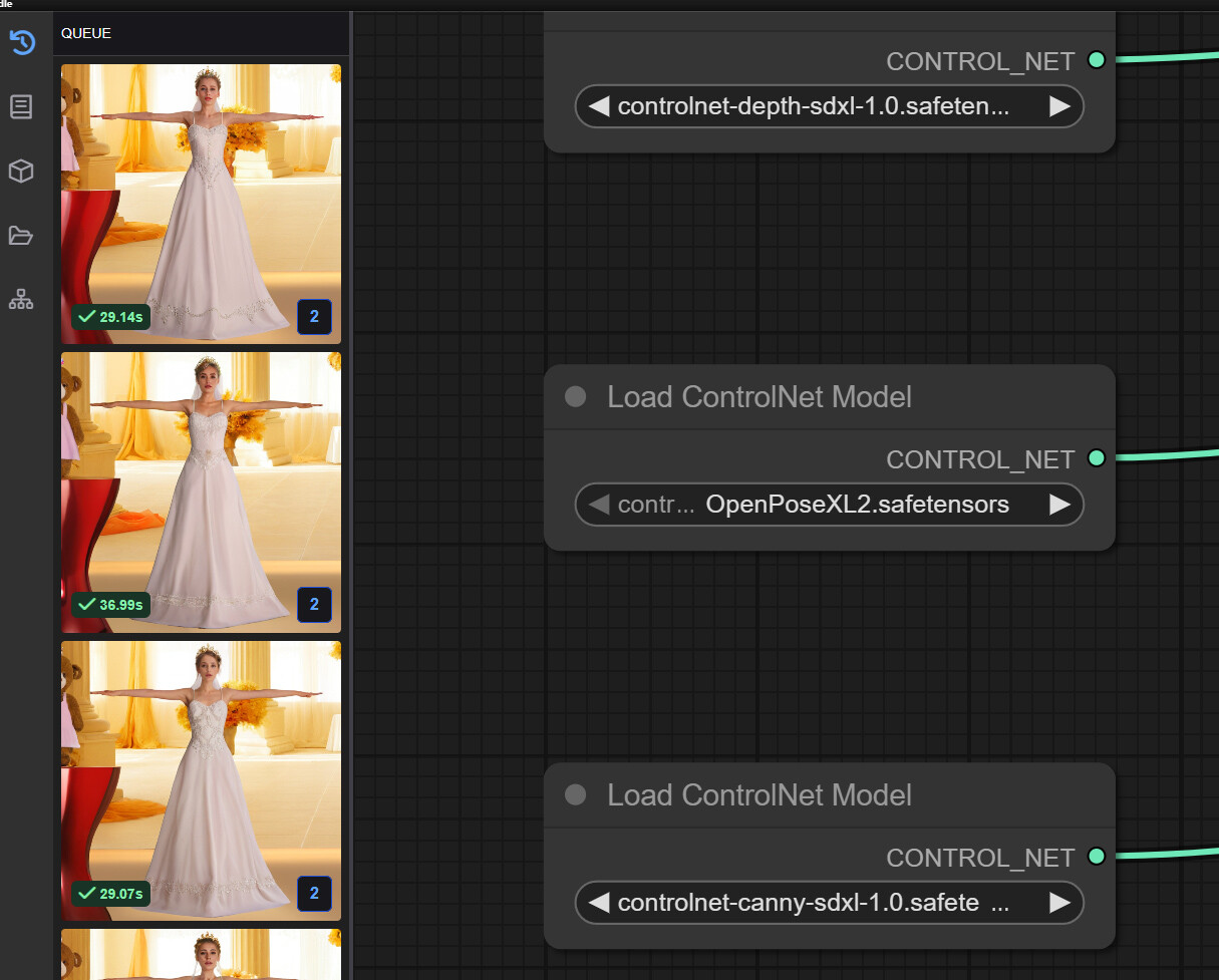

Ok, lets say for a moment I loaded a new pose control model (I did change it to OpenPoseXL2 as an example).
So what do I do next to actually generate animation?

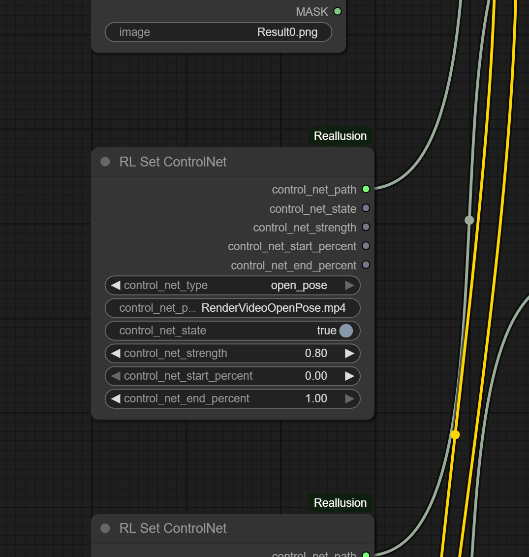

The script where I found that node you mentioned, was from History and it’s called Workflow_Pre.json. But that only generates a preview image in video mode when I hit Run.
Do I have to now “SAVE” Workflow_Pre.json with a new node at the same location in History and try to render a video in iClone? That is I am not sure this script involved with video rendering in any way, which is where I have a problem.
If the skeleton artifacts appear only at the video generation stage, then it’s not related to the workflows used for image generation (SD1.5 or SDXL).
The current Video Gen Template relies on WanFun Control and Wan Vace, which both read ControlNet data directly via the model’s native ability and corresponding nodes (ex, WanFunControlToVideo). Thus, any issue is more likely due to parameters needing adjustment or the order of node connections. Would you be able to provide the history folder from your tests so we can use it as a reference?

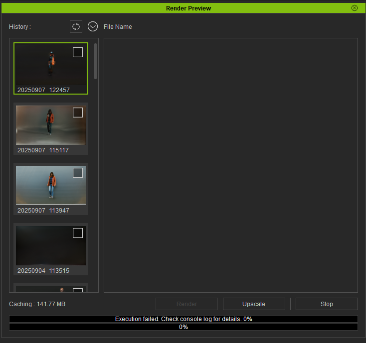

Video render launch:
I tested with: "Wan2.1 fun 1.3B Control" and also "Wan Vace 1.3b" — both returned the same error message. I’ll illustrate using "Wan2.1 fun 1.3B Control".
I click on Render, then Confirm, and confirm the filename to be generated. That’s when the following error occurs. Below is the part I copied from the console, which I believe relates to the error message:

After launching this render, the following files were added:
Workflow_Gen.json
gen_setting
So I go to the ComfyUI interface:
  • Render Setting → Open WebUI
  • I open the workflow: Workflow → Open → History folder → Select workflow: Workflow_Gen.json
  • I run the workflow: Run
And then I get this error message:
WanVideoEnhanceAVideoKJ
'UNetModel' object has no attribute 'blocks'
With the 2D render, I received this error:
KSampler
mat1 and mat2 shapes cannot be multiplied (77x768 and 4096x5120)
I suspect this may be related to model compatibility or how the models are combined.

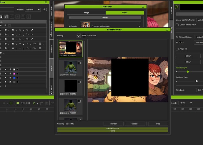

I tested out iclone 8 Beta ai render and in the preview I end up getting a black box covering the characters face
Hello, backalleytoonz,
Could you please try unchecking the Live Portrait Consist Expression option in the Control section and see if this resolves the issue?
