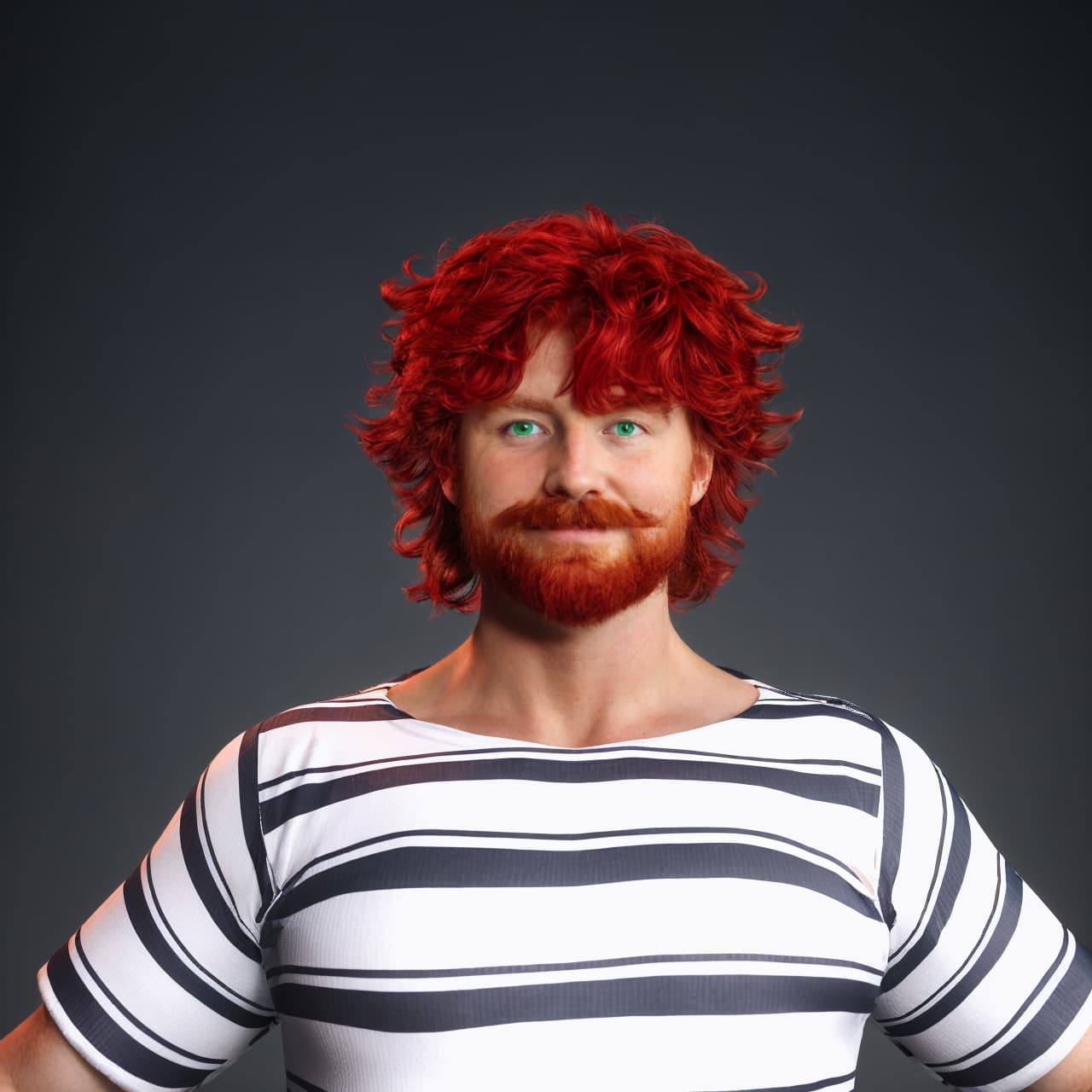

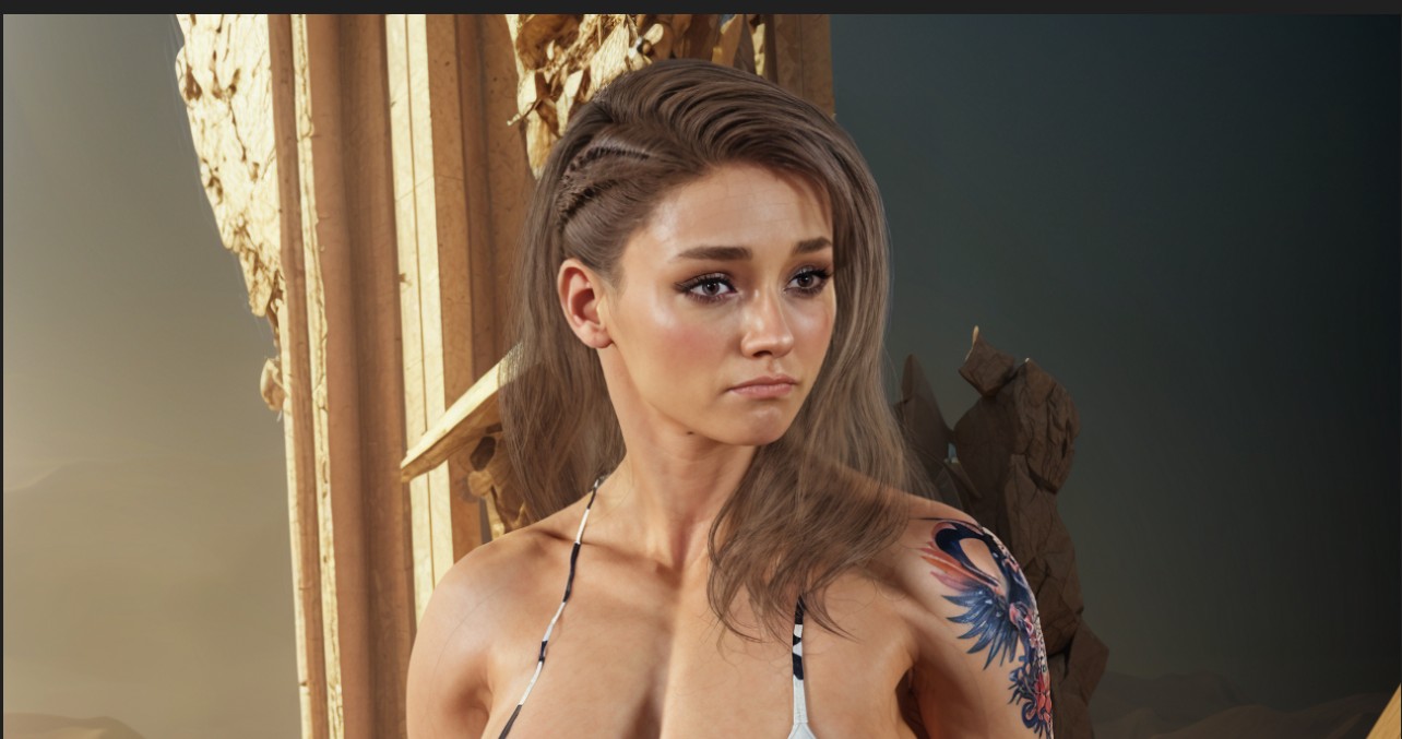

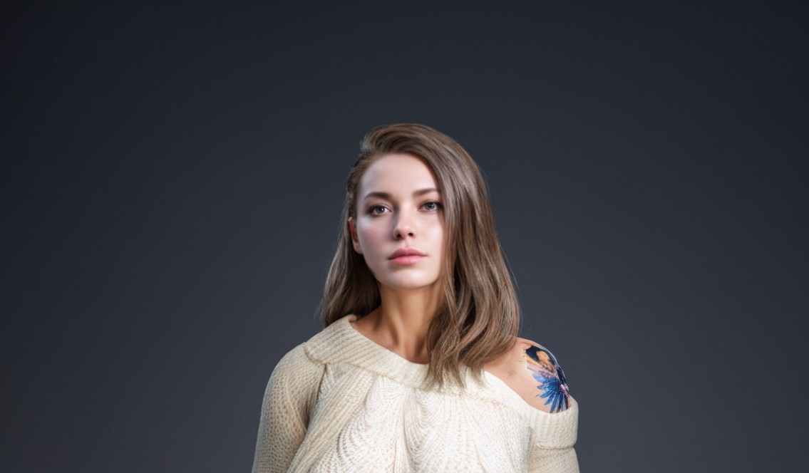

So I’ve tried the newest version of the AI Render Plugin and…I don’t like it. It’s not all bad. It does details a little better. Definitely captures tattoos and some other features with more accuracy. Muscle tone as well. The old AI plugin struggled with that, although I did tweak it to be able to capture muscle tone and some skin details. But this one simply will NOT give me the look I want no matter whether I use HD Realistic Image style or Photorealism Image style or any other style.
Above is the source image from CC5.
Above is the render I did in the old AI Render plugin using Photorealism style. I didn’t need ANY prompts - this just spit out immediately and it was perfect. I couldn’t have been happier.
These are the images I’m getting with the new AI Render plugin. And they’re pretty consistently bad. I did include one image using the HD Realistic Image style, but what’s most remarkable is even with A LOT of prompting I can’t get the plugin to do green eyes. I CANNOT get anywhere near the image of that first plugin - and this is a REALLY small sample size. I have done over a hundred renders with another character, using different lighting setups, different prompts, changing the sliders and it just CANNOT get back to where it was. Not sure why. I primarily use the Photorealism Image style, that’s my preference. Anyway, those are my gripes.

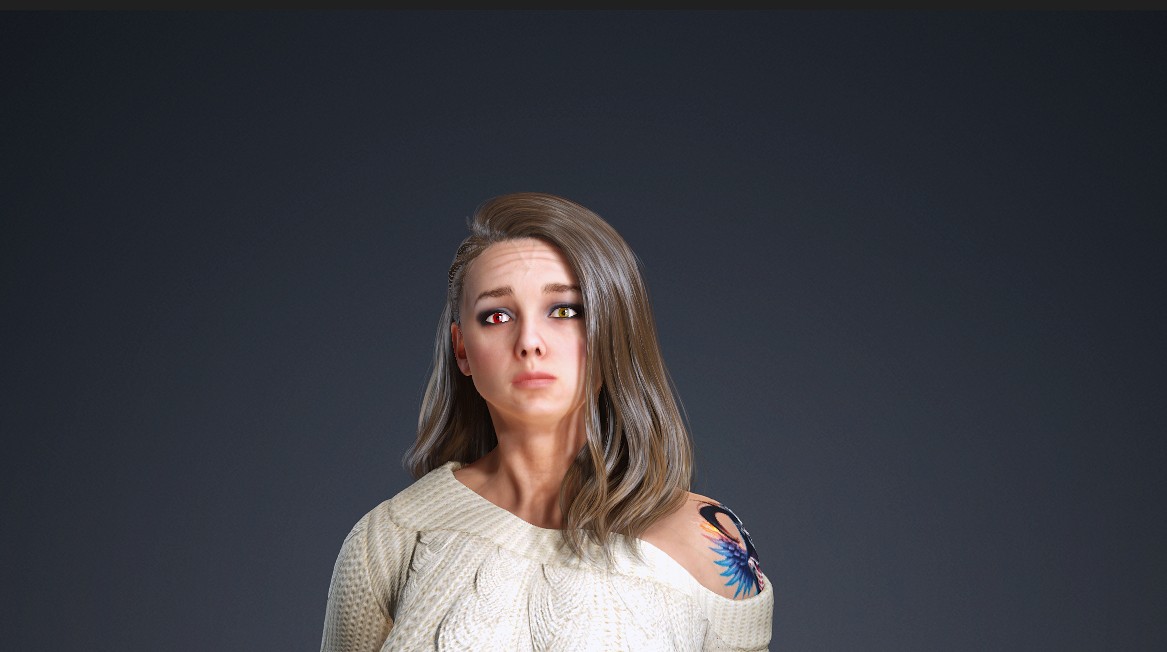

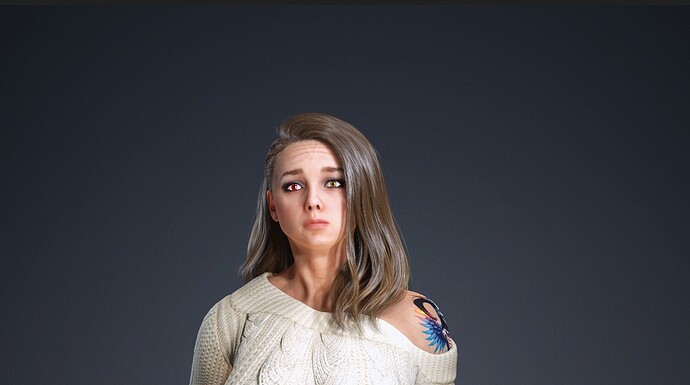

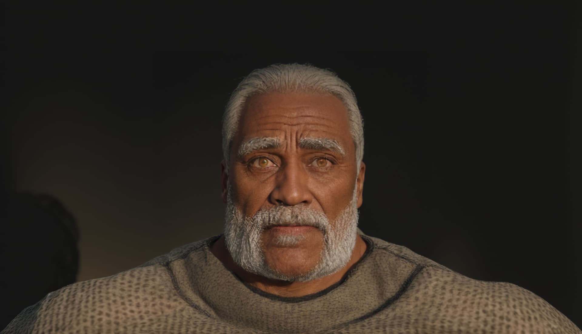

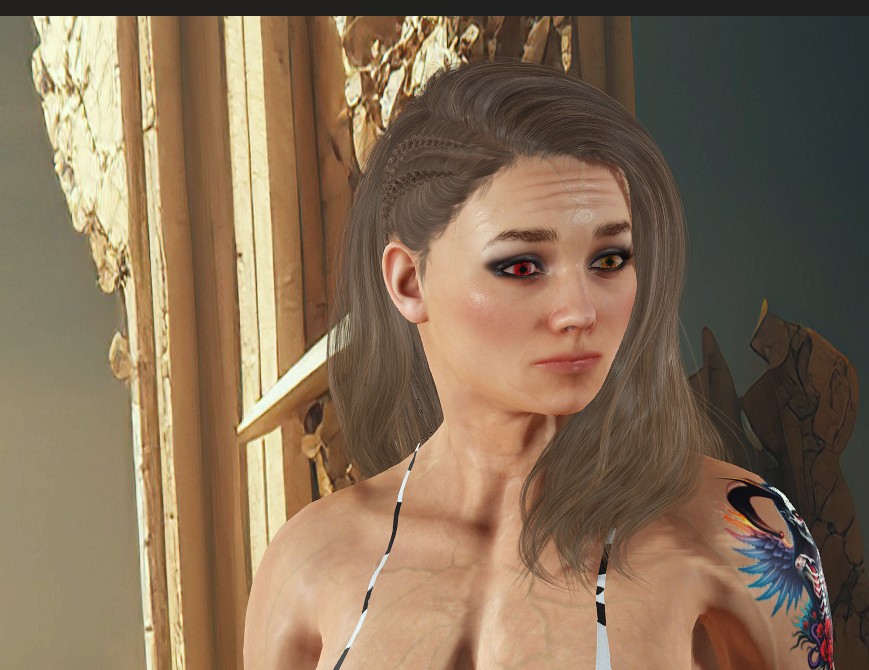

That must be it. That’s new to the plugin. Shockingly, it also is terrible at doing expressions.
Above is a facial render from the old AI render plugin. It NAILED this expression and look. Now it DID mess up the tattoo on her shoulder, which the new plugin does do much better.
Here’s the same model in CC5 doing the same facial expression with the new render plugin:
It also over exposes her face. The skin on her face doesn’t match the skin on the rest of her body. It doesn’t do that all of the time but some of the time it does and it’s very frustrating. And the skin lightening effect is bad on dark skinned characters. Here’s the old AI render plugin on a darker skinned model:

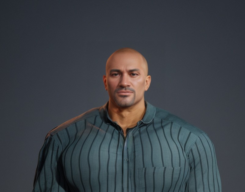

Brilliant!!! Chef’s kiss on the quality. And this was the FIRST time. Here’s my first effort on a different model with nearly the same skin color (actually a LITTLE closer to my own skin color):
And then, AFTER I did some prompts to explain the guy was African-American I got this:
But it took a PROMPT for his darker skin to show up. And he’s not smiling AT ALL. It doesn’t look better than the native CC5 render.
Basically, as you said, we need to turn off that facial detailing software. It makes everything worse. Until it gets fixed there’s no reason for me to use it. I haven’t done a single render using the new plugin that even comes close to any of the old plugin renders. Even turning the denoise slider down to .13 it doesn’t give me anything near the native CC5 render. It needs a lot of tuning to me.

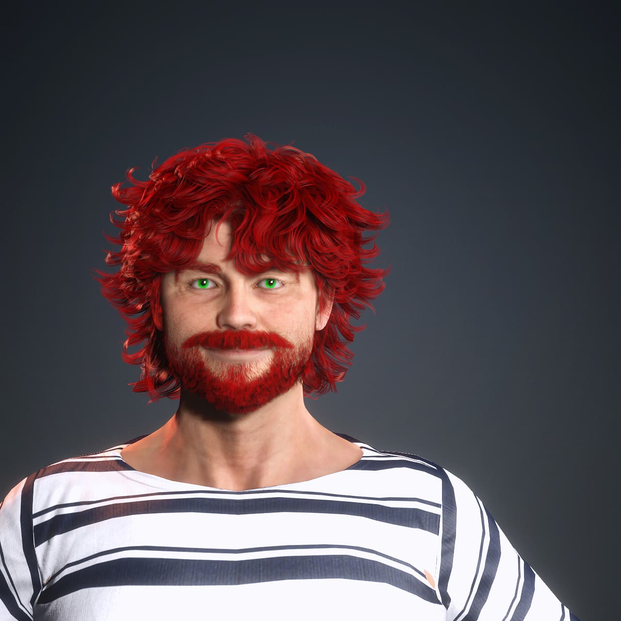

The button that turns off the face detailer works. It VASTLY improves the AI render quality.

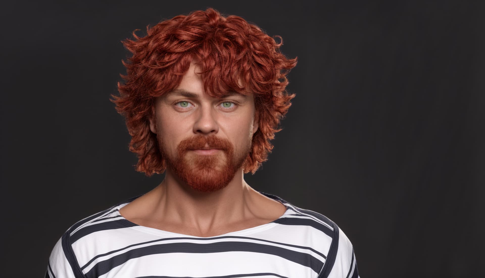

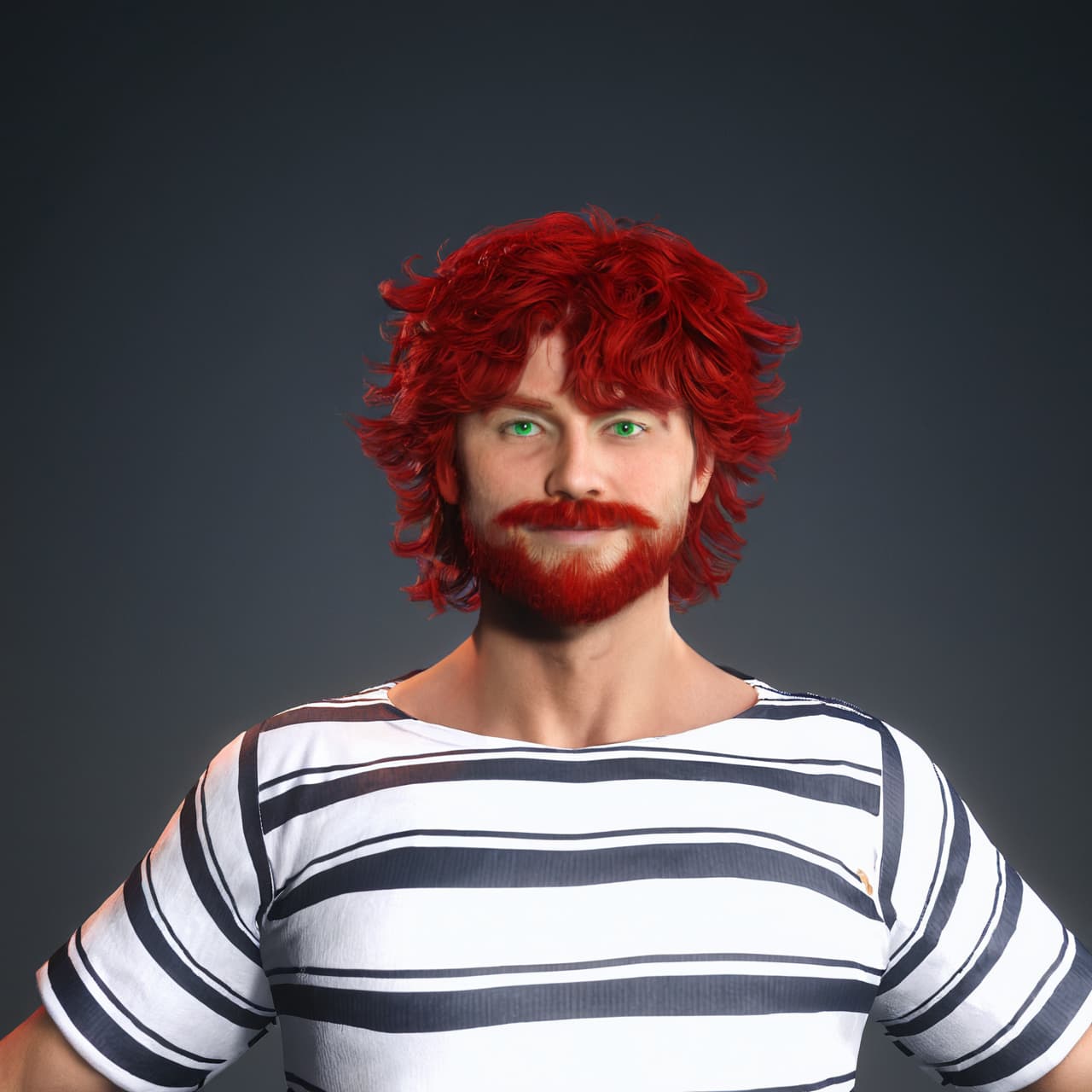

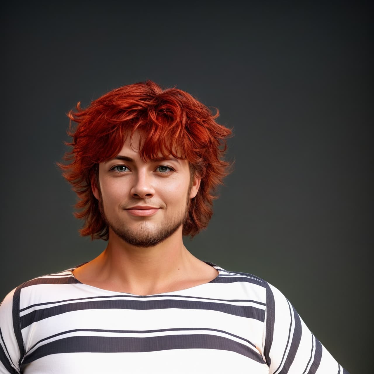

Let’s revisit Jake again:

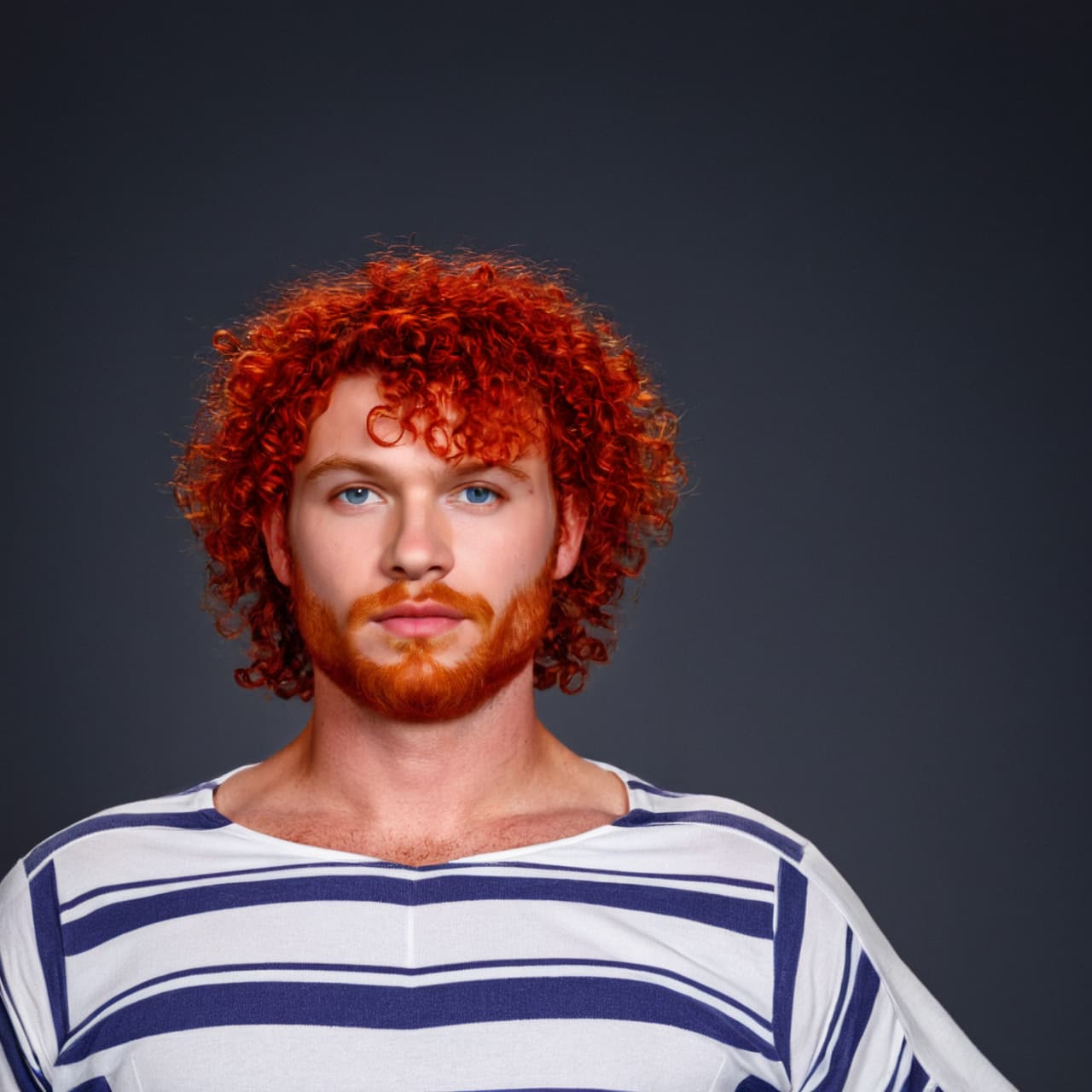

This is the first render. No prompts needed.
Here’s a pic with a prompt to make his eyes emerald green.
And above is a render where I did some tweaking with prompts and some of the sliders. These are all excellent.

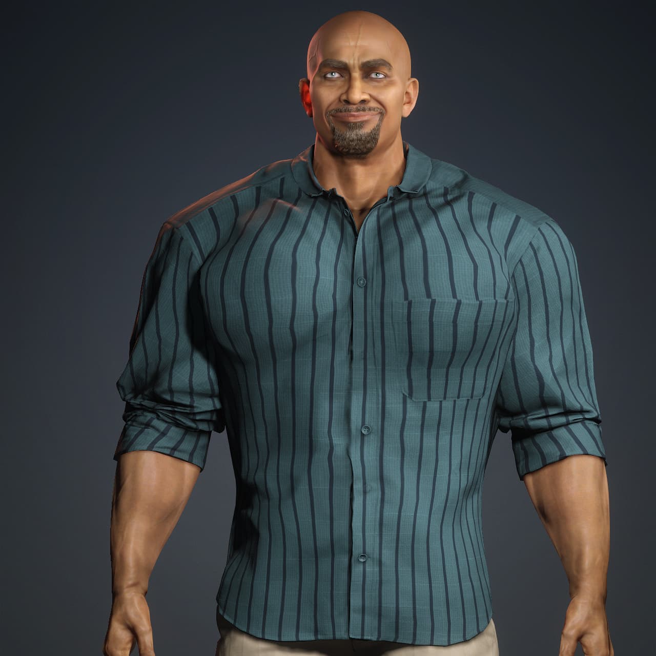

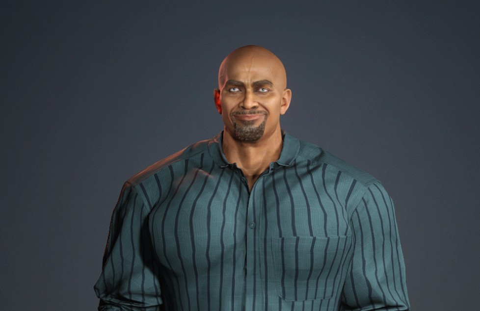

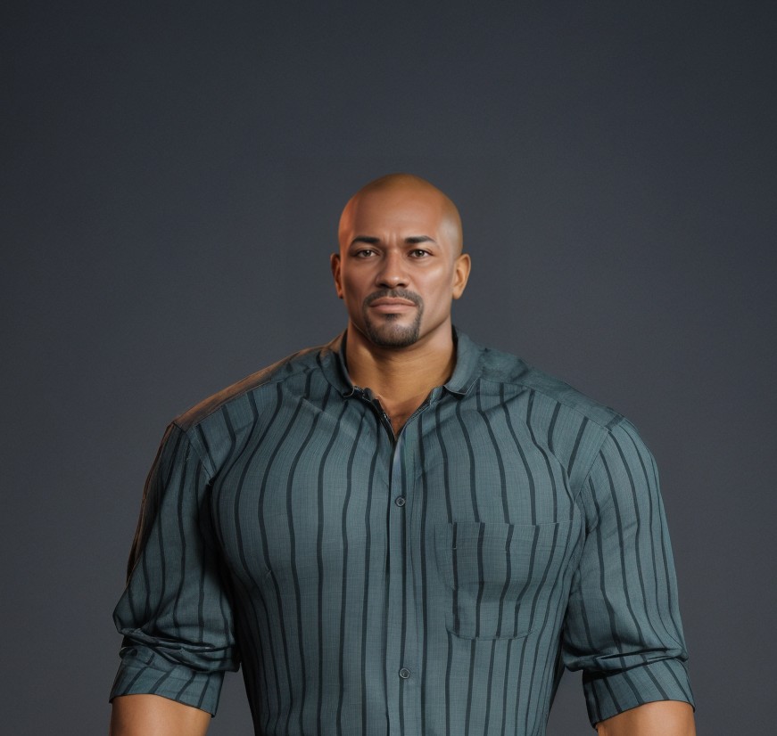

I had a gripe about darker skinned models, so let’s take a look at Lonnie.
Above is the source image.

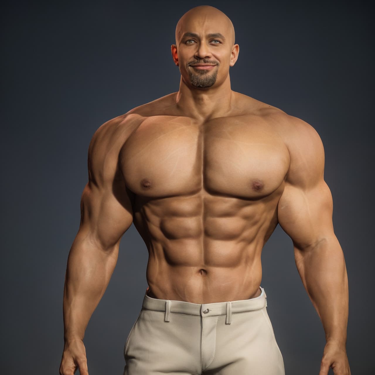

Above is the first render, no prompts. FAR better than before.
One thing this updated version of the AI plugin tool does better than the prior one was body details. I wanted to see if it could capture the face along with the body with a minimal loss of quality. It did.
So my early conclusion is ALWAYS turn off the face detailer. It CAN do facial expressions, but it’s a little hit or miss, but at least it will change the facial expression to something else, whereas the other one seemed not even try to read facial expressions.
