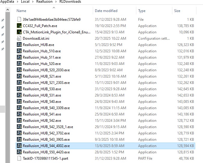

do you have more concise instructions to downgrade. I followed the link above and i’ve located the last Hub executables e.g. reallusion_HUB_544_4002.exe but when i click it, it just tells me my current version is the latest and that I don’t need to replace it?
Pls let me know if I am doing the wrong procedure! I’d really like to have the plugin working again - especially for the seminar this weekend :pray:
tq
Hi @oberdoofus
We have updated the post with more concise instructions, let me know if you need more assistance🙌
works great - thanks!
