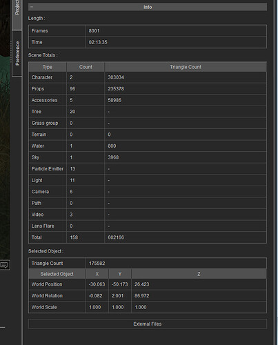

I’ve noticed a lot of crashes with iC 8.52 since I upgraded a few months ago ( I know, I was the last holdout) but this is what I was afraid of when I switched from iC7 which has been pretty solid.
The common denominator for me “seems” to be Set/Water. It will crash with a particular camera or other cameras, usually at the same frame each time. If I switch-off-visibility or remove the Water object it won’t crash.
I’m doing a scene located in a swamp…so these “Water-related” crashes are VERY frustrating!
I have tried different Water objects but all seem to react the same way.
It will crash while playing or scrolling in the Viewport or while Rendering the scene.
Has anyone experienced this issue or have any ideas on a solution?
The GeForce RTX 3090 drivers are up to date by the way.
I have re-booted the system to see if that helped but no change.
The scene is not big just a couple of avatars and a few props.
