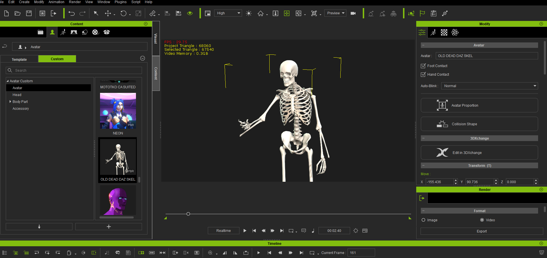

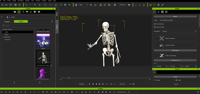

I just tried to rig an old Daz skeleton
.obj and indeed Accurig failed with an “evaluation” error. :rage:
That said I did manage to “back door” the Daz Skeleton figure exported as FBX to , Iclone 7 ,via 3DX,
He was auto recognized by 3DX as a Daz figure but his forearm bones still went wonky and his heel bones went missing entirely.
But he is a fully animatable Iclone nonstandard avatar.

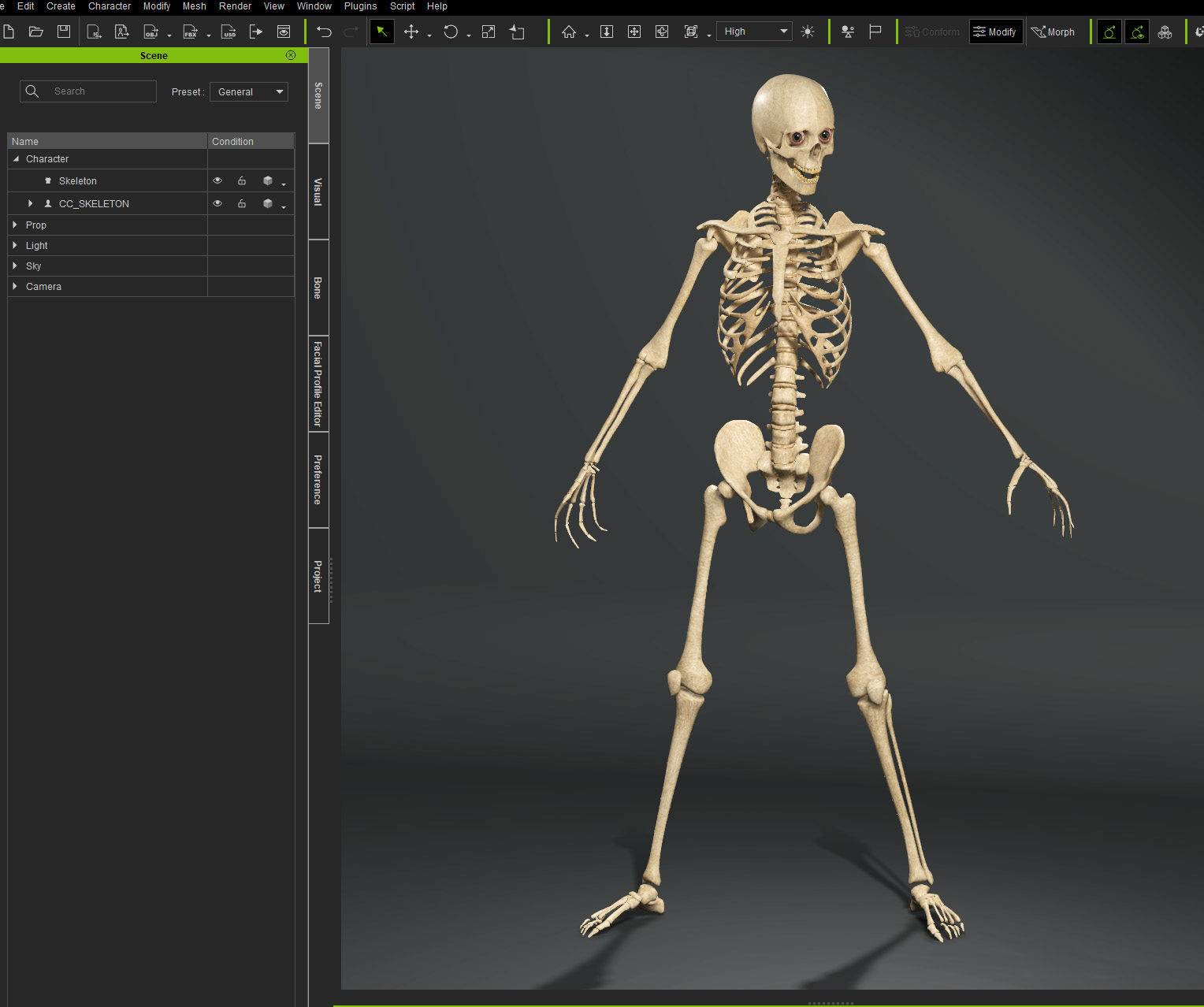

I did him a long while ago by rigging to CC character as a cloth.
Nowadays CC4 AccuRig can sense limb joints on any mesh even if it’s disconnected, it’s just not on free stand-alone edition.
