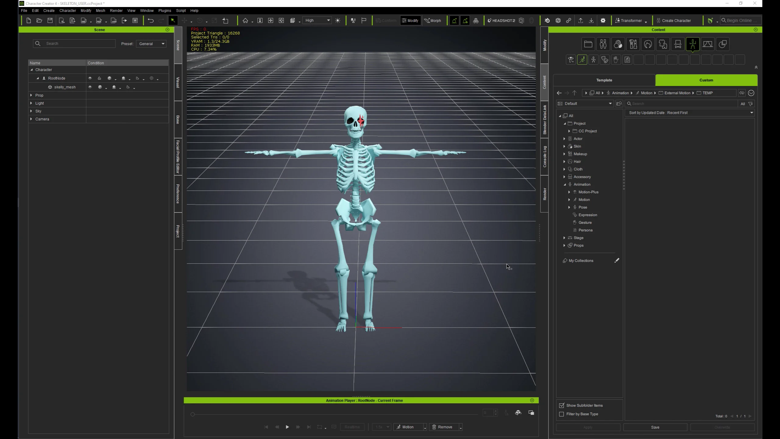

Ok i have made some progress. I got a license for Character Creator, then i did the following according to the Reallusion tutorial video.
- I exported the animation as an fbx from blender
- I exported the tpose from the same character
- Imported the tpose into CC
- Assigned the custom profile I create to map bones.
- Tested the imported character with default motion (seems fine)
- Imported my own fbx animation on the tpose (added cutom profile and tpose)

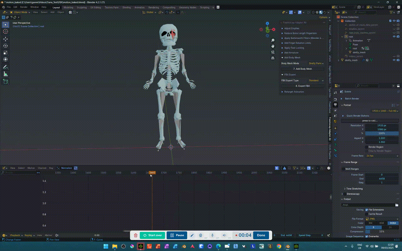

The issue is that the character jumps out of position (lower) and its centered around the hip instead of the feet being fixed on the floor as it should. Can someone seem what im doing wrong?? See screeecast here
Hi
I re-read the entire thread and I am still confused about your actual objective.
your screen cast shows the character in Blender moving strangely.
Are you trying to create the animated character in Blender and send it to Iclone for rendering?
Or are you trying to send the character to Iclone for animation and send him back (with animation) to Blender for rendering?

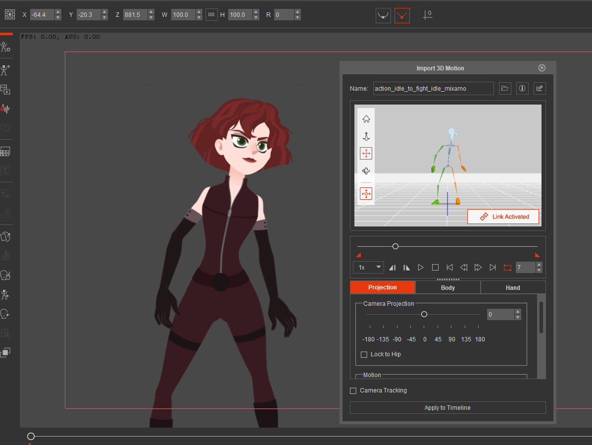

I need the character in Iclone > Cartoon Animator via plugin. As long as it works with the iclone dummy im good.
The way the character moves in Blender is not the issue, thats fine. I just need to replicate what i see in Blender into Iclone. By the way, I used to do all this using 3dxchange perfectly. It converted everyting into icone with no issues. My issues have only arise since moving to iclone 8
I have Cartoon Animator
and it can import Iclone 3D Imotion
onto CT characters.
But CTA cannot import actual Iclone characters of course. ![]()

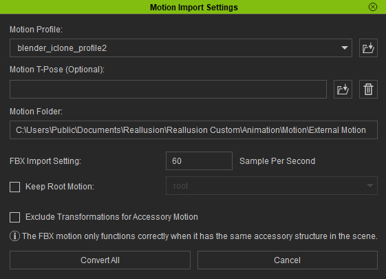

Yes, as I mentioned, use Convert External Motion with following settings. There is no need for a T-pose and Root selection.
Motion would be saved in “External Motion”, then you may apply it to your character.
