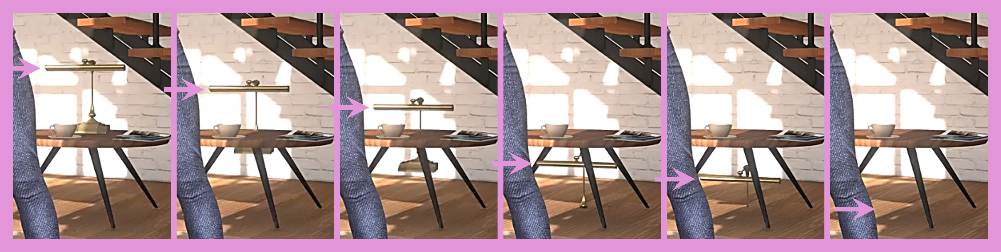

Whenever I tweak something in the scene—like adjusting Camilla’s position or even just zooming out—it gets recorded. That’s not what I want. I managed to stop the Camilla motion by using Animation > Remove Scene Animation > Keep First Frame, which worked… this time.

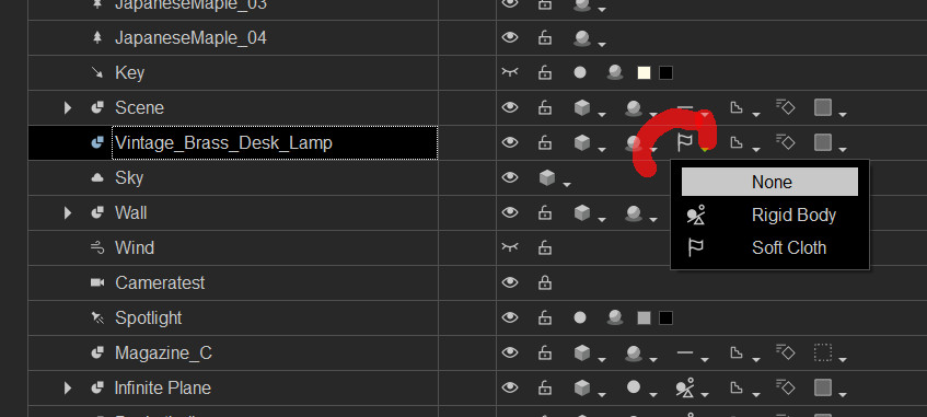

But the lamp in the background is another story. It keeps stubbornly moving downward when I play the scene. I’ve searched, tested, and tweaked, but nothing helps. There are no visible keyframes on the lamp, and using Remove Object Animation or Remove Vertex Animation via right-click doesn’t stop it.
See the pictures as an example.
Do any of you know how to fix it?
That is part of the iClone “philosophy”, so it is somewhat “dangerous” to changes things you don’t want to animate at any frame except 0.
However, zooming should only be “recorded” if you have added a camera and that one is active.
With regard to the lamp: If you already tried “Remove Object Animation” you may want to check if the lamp is “attached” to anything else that is animated, meaning any keyframes would not be on the lamp itself but on the object the lamp is connected, attached, or subordinate to.
Another option is that you have physics enabled for the lamp (if you’re new it’s easy change a setting without realizing it).
There is a Physics track in the timeline (I believe that’s what it’s called), so may check that. It looks as if the lamp is falling down.
Also, to remove animation, make sure to be after the last keyframe in the timeline you want to get rid of.

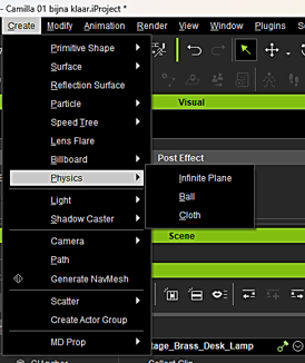

@animagic: I found in the Webinar Motion Editing for Fighting and Other Interactive Scenarios this mentioned (I have it from the transcript):
1:14:30 I’m going to throw a basketball in there props let’s go to
1:14:17 basketball now this one uses some Physics um because the basketball has
1:14:22 physics so um what we need to do with the basketball selected let’s just uh um
1:14:30 hold on let’s double click it because I think the yeah okay the root um goes on here we don’t want the basketball to be
1:14:36 going through the ground plane whenever you have physics … etcetera.
That sounds like my problem!
Thing is, in the webinar, he went to Create > Physics > Infinite Plane, see picture, and it didn’t work.
Physics
Of course, I first selected the lamp. I was after the last keyframe and tried it. No results. Then I went to 0, did it again, also no results. I saw that the system did something, but I saw no effect on the lamp.

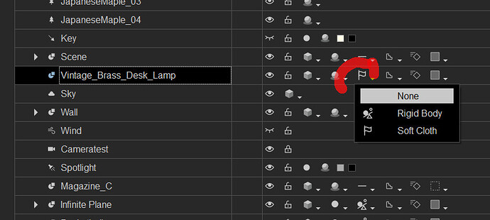

The problem is that the lamp was set to “Soft Cloth” which means it is dynamic and falls (i.e. is subject to gravity).
You need to set the dynamics to “None”:
It worked! I had tried using the rigid body, but then red lines appeared around it, which didn’t seem right to me. I didn’t check “none”. So now I can move on to my next challenge. :upside_down_face:

“Rigid Body” is also dynamic and should only be used if you want an object to be dynamic. “Rigid Body” does not mean the object does not move (change its position in the scene), but rather that the object does not deform. “Soft Cloth” is often used for dynamic clothing on characters (such as skirts or other non-body hugging types of clothing) because these objects need to deform with the character’s movement.
You did not notice any “deformation” on the falling lamp because the entire lamp was falling at the same speed. However, if the lamp had hit a “collider body”, it might have deformed depending on its mesh density.

I’m wondering why “Physics” was on for this object in the first place? :grinning:

There are so many options in the Scene Manager that it is easy to enable it by mistake.
