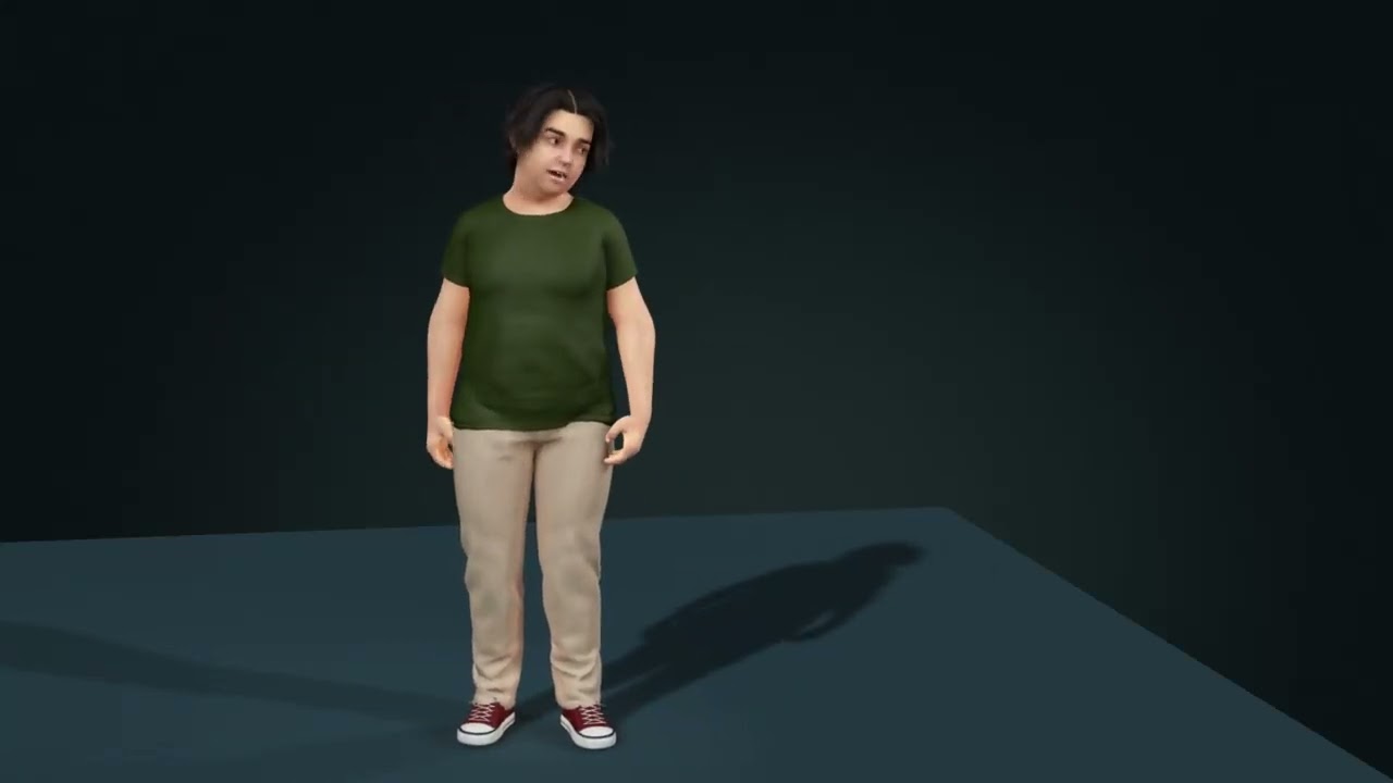

Here’s my progress so far:

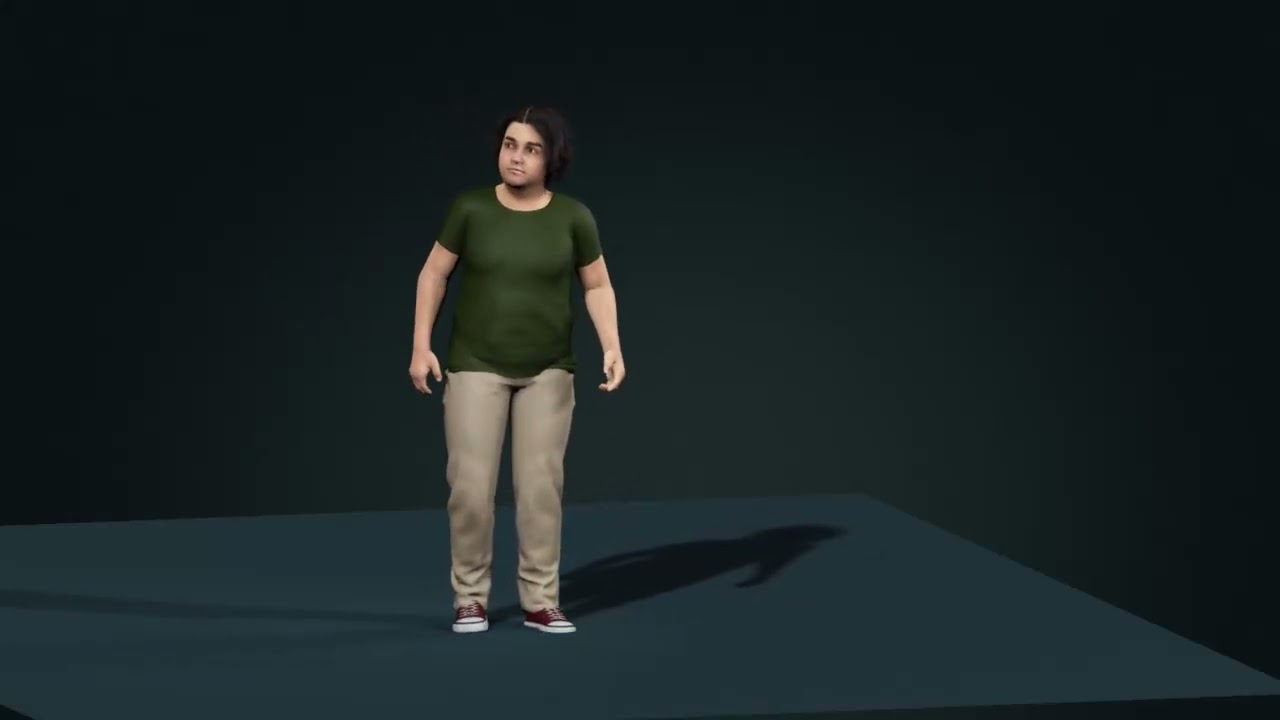

FYI: 2 ways of fixing animation within the given range (without and with additional layer).
