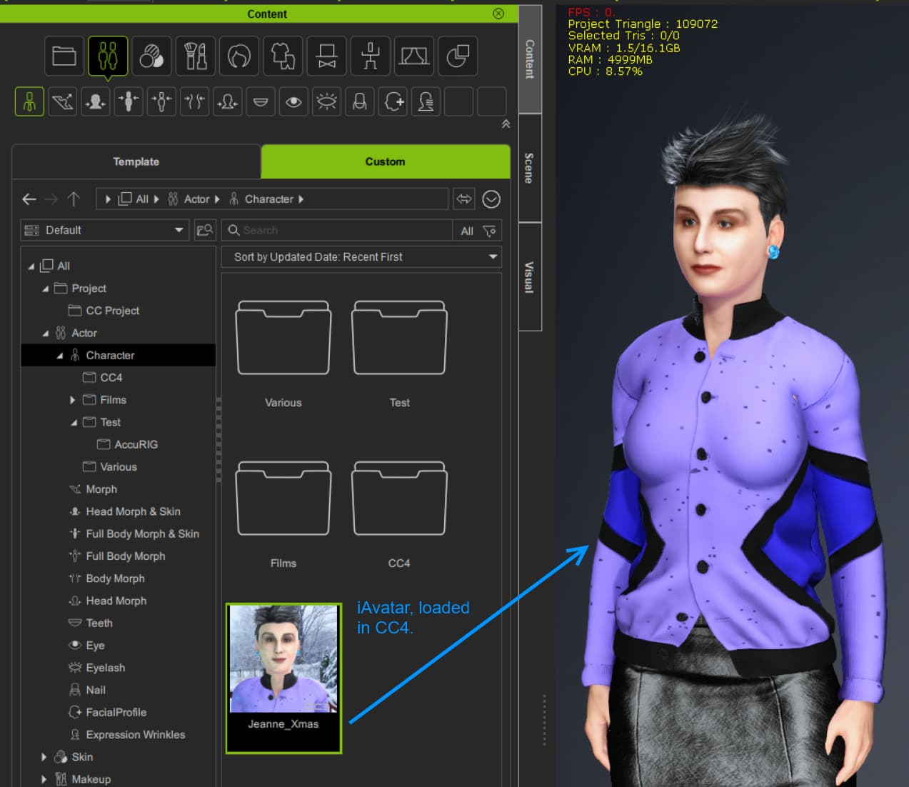

Maybe I wasn’t clear. What I meant was, you would need to save the iAvatar first in iClone, for example under Custom/Avatar/Character.
Then you can open it in CC4 via the Content Manager, Custom tab. Select Avatar/Character and you will find your character, which you can then modify. I have done this here, as an example:
You can the send the modified character back to iClone. It’s a bit of a workaround, but I don’t think there is a way to change the default.
