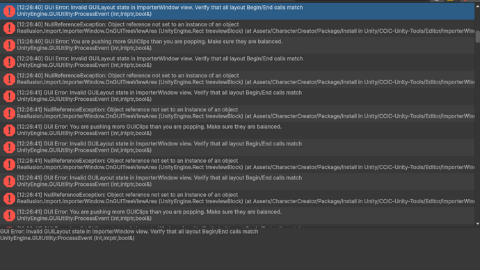

I am currently using the trial version of the character creator. My trial period is almost over. I downloaded many characters earlier to try them out. Yesterday, I had to download them again and import them into Unity, but the Reallusion window is giving me an error and I cannot build my character’s materials. Could you help me? Could it have happened after the last update?
Note: My graphics card and Reallusion Hub software are up to date. I updated them recently. There is an error in the texture json file.

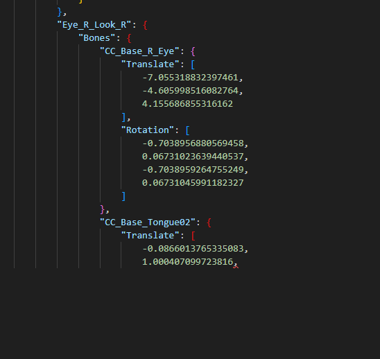

If the .json files have missing data, they won’t work.

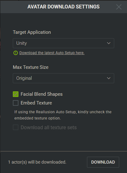

Are you downloading them from the ActorCore Website for Unity?
If so they should work. I’ve just tested a few of them, direct downloads from the website (using the settings above) and they seem to work, and all have complete .json files:

I am using the Windows application. It works for another friend of mine, so what could be the problem?
It’s looking like the latest trial version of CC5 is not writing correct .json data files when exporting to Unity, and they are causing these errors. The full version works correctly.
