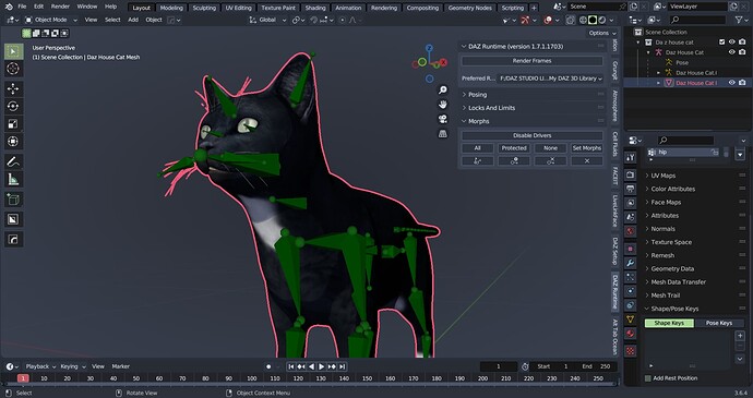

If you go the Blender route nothing will prevent you altering the Daz model once inside Blender.
Yup. That’s just what I want to do. What program did you do that in? Blender? I’ve downloaded all the Diffeo files, and I’m watching the install vid now. I see it is more complex than the last time I looked at it.
And yes, I am a fan of the DAZ talking animals. They are going to waste there. I have much to learn about Blender, but I believe the time has come. I was hoping I missed something in the CC4 import process, but it looks like not.
No that cat animation is the old “Daz millenium cat” from 20 years go speaking via the Old 32 bit mimic function in the 32 bit version of Daz studio.
the modern Daz house cat is not supported by the old 32 bit mimic plugin
Just be aware that while Diffeo will import the recent recent Daz quadripeds with basic bone rigs
I get error messages upon importing the modern “Daz house cat” telling me that morphs
(including visemes needed for lipsinc) are missing.
so Diffeo is likely not a solution for talking Daz animals either.
