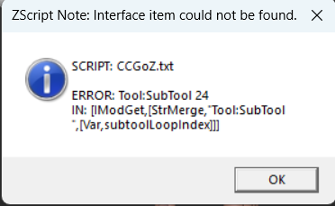

im able to export the character into zbrush edit it etc but once i try send it back to CC4 i get this error
only started happening when i upgraded to 2026.1 & happens regardless of how many models im sending to cc4. I’ve tried completely wiping zbrush and cc4 off my pc and reinstalling, but still happening

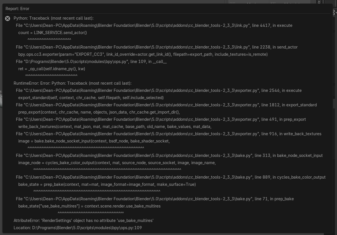

more or less the same issue can transfer it into blender but using the CC/IC link i get this error
im making the swap to blender so not entirely sure what i can do to troubleshoot this besides reinstall which ive tried. using blender 5.0.0

update: got a response from submitting a ticket for the zbrush plugin. they said
Please go to the following location and check whether there is a Reallusion folder:
C:\Users[Username]\Documents
If the folder does not exist, please create it manually, and then re-open CC, and GoZ.
After checking with R&D, we found that some changes made for ZBrush 2026.1.1 data transfer did not fully cover all cases. We sincerely apologize for the inconvenience.
Before a patch is released, please use this workaround first. We plan to patch it later this month.
You can also check the plugin is correctly installed in Zbrush.
For CC4
There is a manual setup option. Copy from the following location:
C:\Program Files\Reallusion\Character Creator 4\Resource\ICGoZBrus\ZBScript
CCGoZ.zsc
CCGoZData (this is a folder)
Copy these to ZStartup\ZPlugs64\ under the ZBrush application.
For CC5
C:\Program Files\Reallusion\Character Creator 5\Resource\ICGoZBrush\ZBScript
CCGoZ.zsc

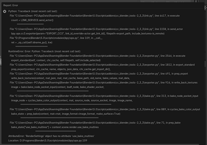

this blender plugin sucks… installed the update and still getting the same the error
it was working for about 2 days I’m running CC4 v4.66 & blender plugin V2.3.4 installed directly from the hub

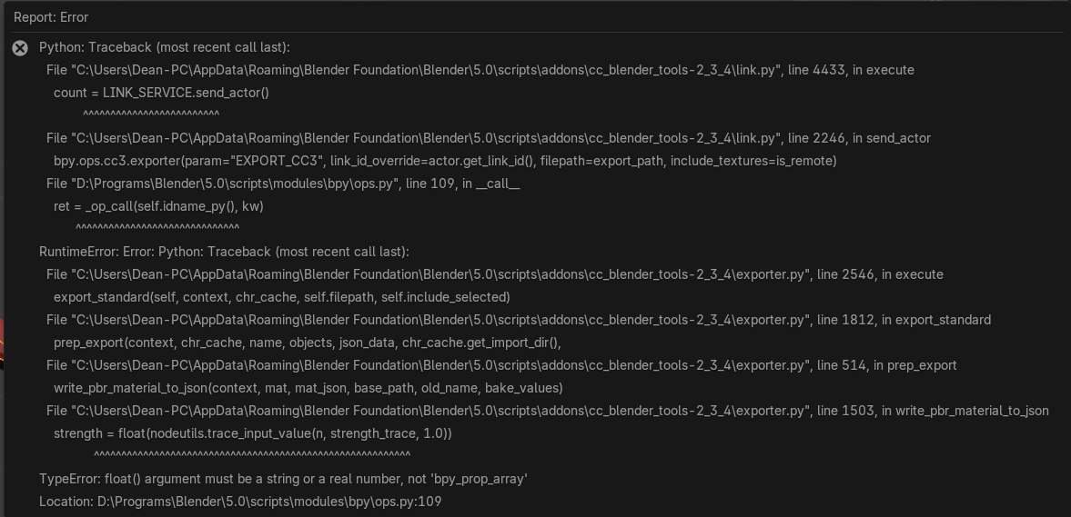

i tried the github links wasnt working, so uninstalled and tried the RL hub, and still nothing.
thought maybe it was a issue with my blender, so updated it to 5.0.1 still not working :(.
its weird if create a new character seems to be working alright but existing characters aren’t

seems to be working now with version 2.4.0 <3 thanks for fixing it @Victor.Soupday
