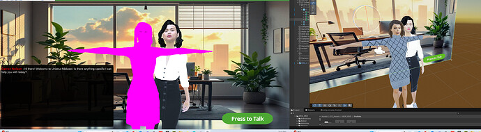

On the Right is the UNITY 6.0 Editor view and on the Left is the WEBGL Build from the Editor. Is there a setting I am missing? I cannot seem to find one. Thanks for any help with this. NOTE: FIXED: I had to change all the Shaders to Universal RP /Lit from the Reallusion Shaders. The Reallusion shaders seem to look a bit nicer but are rendered out pink for WebGL.
