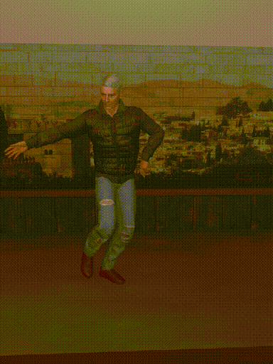

I did one test with Video Mocap. I can’t dance flamenco (or at all), so I created a short AI video for that and applied that with Video Mocap.
Jack_flamenco (1)
The hands needed editing but overall it worked pretty well.
Oddly enough, it appears that capturing motions like dance, skating, or martial arts gives good results with Video Mocap.
