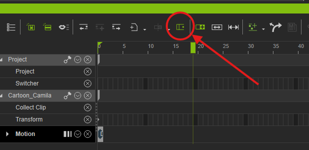

Would you mind checking if the “Auto Extend” option in the timeline was enabled before adding new poses with AccuPose? Once it’s enabled, you should be able to proceed smoothly.
