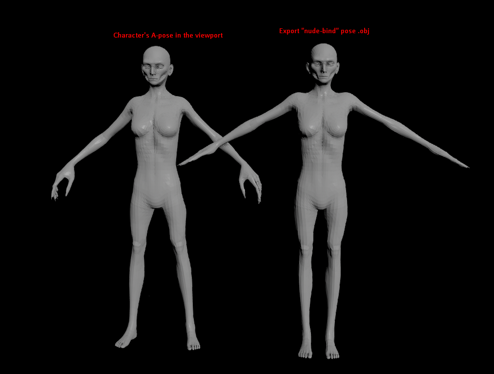

Why are the A-poses different between .obj nude-bind export and the viewport pose?
When I export the character .obj as “nude-bind” pose (for Marvelous Designer clothes making), then I get a nice even A-pose. However, the A-pose in the viewport of the Character Creator is this stranger, half-bent arms one, so the clothes don’t fit. What am I doing wrong?

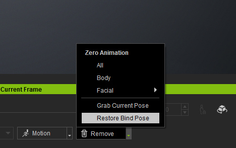

It’s in “Remove > Restore Bind Pose”
Untitled-1
That’s it, thanks much bro
