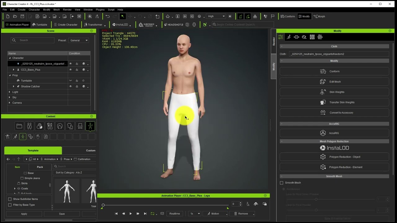

I’ve been using the lateral partitioning, but I must be doing something wrong. I carefully selected the left side vertices and pressed left, then the same for the right, but the result is the same. I’ll try to make a video to show :slight_smile: and I’ll check out the stylings! Thanks!
Here’s a quick video showing the issues I’m having. I went through it with the base neutral character to make it easier to see :slight_smile:
The bones you have to workout for smoothing there are Pelvis, L_Thigh_Twist01, R_Thigh_Twist01
Just to clarify. Pants should be simulated on a character with legs slightly apart.

Yours is a lot easier as they are tight and mesh is not dense.
So fitting them in CC would be just fine.
Quick fit:
