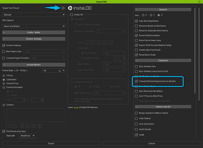

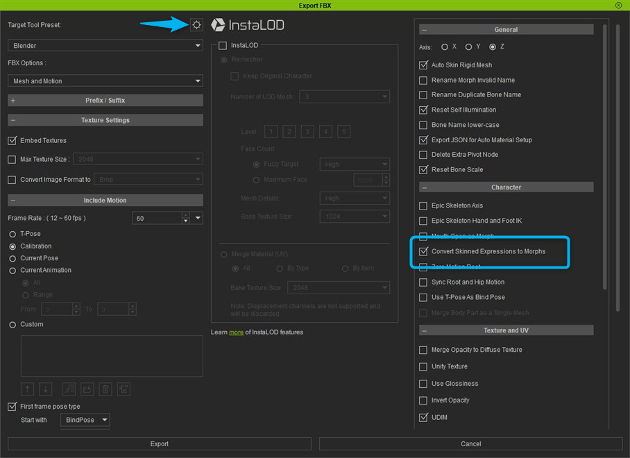

BTW, Reallusion support responded to this issue with the following:
The jaw, eyes, and tongue are controlled by bone rotation. If you need them to be mesh morphs, then check the “Convert Skinned Expressions to Morphs” box in the export settings.
While this may be helpful when using FBX for export, it does not solve the issue when using the Blender Pipeline Plugin.

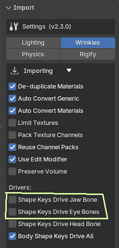

I think I know whats going wrong there: you might want to disable the shape keys drive jaw bones (and maybe the eye bones too)
If you expand the importing foldout you can disable it there. You’ll need to do this before importing a character.
@Victor.Soupday Thanks for the quick reply. I took your advice and updated the import settings. Though it seems counterintuitive to remove the Shape Key Jaw Bone and Eye Bones drivers.

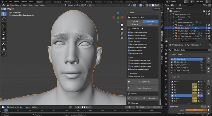

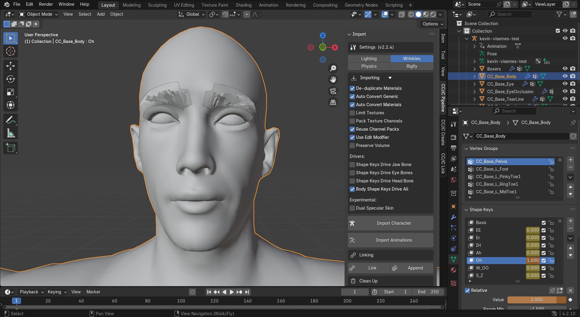

The result did not resolve the issue as displayed in the screenshot I have provided below. I have set the Oh shape key to 1. As you can see, the result is a puckered lip without jaw opening. I am using the Character Creator CC4 standard model named Kevin with extended 140+ expressions blendshapes and 1:1 Visemes mapping. My current version of Blender is 4.2.10 LTS. The results are the same with Blender 4.3 as well.
I’ve tried each possible variation of importing with the Drivers options. They all produce similar results. None allow for complete control of the Jaw. The closest acceptable result is including Shape Keys Driver Jaw Bone and Shape Keys Drive Eye Bones during import. With these settings, both Ah and Oh successfully open the jaw; however, none of the other shape keys have such success.
It’s a pretty odd issue to say the least. Any support and/or suggestions would be greatly appreciated.

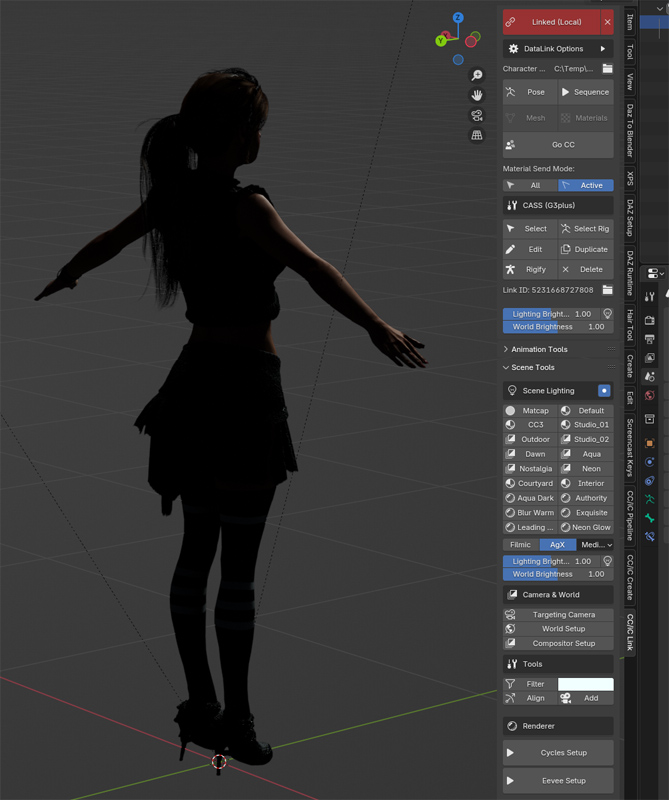

Sorry for off-top, can you also change the default light scheme to “Default” in the next release.
Current one after pipeline is way too cinematic. I keep switching after every import…
