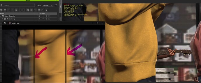

Vertical lines in render?
What could be causing these vertical lines that only show up in the render (I have the render overlaying the same frame in iClone)? The render is blurry due to Motion Blur. They only occur when the character with the yellow shirt walks by.
Any ideas or suggestions?

The outfit is part of the ActorCore character, “Business-F-0020” from the Urban Crowd bundle (I changed outfit colors using the provided MaterialPlus files). I also see these lines on another ActorCore character in the same scene, “Party-F-0009” from the Crowd Set bundle. The lines only seem to appear when the character passes the camera at a certain angle (directly from the side), and only when rendered. It doesn’t seem related to clipping planes, as the 2 characters pass the camera at different distances. Thanks.
Seems to be an artifact of Motion Blur. Rendering a still image on that frame does not show the lines, so I disabled Motion Blur and rendered the video and the lines are gone. So maybe you need to look at how Motion Blur handles the render when objects are close to the camera.

Since the file size is large (>500MB) I have sent the project using WeTransfer. I think you typed your email address incorrectly above (reallusion is spelled wrong) so I corrected it when I sent
