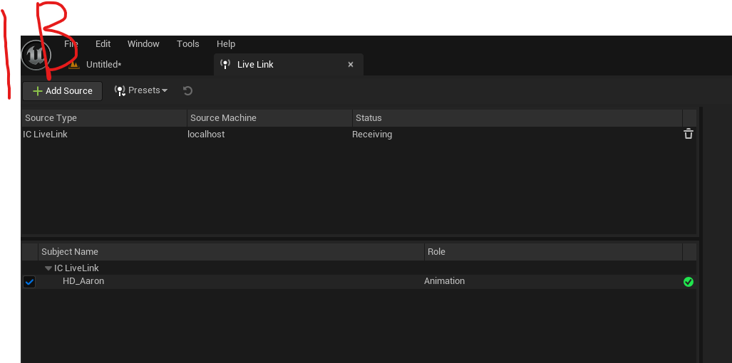

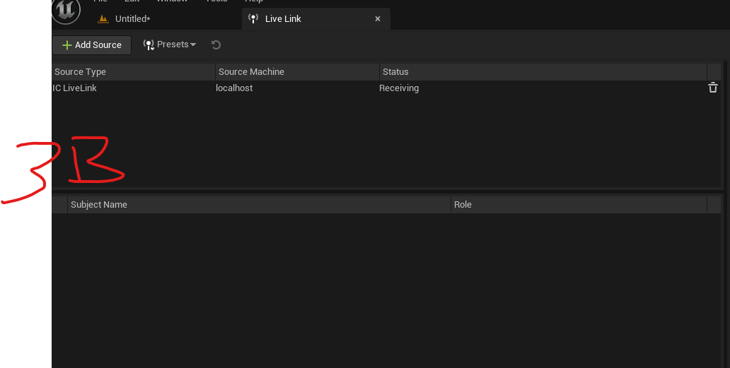

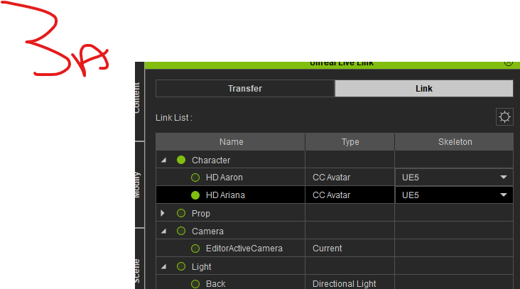

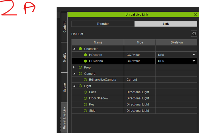

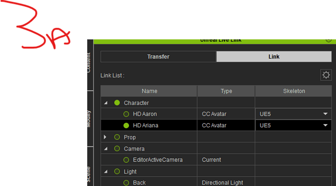

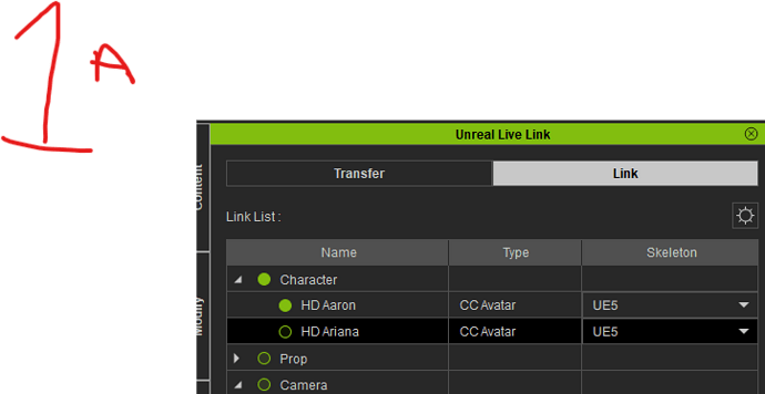

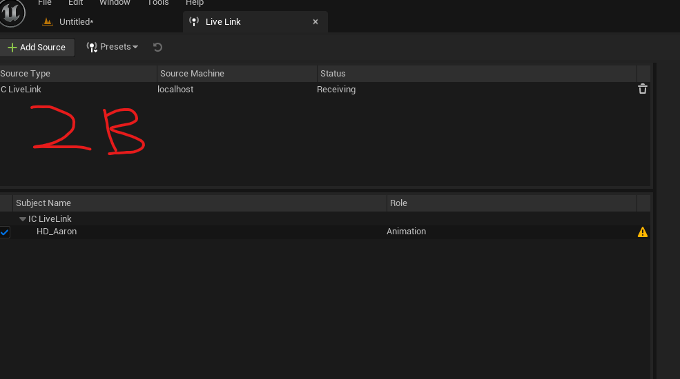

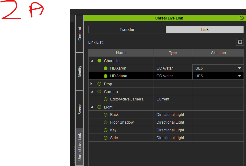

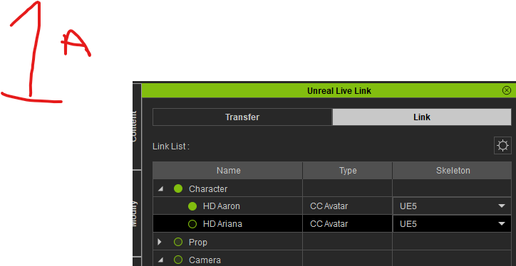

Hi i am have a fairly big problem for my workflow with unreal live link.
In the example in the images you will see that the Aaron model is linking and is fine.
How ever the Ariana model is not linking. In fact if i link her the link to Aaron breaks.
Now i have found this to be the case with my own custom models. Quite often it is the female models that break live link and the males work. i don’t know how or why. Names are correct on both sides, Iclone 8 and UE5.
Strange thing is it has all been working fine until 3 days ago or so. There was an update to iclone and all in one.
If i could get s solution to this it would be much appreciated. It has really messed my work up and i am now stuck in limbo till this is resolved.
In the images i have labeled them all 1a and 1 b and so on so you can see the effect activating each models live link is having.
I am using Ue5 6.1 but 7 is the same.

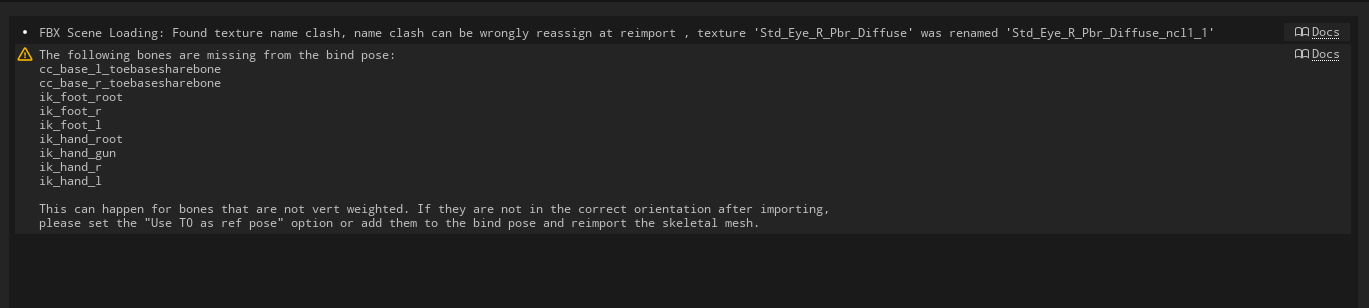

Here is the character transfer log
