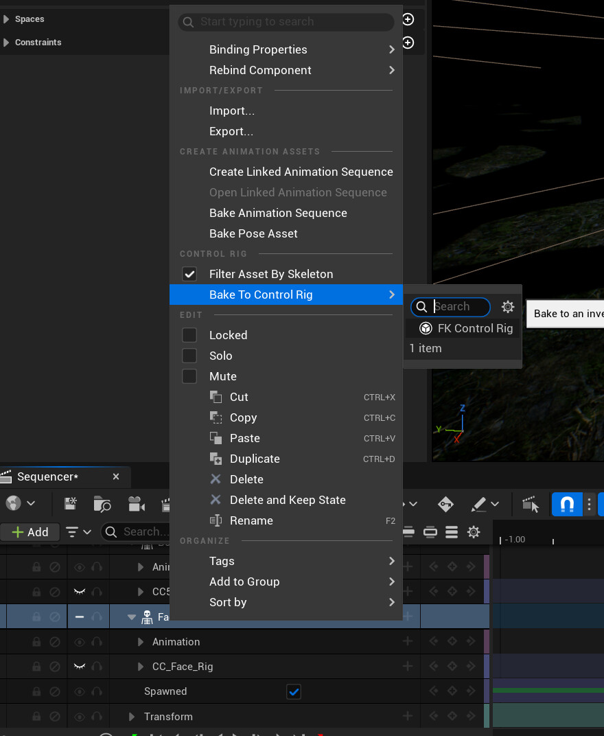

to bake facial rig animations from iClone 8.6.2 to UE 5.6, there is no option to bake to the CC_Face_Rig. The only skeleton available to bake to is ‘FK_Conrol_Rig’ - I’ve attached a screenshot of the only option available - mind you, I made my character spawnable in the sequencer:

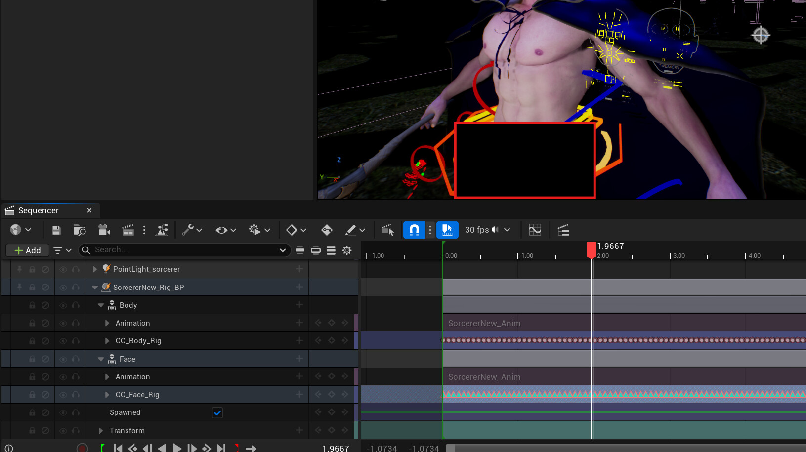

I unchecked “Filter Asset By Skeleton” which then allowed the selection of “CC_Face_Rig.” The bake window pops up, I click “Reset to Default,” then clicked create. The keyframes were created in the CC_Face_Rig line, but now, the character no longer animates at all, neither face or body. The original ‘Animation’ tracks are not active, while they CC_Body_Rig and CC_Face_Rig tracks are active and have keyframes.
Ok - this feature DOES NOT work with spawned characters. It will break the animation and you will have to remove the character from the sequence and re-add them.
