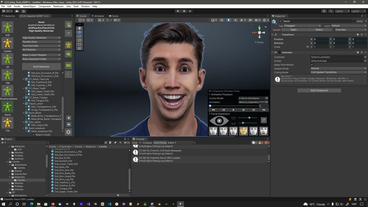

Every animation I attempt to use exported CC characters to Unity do not seem to target correctly. I am exporting without motion for Unity from CC4. I am using the updated CC Importer for Unity and I have forced a T-Pose. I am unable to copy the Avatar Definition from the Reallusion character’s avatar because I it always results in the error below. This is a consistent problem with every animation I’ve tried from several different publishers.
Every character asset I’ve purchased from the Unity Asset Store works just fine. When comparing the bones, the CC character hip bones do not match any other avatar’s hip bones.
Help correcting this would be greatly appreciated!!

Apologies for the necro, the animation tool does help, so thank you for the tip!
That said - avatar data is not successfully transferring to imported Character Creator characters. I have not run into this issue with other models.
If you look at the original screenshot I posted, the CC_Base_Pelvis is an invalid bone in the CC4 avatar after importing into Unity. That is the same bone other mecanim humanoid. Every example of a humanoid in Unity makes that one solid T-Bone and is applied as Hips in the mapping. CC4 avatar has them separated and only uses the Stem of the T as the hip.
Is there any way to address this bone to conform to a typical humanoid character for Unity when exporting from CC4?
Example below of a typical humanoid.
