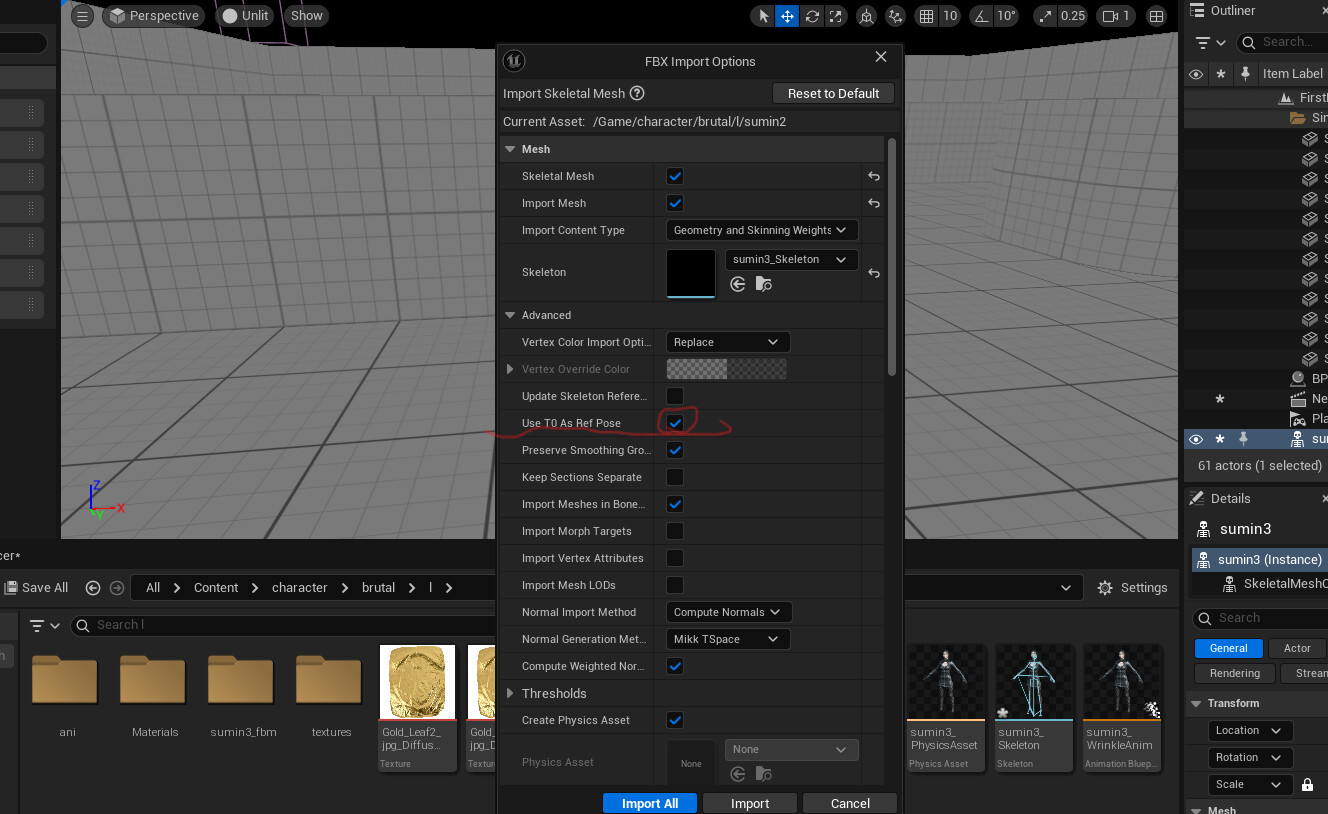

Creating a Control Rig from a “Made Game Ready” Character is not possible at all, and plain exported characters with the Unreal Preset from CC4 messes up all the bones too. Seems to work in UE5.5.
check to reference pose
