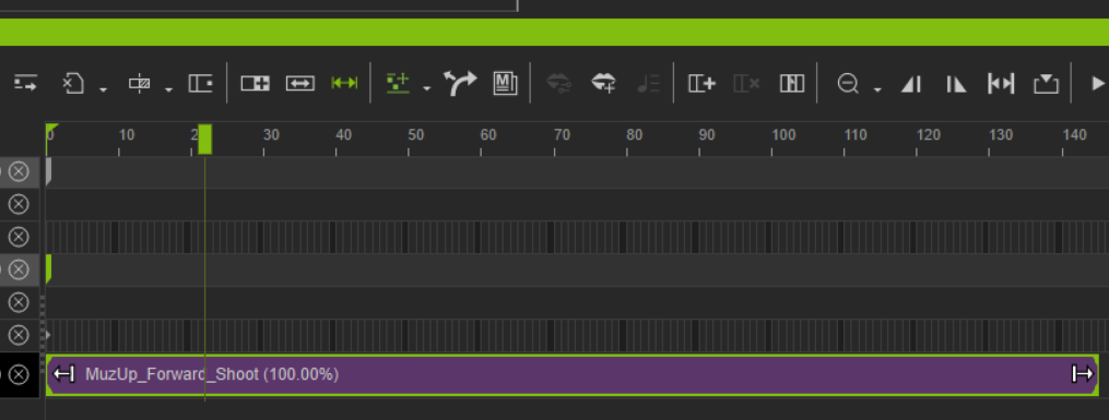

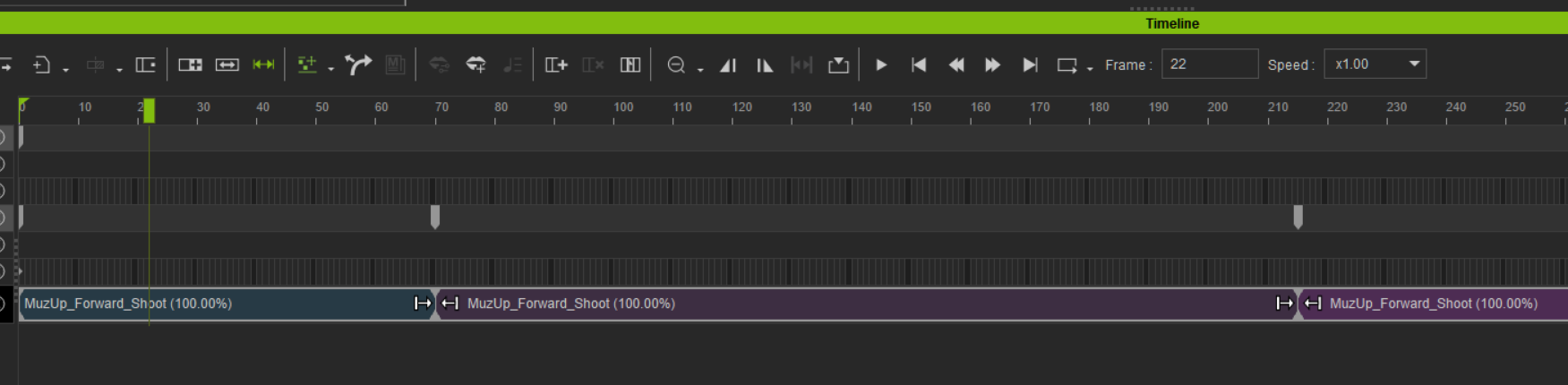

You can do that already. In the time line make a cut (Non-destructive Break) into the clip to mark the beginning and another cut to mark the end.
You can now the delete the portions you don’t want and move the clip to a new position:

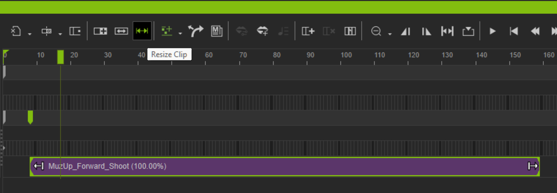

Because the breaks are non-destructive, you can make adjustments afterwards with the Resize Clip option as I do here for the beginning:
