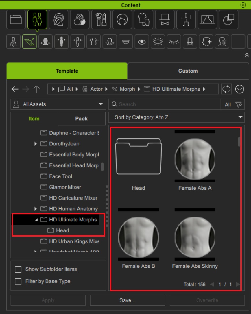

I’m just beginning, maybe i’m doing something wrong, but does the current Trial version of “HD Ultimate Morphs” intentionally include only 10 Full Body presets and exclude the 152 HD Body Morphs and 20 HD Facial Morphs?
If not, how to install it to have all the sliders, instead of just 7 full morphs Female Atheletic, Female, Male Bodubilder etc?
Or maybe i don’t see the sliders despite them being somewhere else?
I tried Help → Refresh Sliders.
Hi…
If you have installed the HD Ultimate Morphs pack then you should find the contents of the pack in Content Manager under Actor > Morphs. There you should see a folder called HD Ultimate Morphs and a sub-folder called Heads (see below).
Do you have this folder in your Content manager?
