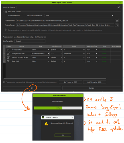

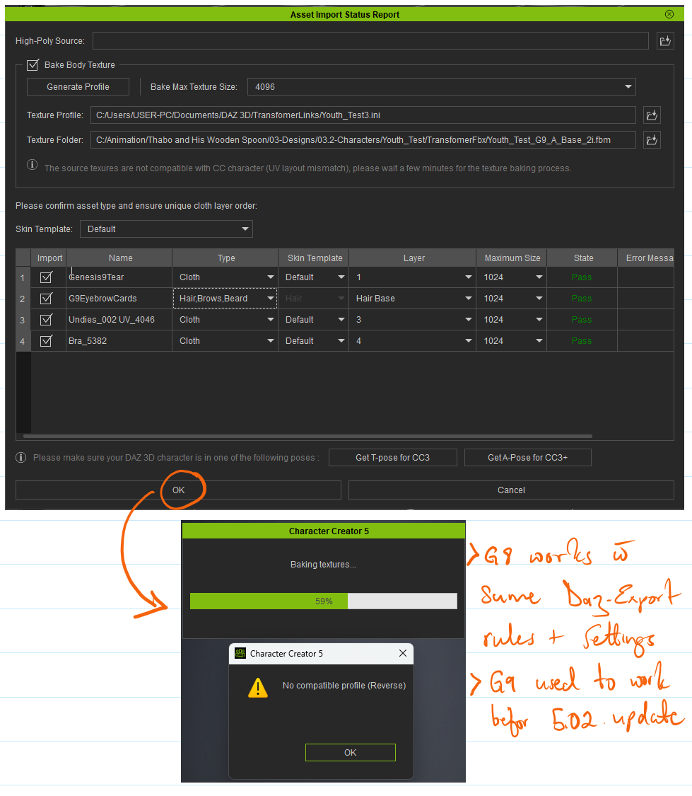

Anyone else experiencing Transformer error during body texture baking for Daz G9 in CC5.02.
Please assist if you have a workaround.

@Pete_RL I am currently experiencing the issue of gen9 textures not baking when importing through Transformer. The characters comes in without textures. I am using the latest version of CC5. I have uninstall and reinstall, however the problem persist. Please I need assistance.

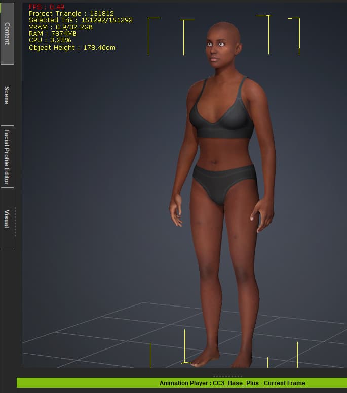

Not to take away from your question,
On my end I am on CC 5.06.1410.1
and as you can see I am able to bake just fine.
whilst awaiting @Pete_RL feedback, maybe beneficial to check your export process from Daz.
I haven’t had your specific issue to share a possible workaround or solution.

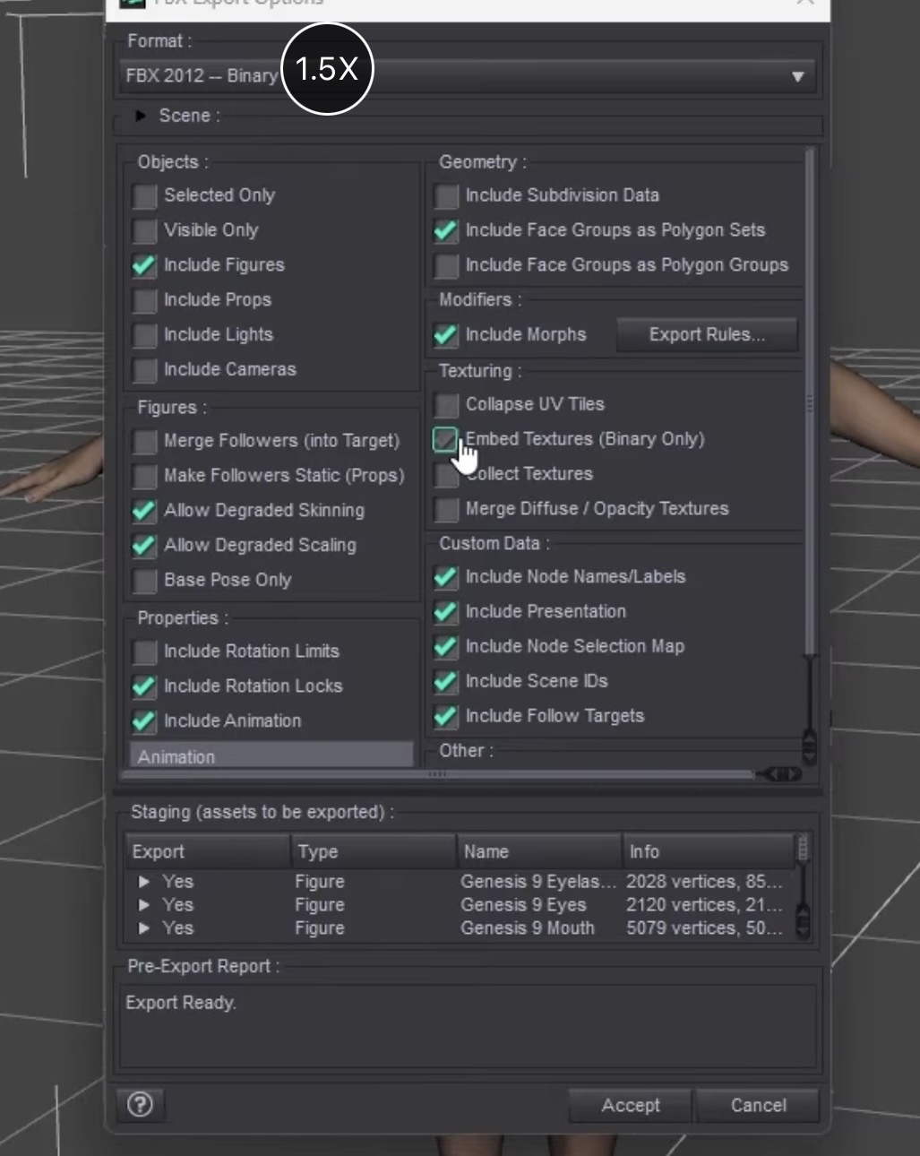

Unfortunately for me, it is having issues. My gen 8 characters come in well textured. It is just gen 9 characters. I believe my export settings are okay. If I just drag them in as fix they come in fully textured. The problem happens when I bring them in through transformer. I am not sure what to do. Attached are my export settings.

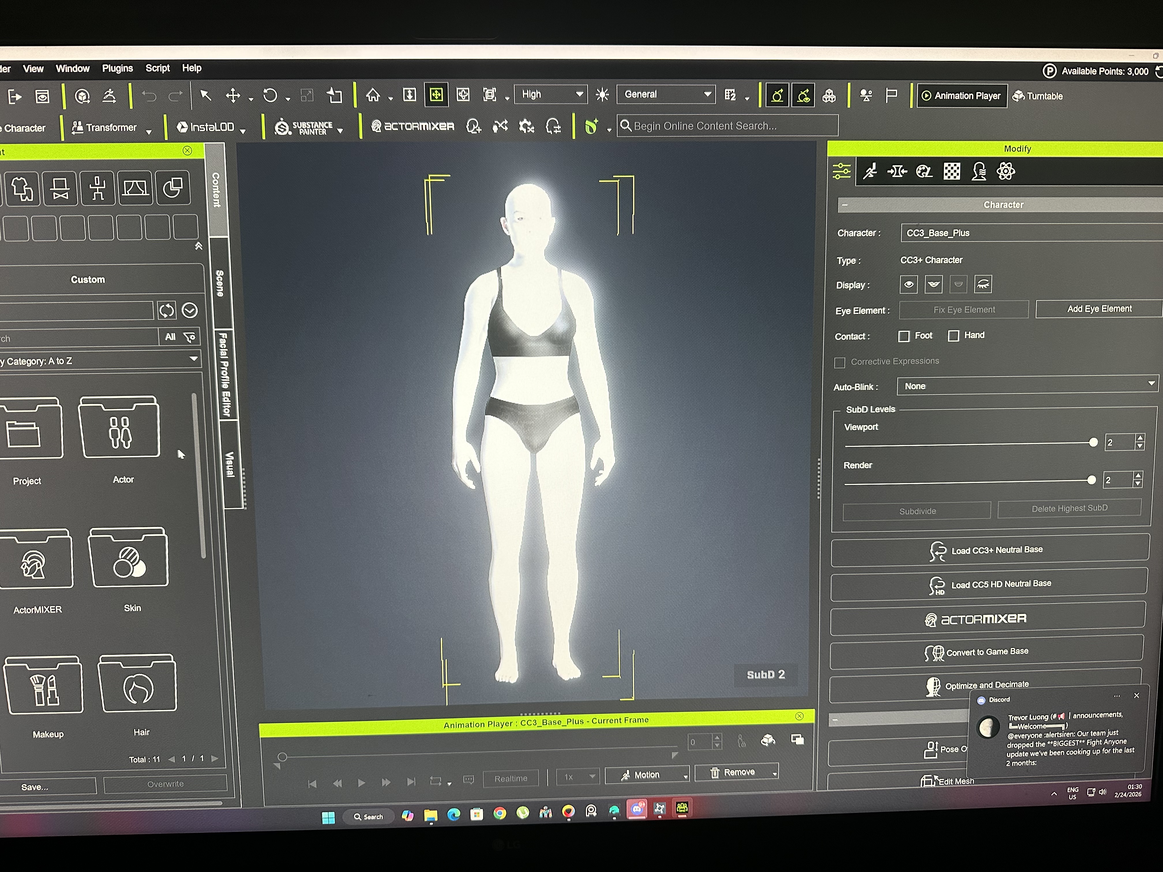

Can confirm the same problem is happening on my system newly installed yesterday. The same happens when using transform and making a cc3 or cc5 character - clothing textures seem to be brought over NOT genesis body maps.
Ive just found out that if you go into skin tools and goto cc5 maps you can at least add some for your figure there. not much use if you want the specific daz maps. but i intend to change the skin upon import into blender anyhow.
