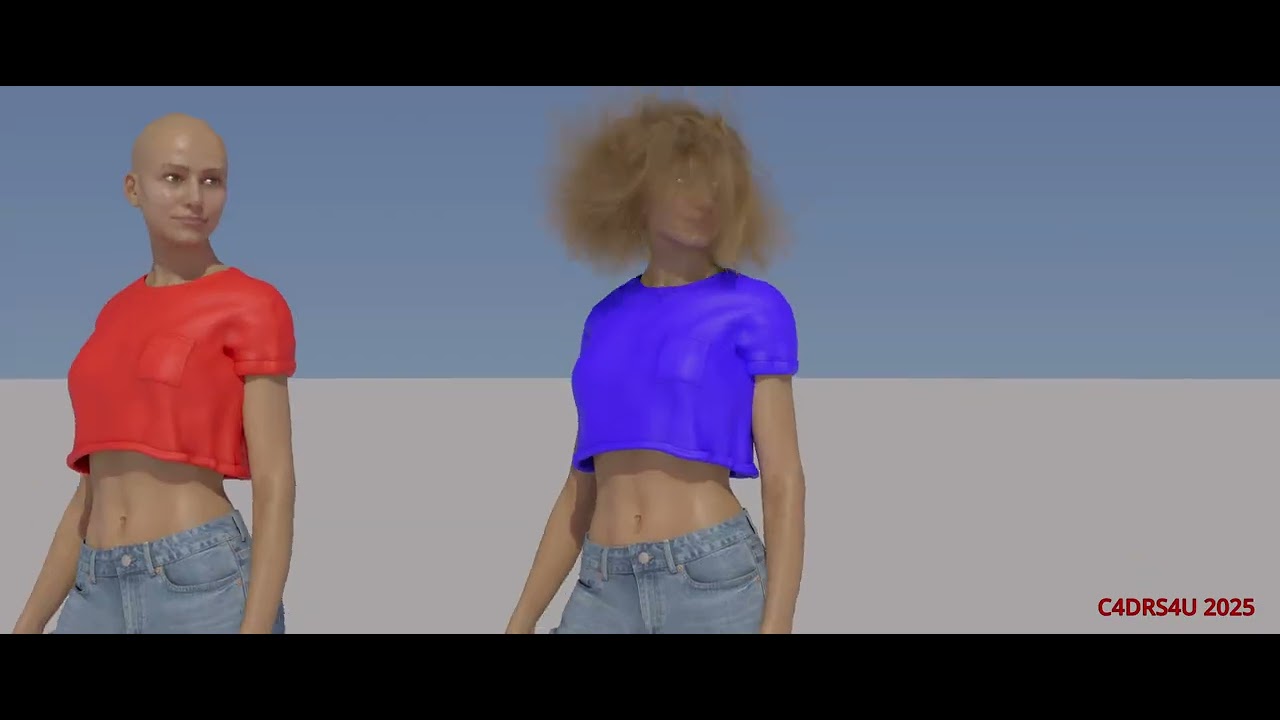

Well, since I’ll be facing the same problem in the not to distant future, I decided to give this a try.
This video shows two copies of Camila with identical animation and C4D hair grown on a “scalp piece” (extremely simply, messy hairdo). This is then transferred from the Camila with the red shirt to the one in the blue shirt (no cuts or edits, one continuous shot). It is clearly visible that the hair reacts to being “transported”.
If this works, I don’t really see why putting the same hair on a character in a new outfit shouldn’t.
That does look cool. And how did you do it? Did you simply assign the hair to the new head in the hierarchy?
I used a separate scalp piece (copied from the head mesh of one of the Camilas) and grew the hair on that. Since it is independent of a specific character, you can putting it pretty much anyway. So I then parented it first to the left and later to the right character (to the head bone/joint in each) with a Constraint Tag and animated the level of influence to make it move between characters.
The scalp piece does not render (is set to be invisible to the camera), only the hair is rendered so the character needs to have a complete head mesh. The character’s head/body also needs to have a Hair Collider tag, but that would also be the case if you grew the hair directly on the character’s mesh (which I would not recommend for what you want to do).
Pretty easy, really. It only took a few minutes to set up but a lot longer to render this clip (4 hours for the render plus set-up time, hair does take its time).
