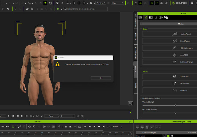

HI
I see people have posted similar to this but i haven’t seen a solution.
I have upgraded the eyes, teeth, lashes. i have refreshed the content browser.
Yet i still get the error - There is no matching profile for the target character cc5 HD
HI
Hi… Please try the following:
Open iClone 8 and go to the Content Manager. Click the “Refresh” button to check for updates. Now check for updates to the “Characters” pack or any CC5-related content. Update them if available. Note: Do the same in CC5.
If the character has been modified, please make sure the character uses stock HD parts like eyes (included with CC5 HD packs). using non HD parts can cause profile problems.
Finally, make sure both CC5 and iClone are updated to the latest versions (check Reallusion Hub to ensure you are up to date.
Thank you, i found 1 pack i missed in the update on cc5. Cheers!
