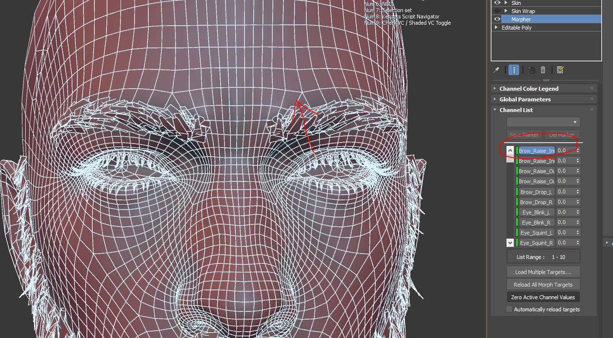

1 . In 3ds Max, the morph targets are set up like this.

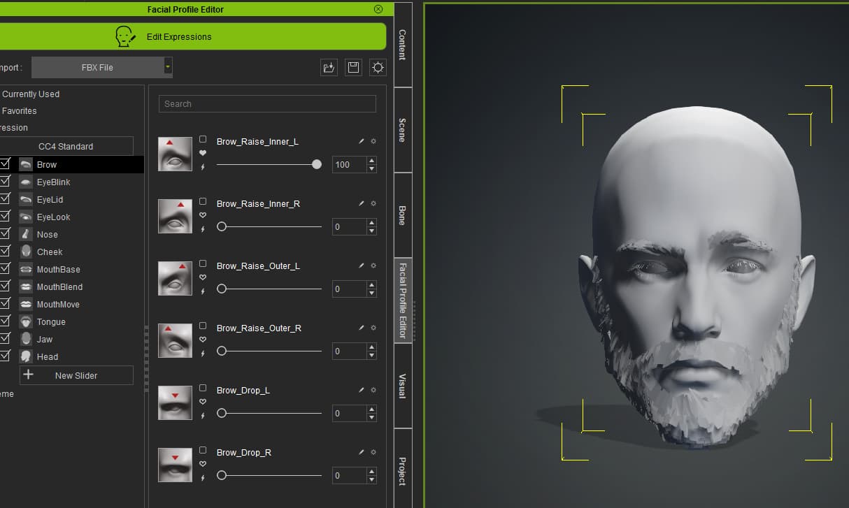

  1. In CC, the names of the expressions, such as Brow, Brow_Raise_Inner_L, all match exactly, and the index order is also consistent .

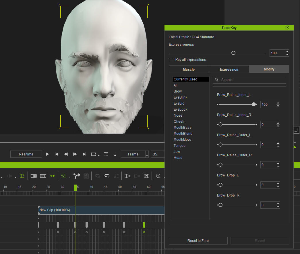

  1. After importing into iClone, I added animations to each Brow_Raise_Inner_L and R for testing purposes

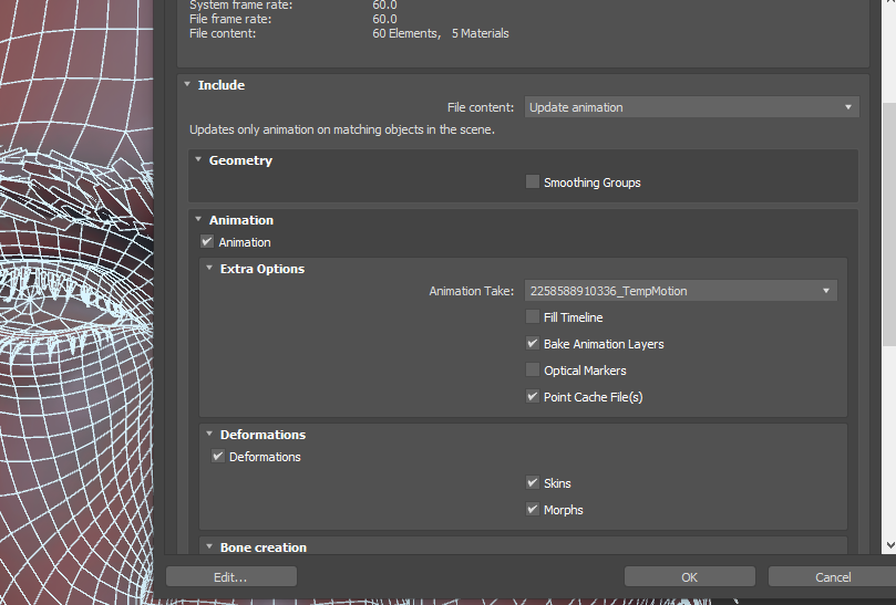

4.Then I exported it as an FBX using Export → 3ds Max, and attempted to import it into Max.

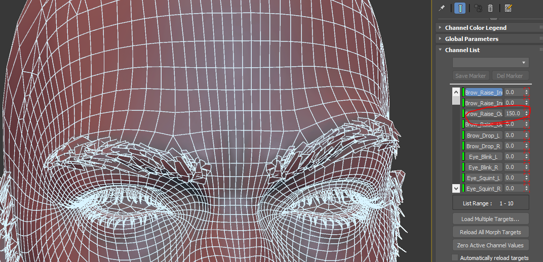

  1. Now, when I check the animation, the parameters are applied to morph indices other than Brow_Raise_Inner_L and R.
