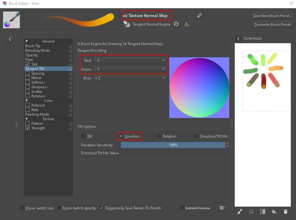

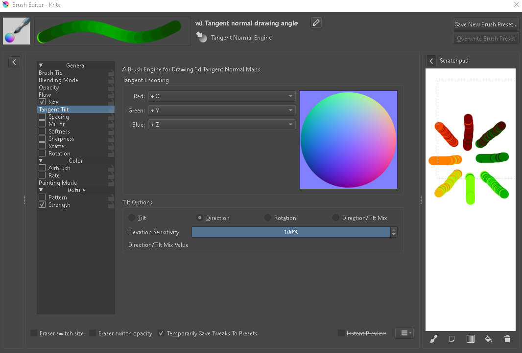

I found a very interesting free application - Krita (Krita | Digital Painting. Creative Freedom.), which allows you to draw Tangent maps. But the default Tangent encoding settings seem to be incompatible with CC.
See pic. :
Maybe someone knows what Tangent encoding settings should be used to create Tangent and/or Flow maps compatible with CC?

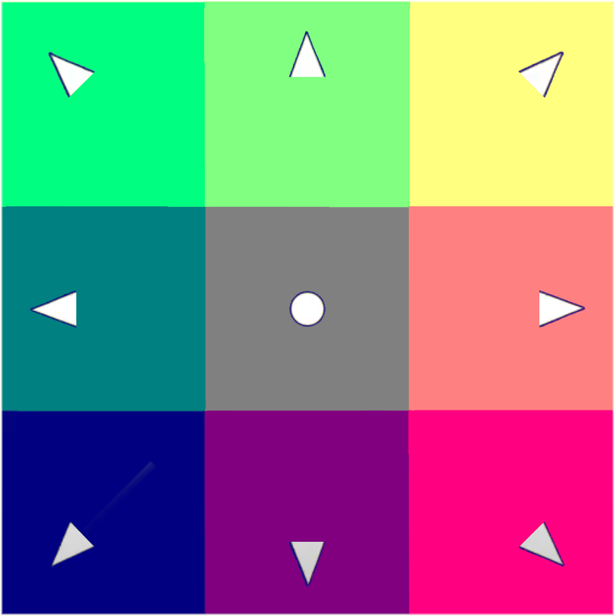

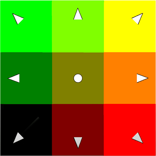

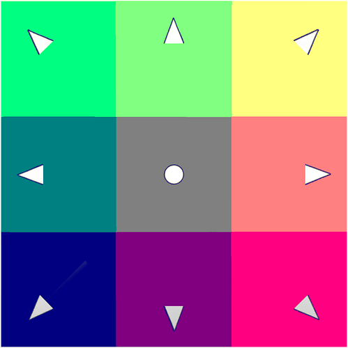

I found how the standard Tangent map is constructed for DirectX, but it does not look like the Flow map for CC.
Analyzing the Flow map in CC I came to the conclusion that the direction scheme should look like this -
But I’m not completely sure.

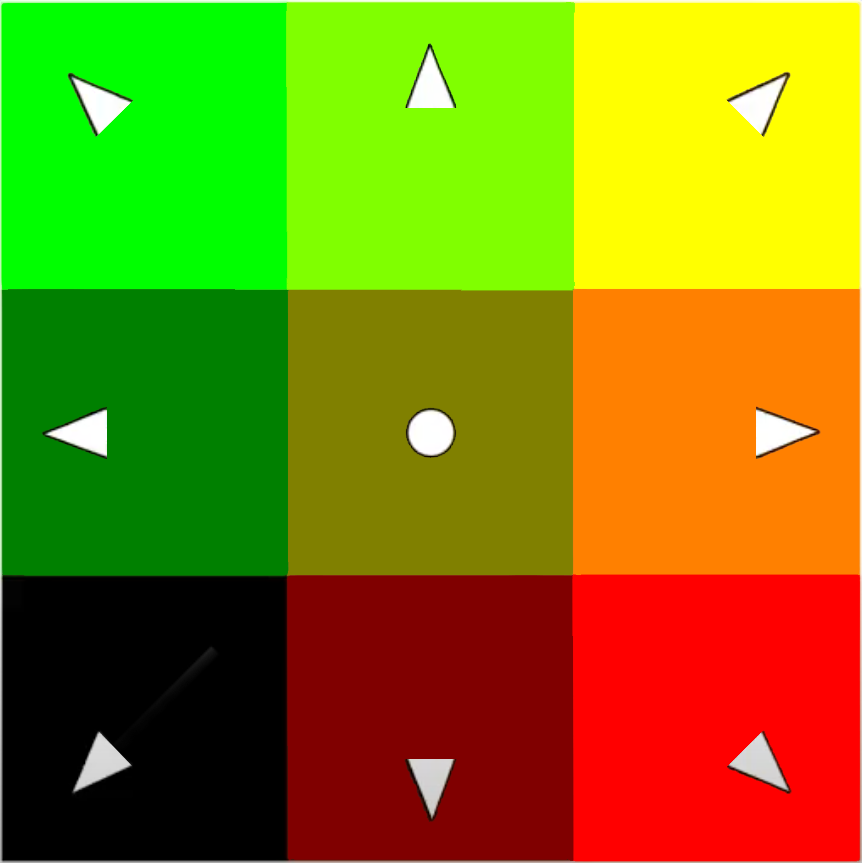

I think I managed to figure out how to create Flow textures for CC hair.
The closest result to CC requirements can be obtained using the Substance Painter program. You can read the instructions here.
It is important that you select DirrectX (not OpenGL) when creating a project.
Krita can also create Flow textures, but it has some issues in the left-bottom direction, so the textures are not as “clean” as in Substance Painter.
Here is a short instruction:
  • Edit the standard “Texture Normal Map” brush as shown in the image.
  • Draw and save the Flow texture.
  • Load the texture into an image editor that allows you to edit individual color channels (Photoshop e.t.c) and fill the blue channel with 50% gray.
    Perhaps the last step can be done directly in Krita, but I did not figure it out.
