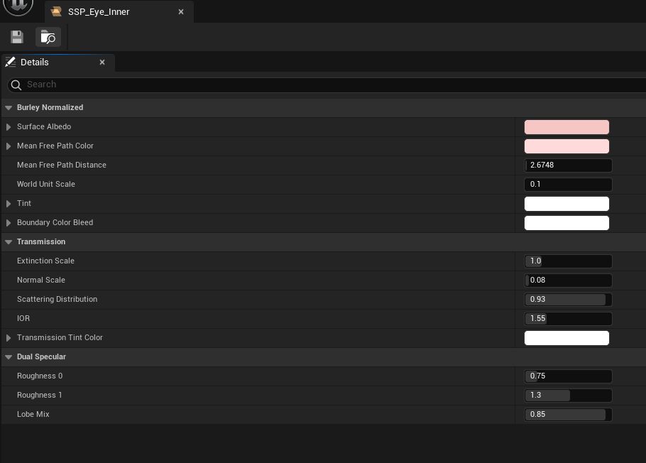

I understand that this error might be quite rare and that few people have encountered it. However, would anybody be kind enough to please share screenshots or properties of “SSP_Eye_Inner.uasset” so that I can reconstruct it myself from scratch?
Bump. Wondering if anybody could please share screenshots of the Details Tab for this file so I can recreate it in Unreal. Would really appreciate it!

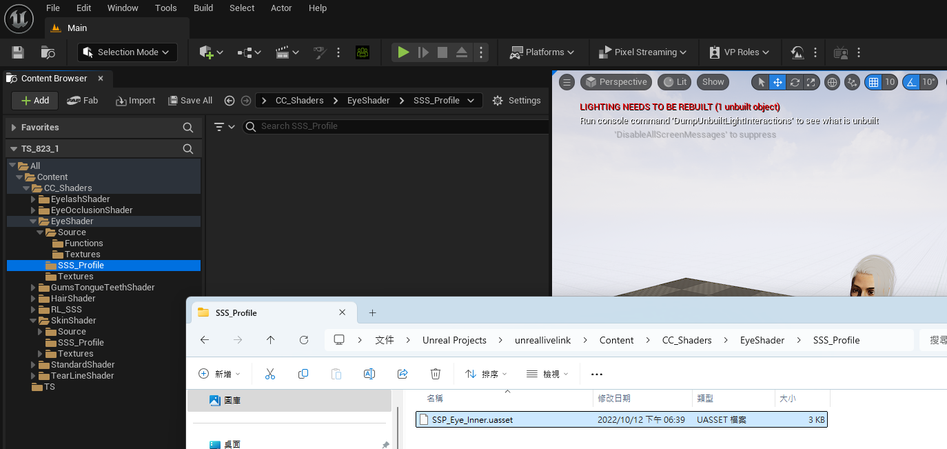

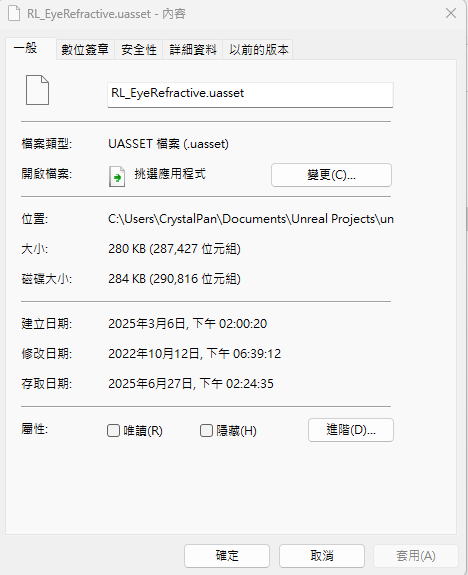

Do you mean like this? Sorry, my interface is in Chinese, but I should still be able to provide it for your reference.
Thank you so much for your response! I am actually talking about the settings window for the SSP_Eye_Inner.uasset. I re-created the file using an SSS Profile, but I don’t know what the actual settings should be. This file is located under Content/CC_Shaders/Eye_Shader/SSS_Profile

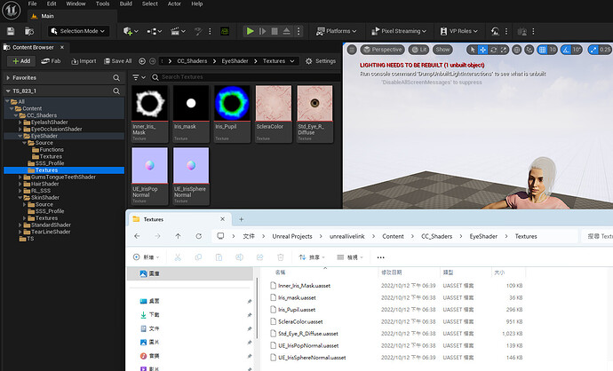

I understand your explanation. However, when I checked in Unreal, I found that the SSP_Eye_Inner.uasset does not seem to have a settings window for adjustments. I’ve provided my folder structure for your reference.
It looks like you have the same problem that I have. Your SSS file appears in Windows Explorer but is not recognized by Unreal Engine 5.
Have you ever generated a packaged build of your Unreal project and then checked if you don’t get an error regarding the eyes or if the eyes appear normal in the packaged build? In my case, the eyes were working fine in Editor during Play, but not in the packaged game. In fact, the game wouldn’t package because it would run into an error involving the SSS_Eye_Inner.uasset.
