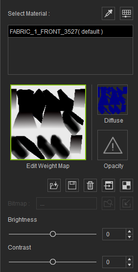

Yes please. And i am super frustrated. I been asking for years for someone to create a wudang robe with physics. I came close before but no one would help. I got frustrated abd learned marvelous designer. Spent a week making an awesome robe. I bring it in cc5, arranged collision shapes, made a physics map and applied all settings. The physics ignores the colliders in the legs completely. I cannot figure ot out. I used every shade of black and white, every setting, every collision shape. I am enraged… what am i doing wrong???

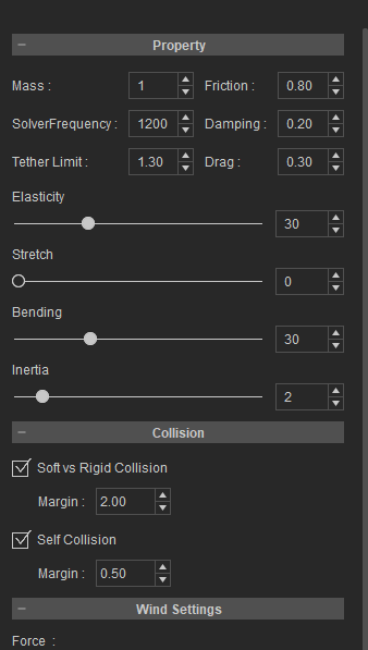

I looked at your cloth, copied the physics settings, tried to keep black areas to the minimum, and its acting crazy. Now it sticks to the legs and acts like there are no physics. Where the robe crosses is completely messed up. Its so frustrating
Try minimizing “friction” and “drag” and increasing “solvent frequency”. Also mesh quality is important. Should not be too dense or too low poly.
Regarding collision. At rest pose (T-pose or A-pose), which should be at the first frame of simulation and run at least for a second, cloth mesh should be above any collision shape. Otherwise, mesh would go inside the collision shape and be dragged along. Animation should be not be overly extreme and fast.

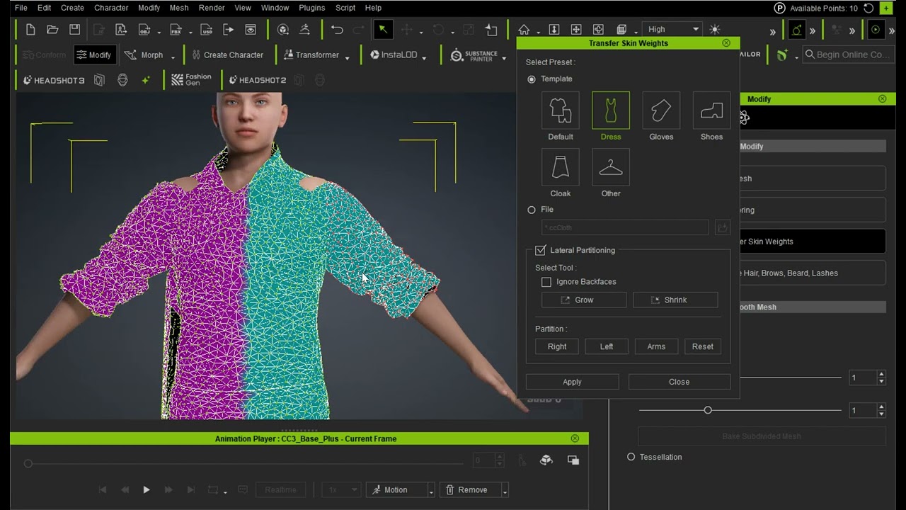

So I did take a look at your robe. You’re really almost there. UV and weight map are fine. It looks like it just needs a redo work to get it looking nice. The best way to do that is just revert the robe to it’s original shape by converting to an accessory, then transferring the skin weights again. Make sure to use the “Dress” preset. In the lateral partitioning section, set the arms so they do not cross weight to the torso at all. See my video.
Manual page for setting the arm layer to avoid cross-weighting:
https://manual.reallusion.com/Character-Creator-5/Content/ENU/5.0/08-Creating-Custom-Assets/Arms-Layer-for-Transferring-Skin-Weight.htm
