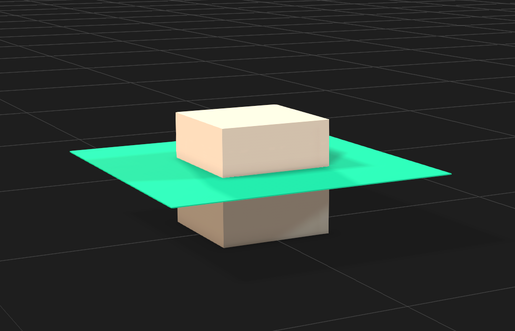

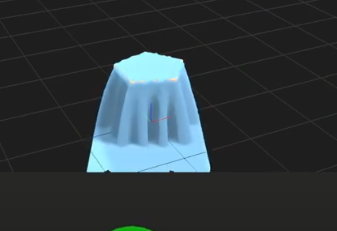

Why does a plane like in this video does work with soft cloth and not a flattened box or a simple plane from Iclone . “Plane_Retangle.iprop” does NOT work while “Plane_001.iprop” DOES Work ?
Plane prop created with blender
Clipboard_04-04-2025_04
Flattened Box from Iclone Prop
For cloth deformation surface needs to have a geometry - enough polygons to bend along edges. Mentioned props do not practically have it. Plane_Retangle.iprop only has one face and box one face on each side. Enable Wireframe view to verify geometry before enabling Soft Cloth physics.

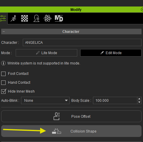

Now i have another little problem, i wanted to cover a nude person with a sheet, but it seems Cc3+ chars cant be used for rigid body, would i need to convert it into a prop ?
Same as with dresses and coats, you have to enable and position Collision Shapes on a character.
