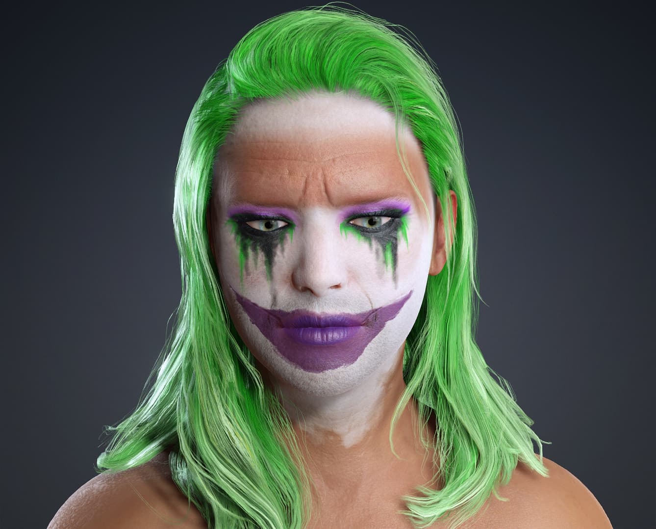

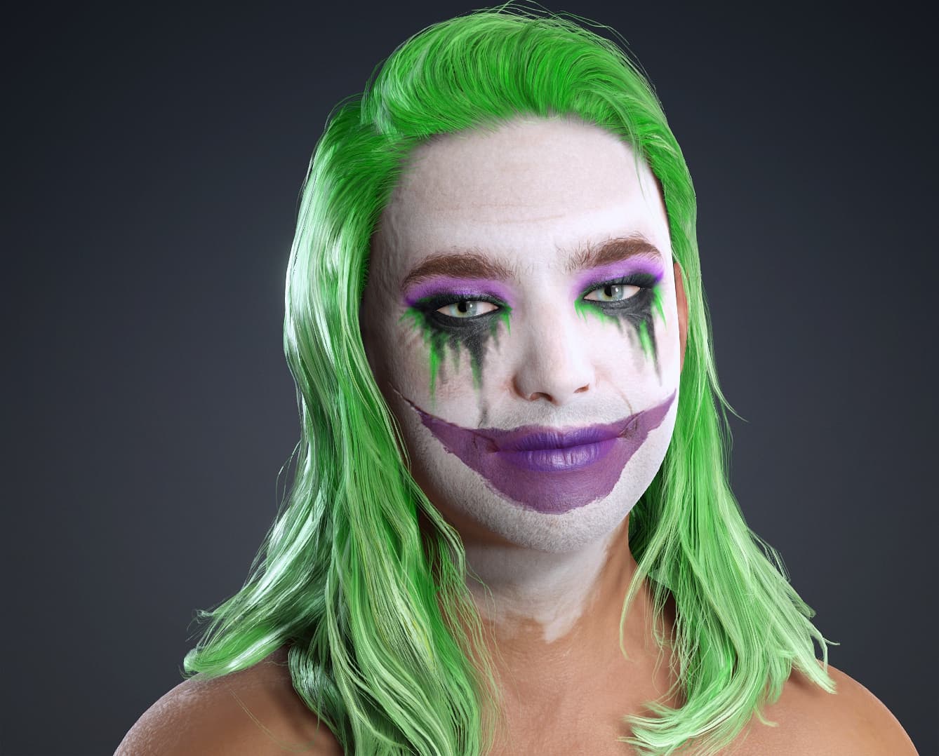

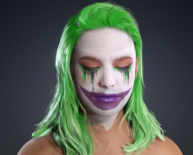

I have used Skin Gen to add makeup to a CC5 character. When I animate the face the skin breaks through the makeup when eyes are closed or when checks or forehead move. I am using the latest CC (5.01)
If you use a wrinkle set that includes a diffuse map, this can happen because it overrides the makeup. I’d recommend using a wrinkle set that doesn’t have a diffuse map. I actually explained this in my video as well ^^
