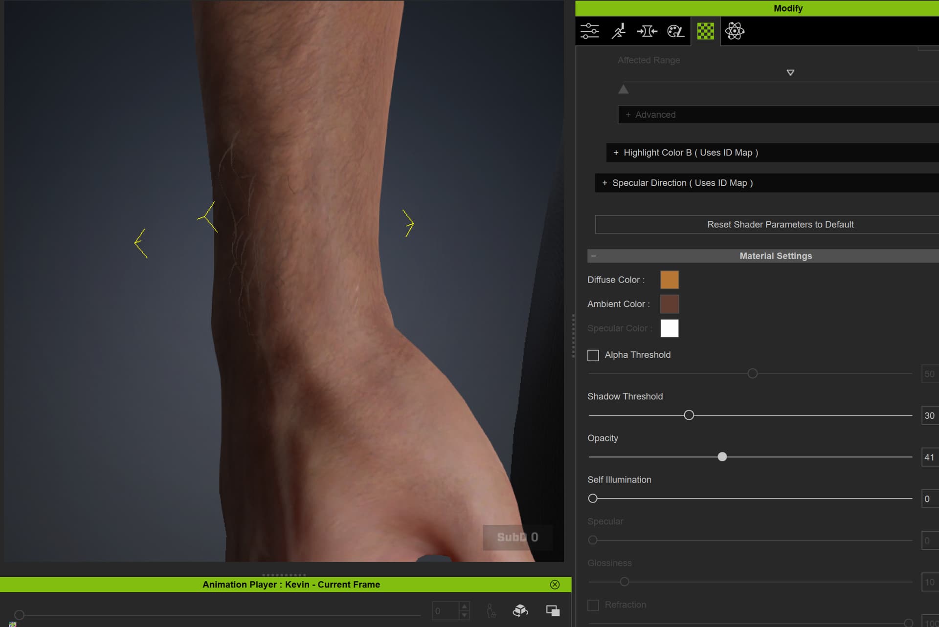

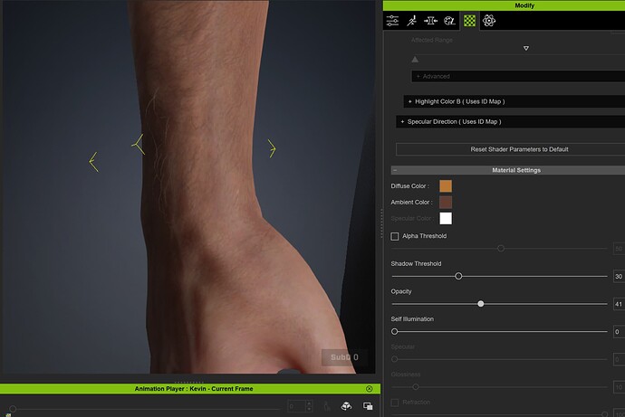

hank you for sharing this. I’ve been playing around with it and still have a lot to learn, but it’s already been really helpful and pretty quick to use. I did a few tests with hair first.

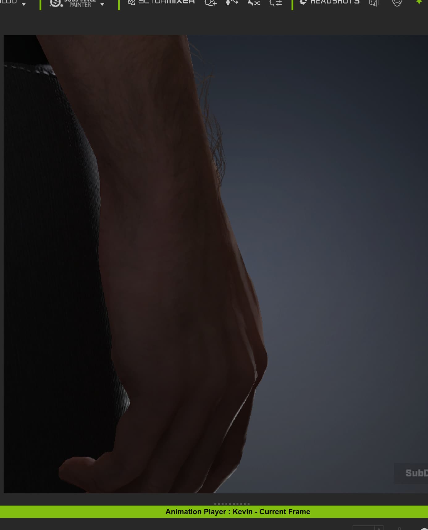

Then I wanted to try using it for body hair too, because painted-on arm hair, leg hair, chest hair etc. can look really flat from the side. I made a few strands and blended them into the existing hair texture on the arm. For now I kept them as an accessory instead of actual hair, lowered the opacity a bit, and it does give a more realistic look from the side because you can actually see some of the hairs sticking out.
I’m still experimenting with it, but it’s really useful so far.
