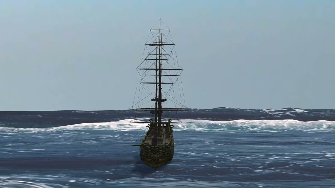

Hi everyone,
I’ve started a new project. I want a ship to move with the waves. The animation is created using a script that reads the height from the displacement map. This is a first test—the height is already being detected.
There’s more work to do; the ship also needs to rotate, and I’d like to read the Strength, Base, and Multiplier values for the displacement map. Right now, I’m setting them manually in the script.
Does anyone know how to access these values in the script?

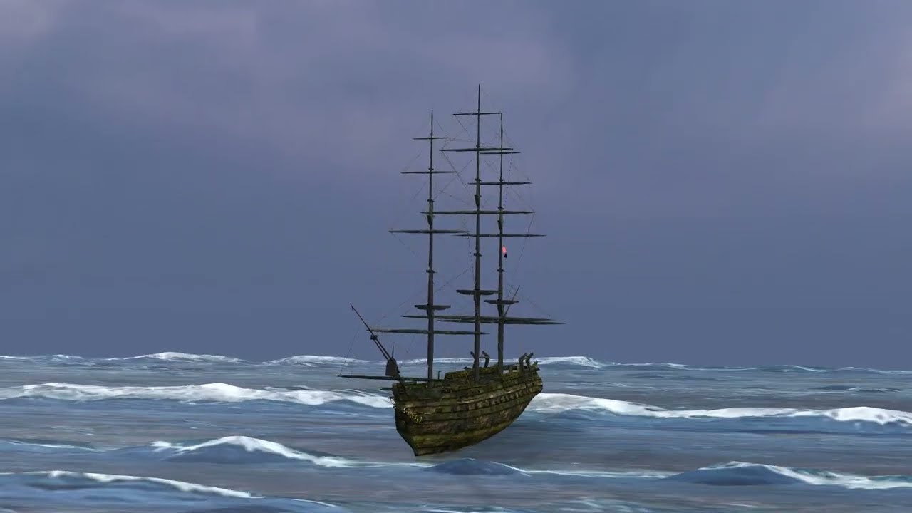

Here come test 2 with rotations of the ship. Well it isnt so easy, to find the right values. But it rotates already.
Have a good time

gordryd,
I fast have tryed it - and I like it. I have moved the box and also the ship, wich is the child of it. This dos really give a nice rolling with the waves. And the high, which I have calculated with my script, is holded.
Great work
Tesira

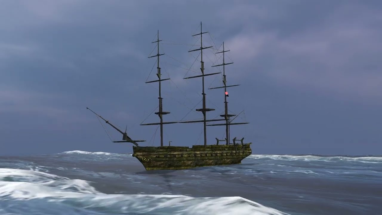

Hi gordryd,
I have learned from you, that it is better, to change the rotatione in intervalls, but not always, when I change the high. I have tryed with my script and it works much better now. Thanks, and your script is usefull for many things and it dos work well.
