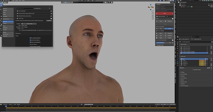

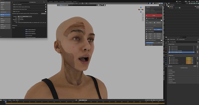

I’m using iClone and Character Creator, and I’m having an issue where the Camila model shows strange shading in Blender when I import it. You can clearly see it when you adjust the sliders for the facial expressions.
But: The same problem doesn’t occur with the Kevin model.

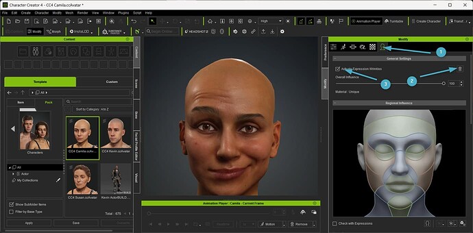

This happens if the wrinkle maps have been created for a different skin tone. So when you change the skin tone, delete and rebuild the wrinkle maps for the current skin tone.
  1. Select the Wrinkle tab in the Modify panel.
  2. Click the trash can button to remove the wrinkles. This will un-check the “Activate Expression Wrinkles” box.
  3. Check the “Activate Expression Wrinkles” box to create new matching wrinkle maps.
